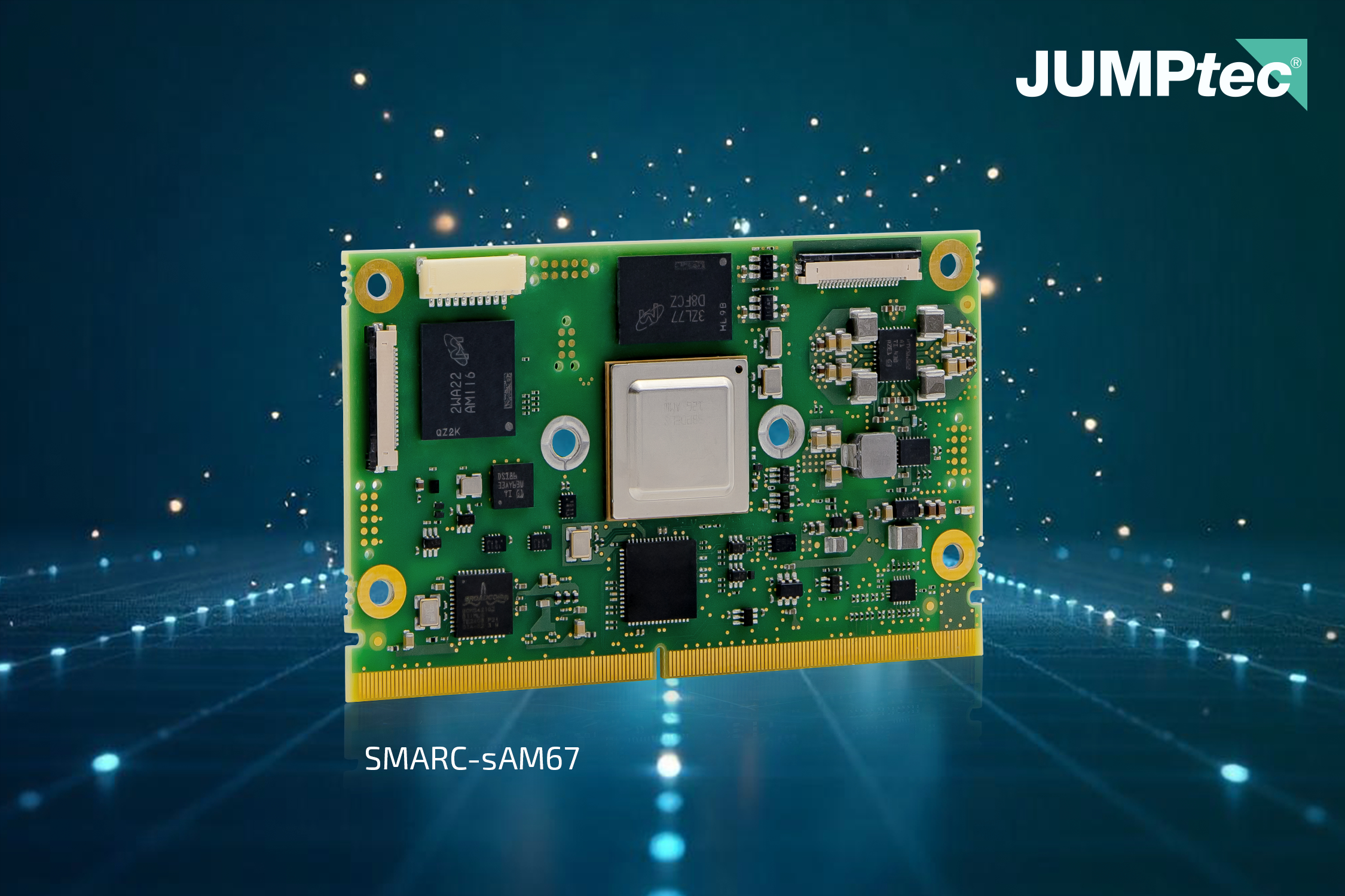

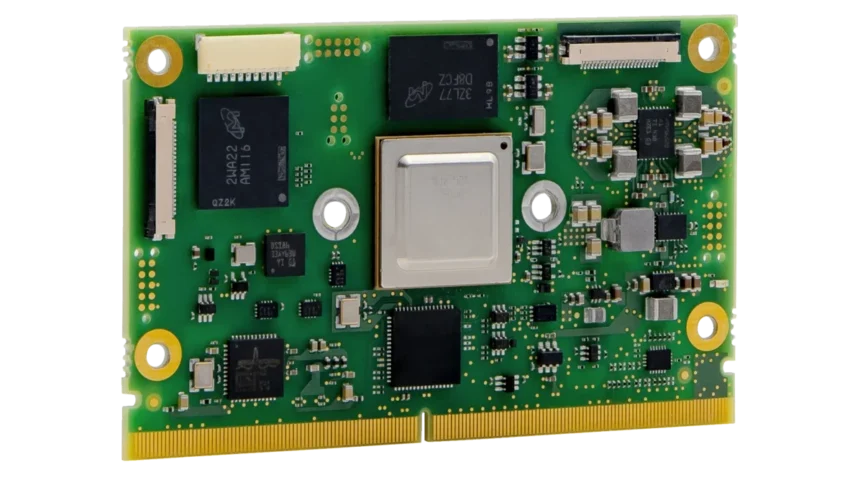

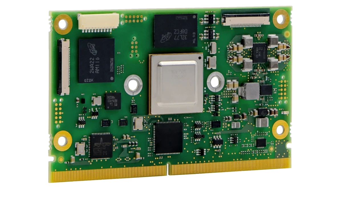

JUMPtec SMARC-sAM67 module an industrial SMARC SoM
