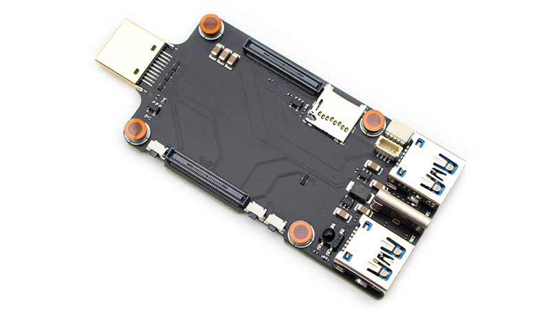

The Raspberry Pi TV Stick concept moves forward with the CM5 TV Stick Lite, a compact carrier board built for the Raspberry Pi Compute Module 5. It converts the CM5 into a plug-and-play HDMI device, removing the need for extra cables and bulky enclosures. You can connect it directly to a monitor or TV and power it using a single USB-C cable, which makes the setup clean and portable.
Unlike standard development boards, this Raspberry Pi TV Stick focuses on simplicity and real-world use. The HDMI Type-A plug sits directly on the PCB, so you don’t need an external HDMI cable. This design works well for media playback, retro gaming, and compact embedded display systems where space and cable management matter.
The board supports both Lite and eMMC variants of the CM5, giving flexibility for storage. Lite versions use a microSD card, while eMMC modules depend on onboard storage. You must avoid inserting a microSD card when using an eMMC module because shared signal lines can damage the board. It also includes dual USB 3.0 ports, a USB-C port for power and USB 2.0 data, and extra features like an IR receiver, user button, and nBOOT button for eMMC flashing.

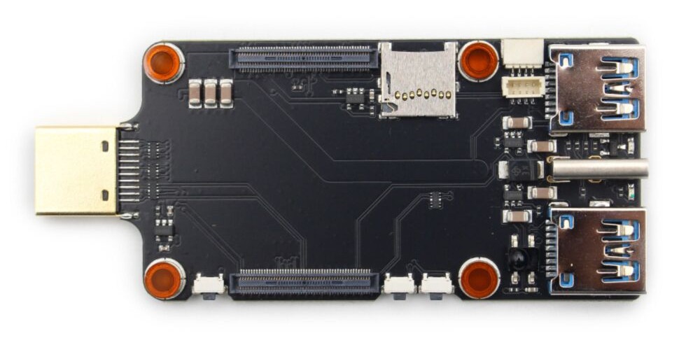

Raspberry Pi CM5 TV Stick Lite Front Side

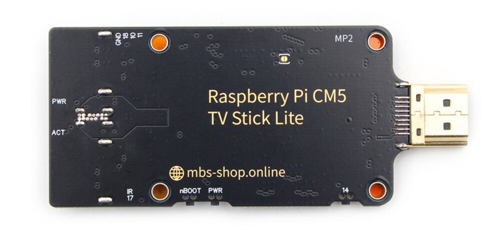

Raspberry Pi CM5 TV Stick Lite Bottom Side
