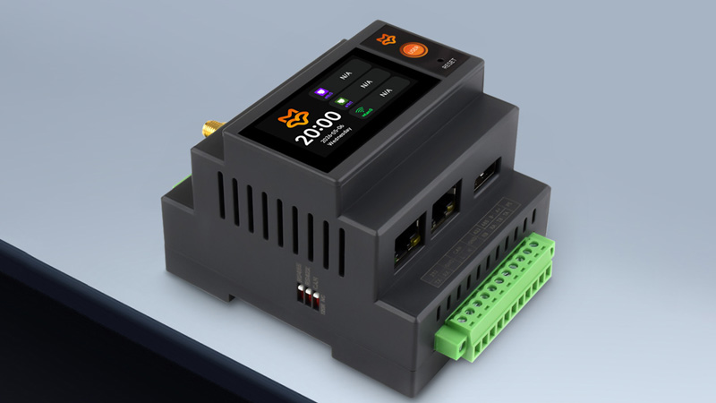

The Luckfox Lyra PLC features a touchscreen display and industrial I/O interfaces.

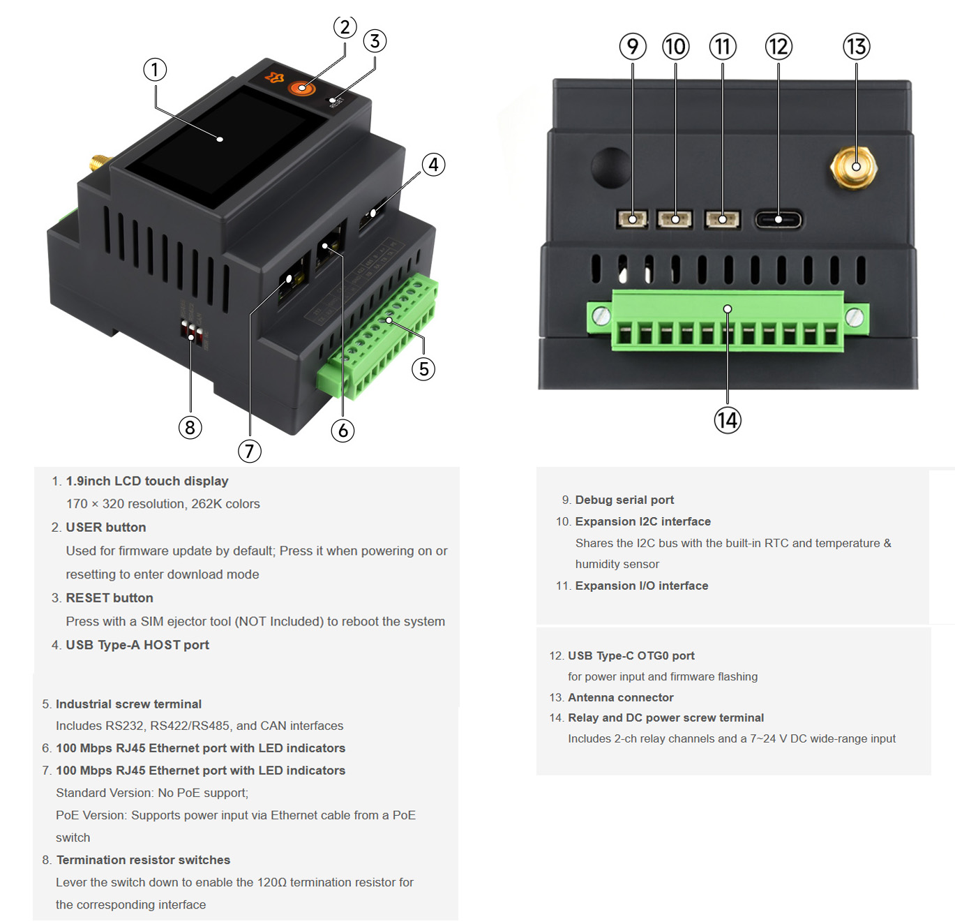

Luckfox Lyra – hardware overview showing its touchscreen, Ethernet ports, industrial interfaces, USB ports, and relay terminals.

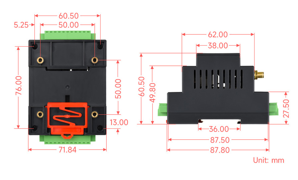

Luckfox Lyra PLC dimensions and mounting hole layout.
