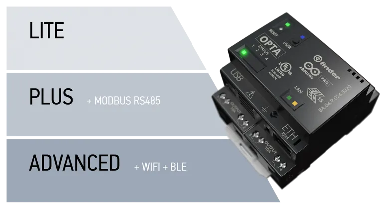

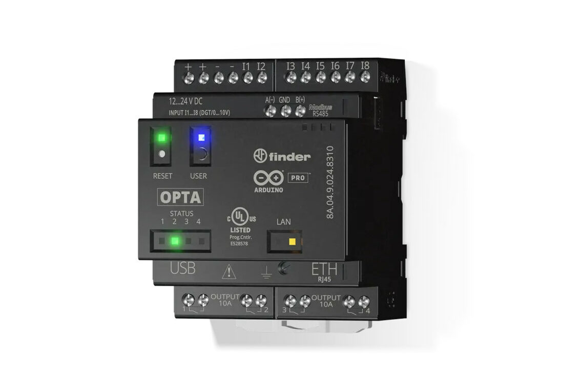

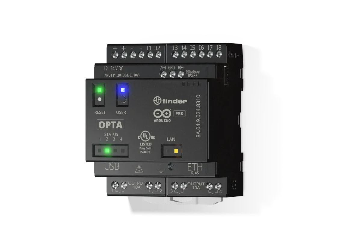

Internally, the DIN-rail mountable Opta — developed by Arduino in collaboration with Finder — employs an STMicro STM32H747XI dual-core microcontroller with a single high-performance Arm Cortex-M7 core running at up to 480MHz and a lower-power Cortex-M4 core running at up to 240MHz, as well as a shared floating-point unit (FPU), Chrom-ART accelerator, a hardware JPEG accelerator (SRAM).
Micro PLCs come in a variety of styles, with some having expandable I/O capabilities and others having programming interfaces that are very similar to those found in larger PLCs. A micro PLC, in essence, is a low-cost PLC with integrated I/O. Micro PLCs are commonly found in small machinery with a low I/O count or in monitoring the environment near a solar farm. Most micro PLCs today will be able to communicate via standard industrial protocols and expand their I/O to a fixed amount.
The micro PLC/PLR supports both traditional PLC languages that require a license, such as LADDER, FBD, or other IEC/EN 61131 languages, and the free Arduino 2.0.0 IDE with a variety of open-source libraries. Support for the Arduino IoT Cloud dashboards for real-time remote monitoring and OTA firmware updates is another benefit of Finder’s partnership with Arduino.
The Opta will be available in three variants at launch: the Opta Lite, which includes Ethernet connectivity and a USB Type-C port for programming; the Opta RS485, which includes RS485 half-duplex support; and the Opta WiFi, which includes Wi-Fi and Bluetooth Low Energy (BLE) radios. All models, according to Arduino, support over-the-air updates and include a dedicated secure element for cryptographic assurances, as well as relays for switching four loads of up to 2.3kW each.
