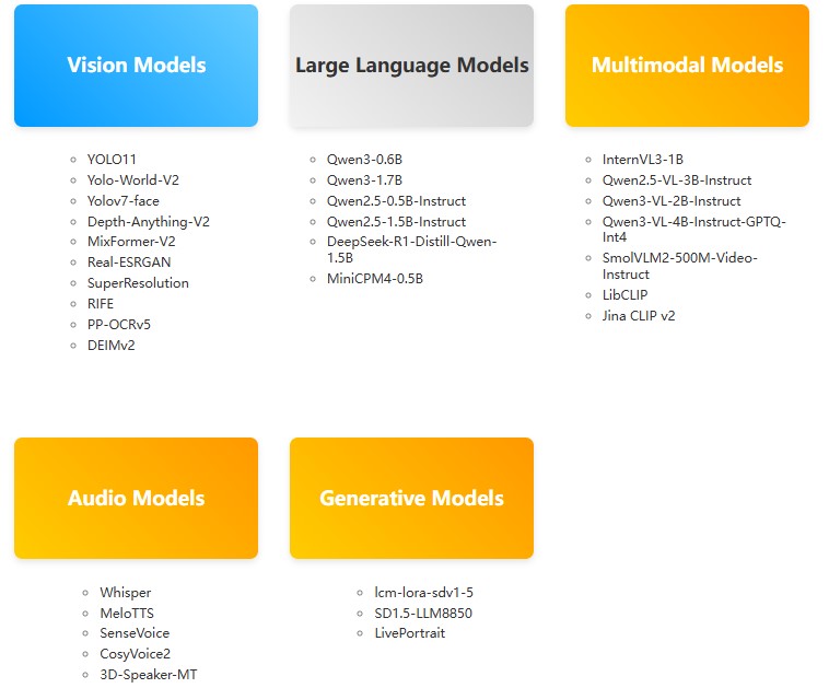

Only Linux distributions are in alignment with the M5Stack LLM-8850 card’s software. Debian 12 and Ubuntu 20.04, 22.04, and 24.04 are among the supported operating systems. Virtualization environments, WSL, Windows, and macOS are not available for support. The AXCL Runtime architecture, which offers C and Python programming interfaces for card interaction and model management, is compatible with this Linux-only strategy. Installing AXCL Runtime is done in accordance with standard Linux package procedures. The official M5Stack documentation page contains comprehensive setup instructions, sample code, and comprehensive documentation.
M5stack LLM-8850 Card Compatible Model List
