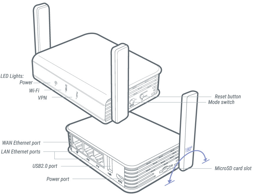

With dimensions of 88 x 68 x 24mm, the Brume-W wireless gateway is a powerful and yet stable networking system with a high-performance chipset designed to run cutting-edge cryptography at great speed, and a pre-installed OpenWrt that allows in-depth developments for commercial IoT projects. It supports more than 30 VPN services, allows speeds of up to 280 Mbps, and has been applauded by VPN tunnels like WireGuard, for its ”excellent VPN routing experience.”
The pocket-sized Brume-W wireless gateway runs Linux on Marvell’s ARMADA 88F3720  dual-core Cortex A53 processor clocked at 1.0 GHz with a packet processor accelerator.
Some noteworthy features of the gateway include:
  • 1 GB RAM of system memory
  • 16MB NOR flash and 8GB eMMC flash
  • MicroSD slot that supports up to 256 GB
  • 3x Gigabit Ethernet Ports: 1x WAN and 2x LAN
  • Built-in 2.4 GHz 802.11b/g/n WiFi 4 up to 300 Mbps supported by a pair of external WiFi antennas
  • Eternal 802.22ac WiFi 5 support via the single USB 2.0 host port
  • 1x MicroUSB 3.0 Type – C port and 1x USB 2.0 host port
  • Power and Reset buttons, WiFi and VPN status LEDs
  • 5V/3A power supply via the USB – C port, and
  • Support for 0 to 40 °C temperature range
