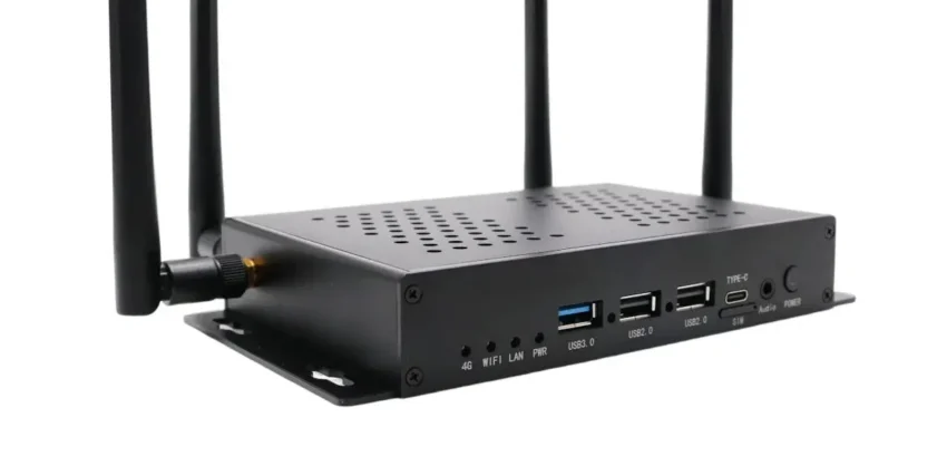

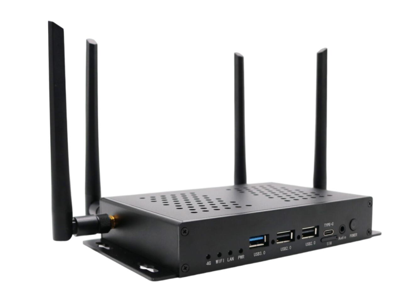

Mekotronics has released an upgrade to the original R58X RK3588 mini-computer, adding support for 4G LTE and Power over Ethernet (PoE). The compact R58X-4G mini PC is perfect for a wide range of applications including home entertainment, digital signage, light gaming, and remote work.
Mekotronics has released an upgrade to the original R58X RK3588 mini-computer, adding support for 4G LTE and Power over Ethernet (PoE). The compact R58X-4G mini PC is perfect for a wide range of applications including home entertainment, digital signage, light gaming, and remote work. It is powerful and versatile, offering two 8K capable HDMI and DisplayPort video outputs, one 4K HDMI input, and a few USB ports. Thanks to the 4G LTE which was included in the board; you can easily connect it to mobile networks for internet access and this will work well for you if you are in a place that has no reliable internet connection. You also do not need to get yourself a separate power source as you can power the board with the same Ethernet cable that is used for data connectivity. This also means easy and convenient installations for you, thanks to the PoE support.
The mini PC also has support for up to 16GB of LPDDR4 RAM and 128GB eMMC storage, two Gigabit Ethernet ports, WiFi 6, and Bluetooth 5. At its heart is the high-performance Rockchip RK3588 processor optimized for use in IoT devices, embedded systems, and mini PCs.The processor is based on an 8-core ARM Cortex-A76 CPU architecture and Mali-G610 MP4 graphics.
