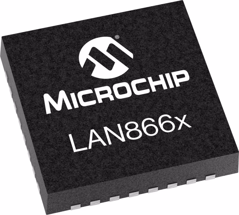

The LAN866x series of 10BASE-T1S Ethernet endpoint devices has recently been introduced by Microchip. These ICs, which have been optimized for in-car networking applications, leverage the Remote Control Protocol (RCP) to remove software coming from edge nodes and promote true centralized control of systems. This speeds up the deployment of zonal Ethernet and makes the idea of Software Defined Vehicles (SDVs) possible. Connecting an increasing number of sensors and actuators ends up becoming more difficult for designers as the automotive industry transitions to zonal architectures for in-car networking. By acting as bridges and translating Ethernet packets straight to local digital interfaces, the LAN866x endpoints are intended to make network integration easier. These endpoints are software-less, which eradicates the need for node-specific software programming and simplifies silicon consumption and physical footprint, in contrast to traditional solutions.
lan866x-lmx-regular
lan866x-lmx-regular
The LAN866x endpoint IC family, which includes specialized versions for control (LAN8660), lighting (LAN8661), and audio (LAN8662) applications, is the centerpiece of Microchip’s announcement. These devices’ ability to translate Ethernet packets straight to local digital interfaces via an OA3p network interface is a key feature. The chips eliminate the need for embedded code or microcontroller-based logic at each node. The endpoints make room for centralized control of edge nodes for device management and data streaming by supporting standard-based RCP protocols. This solution supports an all-Ethernet, zonal architecture that lowers cabling, software integration, and cost by using a 10BASE-T1S multidrop topology.
