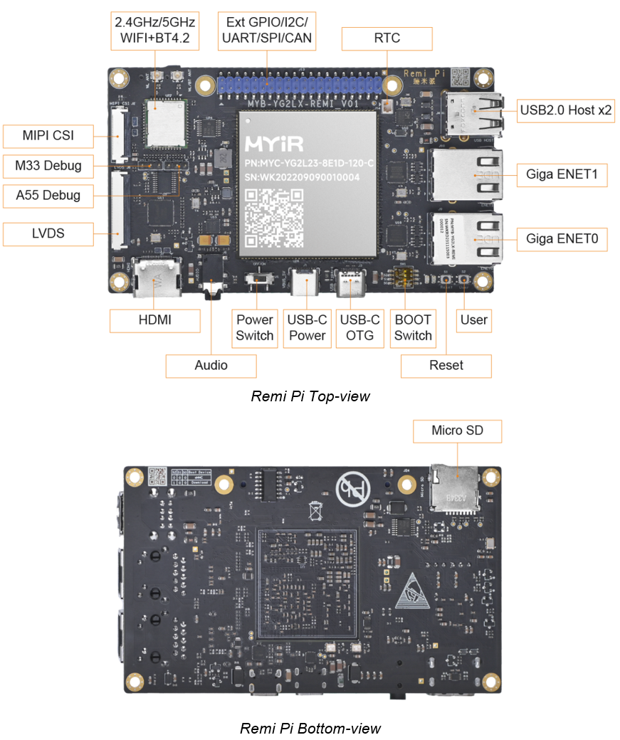

MYIR Remi Pi Features Renesas RZ/G2L SoC and Costs Just $55.00
MYIR Remi Pi is a Renesas RZ/G2L-based SBC, with dual Gigabit Ethernet ports, dual display support, and a MIPI-CSI camera interface. It also features 3D graphics functions powered by Arm Mali-G31.
MYIR Remi Pi, a Renesas RZ/G2L-based SBC, offers dual Gigabit Ethernet ports, dual display support, and a MIPI-CSI camera interface.
MYIR Remi Pi is a Renesas RZ/G2L-based SBC, with dual Gigabit Ethernet ports, dual display support, and a MIPI-CSI camera interface. It also features 3D graphics functions powered by Arm Mali-G31. Additionally, it features HDMI, LVDS, and MIPI-CSI for seamless connectivity with various display devices
The specific SoC that powers this SBC is called the R9A07G044L23GBG it features a dual-core ARM Cortex-A55 processor, running at speeds of up to 1.2GHz with FPU support, along with a single Arm Cortex-M33 processor clocked at up to 200MHz. The Arm Mali-G31 in the SoC is clocked to 500MHz. It also includes a video codec supporting H.264 for efficient multimedia processing across various applications.

MYIR Remi Pi Specifications
  • CPU:
    • RENESAS RZ/G2L processor (R9A07G044L23GBG)
    • 1.2 GHz Dual-core ARM Cortex-A55
    • 200 MHz ARM Cortex-M33
    • 3D graphics functions (Arm Mali-G31)
    • Video codec (H.264)
  • kaMemory:
    • 1GB DDR4
  • Storage:
    • 8GB eMMC
    • 32KB EEPROM
  • PMIC (Power Management IC):
    • RAA215300
  • Communications:
    • 2 x Debug UART
    • 2 x 10/100/1000M Ethernet
    • 2 x USB2.0 Host (Type-A)
    • 1 x USB2.0 OTG (Type-C)
    • 1 x USB-UART debug interface
    • 1 x 2.4GHz/5GHz WiFi and Bluetooth 4.2 Module
    • 1 x Micro SD card slot
  • Display:
    • 1 x HDMI Display Interface
    • 1 x LVDS Display Interface
    • 1 x MIPI-CSI Camera Interface
    • 1 x Audio Input and Output Interface
  • User I/O:
    • 1 x 2.54mm 2 x 20-pin male expansion header
    • Supports GPIO/I2C/UART/SPI/CAN
  • Power supply:
    • USB power supply
  • Others:
    • 3 x Buttons (Reset, Power On/Off, User)
    • 2 x LEDs (Power indicator, System Status LED)
    • 1 x RTC Battery Holder
  • OS support:
    • Linux 5.10.83
  • Working Temp.:
    • 0~70 Celsius (commercial grade)
  • Dimensions:
    • 70mm x 120mm (6-layer PCB design)
MYIR’s SBC is Linux 5.10.83 compatible, offering configurations like myir-image-full for HMI and myir-image-core for industrial use which all can be found on their downloads page, including RT-Linux and FreeRTOS. Ubuntu and Debian support is forthcoming. The company also offers additional modules like the MY-CAM003M Camera Module and MY-LVDS070C LCD to enhance compatibility with Pi extension modules for versatile project adaptation.
The MYIR Remi Pi SBC offers detailed technical specifications and purchasing options on its website. priced at $55.00 you can get the board from their products page.
