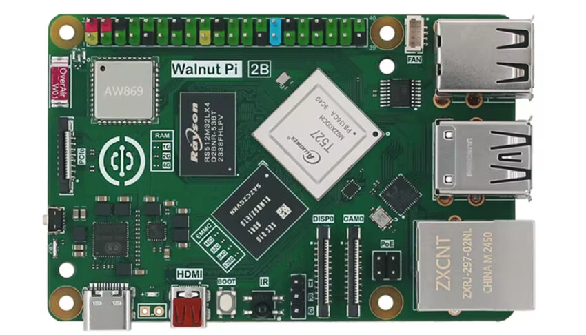

It is powered by an Allwinner T527 octa-core Cortex-A55 processor, with options for 1GB, 2GB, or 4GB of LPDDR4 RAM, and optional 32GB eMMC flash storage. This SBC also includes a microSD card slot for storage expansion. It offers Gigabit Ethernet, Wi-Fi 6, and Bluetooth 5.0 for connectivity. The board features a 40-pin GPIO header (likely partially compatible with Raspberry Pi HATs), a PCIe 2.0 x1 FFC connector for expansion (allowing for NVMe SSD connection), one USB 3.0 port, three USB 2.0 ports, and a micro HDMI port capable of 4K 60Hz output. Some models also include a 2 TOPS NPU (Neural Processing Unit) for AI acceleration and an IR receiver.
The Walnut Pi 2B is compact, with dimensions of 85 x 56 mm, and can be powered via a USB-C port or Power over Ethernet (PoE). They position it as a competitively priced option, offering some features not found on the Raspberry Pi 5, like Wi-Fi 6 and an integrated AI accelerator, though it has fewer USB 3.0 ports and only one HDMI output.

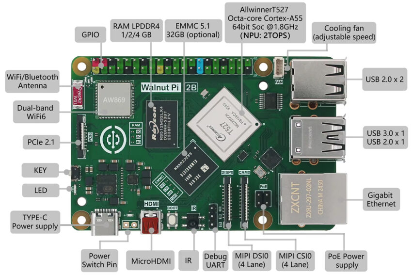

  • SoC: Allwinner T527
    • CPU: Octa-core Arm Cortex-A55 processor @ up to 1.8GHz, RISC-V core up to 200 MHz
    • GPU: Arm Mali-G57 MC1
    • NPU: Optional 2 TOPS (available on specific SKUs)
  • System Memory: 1GB, 2GB, or 4GB LPDDR4 RAM
  • Storage:
    • MicroSD card slot
    • Optional 32GB eMMC flash (on specific SKUs)
    • 8MB SPI flash
  • Video Output:
    • 1x Micro HDMI 2.0 port up to 4K @ 60Hz
    • MIPI DSI display interface (4-lane)
  • Audio:
    • Via Micro HDMI output
    • 1x 3.5mm headphone jack (audio output + microphone input)
  • Camera Input: MIPI CSI camera interface (supports 2-lane or 4-lane mode input)
  • Networking:
    • Wired: Gigabit Ethernet RJ45 port
    • Wireless:
      • Wi-Fi 6 (802.11ax) via SDIO 3.0 module
      • Bluetooth 5.0 via SDIO 3.0 module
  • USB:
    • 1x USB 3.0 Type-A port
    • 1x USB 2.0 Type-A port
    • 2x USB 2.0 interfaces via 2.54mm pitch header pins
  • Expansion:

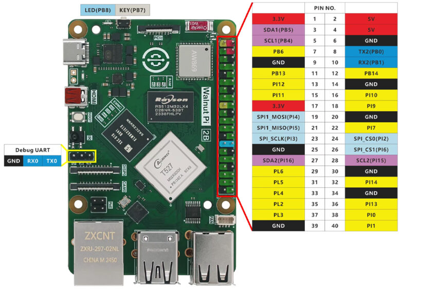

    • 40-pin GPIO header (partially Raspberry Pi compatible) with UART, I2C, SPI, PWM, etc.
    • PCIe 2.0 x1 FFC connector (for NVMe SSD expansion via adapter board)
  • Debugging: 3-pin UART header for serial console (UART0)
  • Miscellaneous:
    • IR receiver (on specific SKUs)
    • Power button
    • Reset button (likely)
    • Power LED, Status LED
    • RTC support (requires external battery)
  • Power Supply:
    • 5V via USB Type-C port
    • Supports PoE (Power over Ethernet) via an external PoE module connected to designated header pins
  • Dimensions: 85 x 56 mm (Raspberry Pi Model B form factor)
