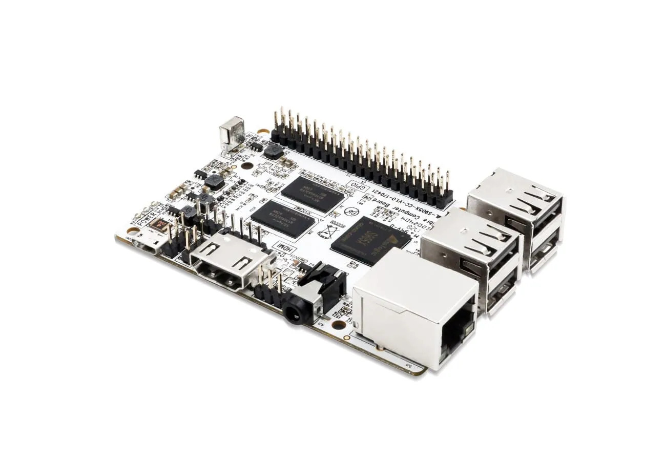

We are very pleased to announce that Libre Computer, has just released a new model of its Le Potato SBC, targeted at unique commercial and consumer application needs. This new addition to the range of open-source Raspberry Pi alternatives named AML-S905X-CC-V2 comes with 4K media playback and claims GPIO compatibility with the Raspberry Pi.

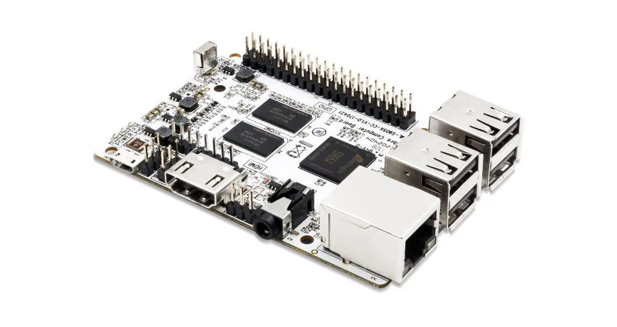

The new “Sweet Potato” board, as it is also called, is based on an Amlogic S905X SoC – a 4-core Arm Cortex-A53 processor clocked at up to 1.5GHz with 2G + 3P ARM Mali-450 GPU. It is also equipped with a 5-pin USB header which provides a direct interface for UVC cameras.
This new Sweet Potato has predecessors such as the AML-S905X-CC “Le Potato” board. One thing that differentiates it from them is that it comes with a DDR4 memory and a 16MB SPI boot ROM with a Boot Select Switch; an upgrade to the DDR3 in others. Another difference is that it offers 5V/3A Type-C power-in, compared to the 5V/2.5A microUSB that the others give. PoE support is another feature that helps to bring one-wire networking and power to your projects. The company claims that Sweet Potato pulls around 1W while idle. It also comes with a 5-pin USB header and an eMMC 5. X Slim module with the mounting standoff.
There is no CVBS/Stereo Analog Jack in it though but it still comes with a usual 40 pin GPIO header making it retain its compatibility with a number of HATs. Other similarities include the same Raspberry Pi 3B+ form factor, 4x USB Type-A ports, HDMI 2.0a, IR sensor, and the same Amlogic S905X SoC. It is also compatible with a $20 PoE HAT with PWM fan controller.
