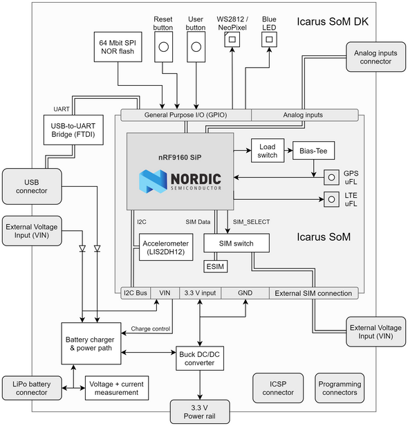

Actinius, an Amsterdam-based R&D firm, specializing in creating ultra-secure IoT products, has combined the latest cellular IoT technologies on the market to design a new Icarus SoM DK development board that follows the Arduino Uno form factor. The cost-effective single board development kit is powered by a Nordic Semiconductor low-power nRF9160 system-in-package (SiP) which integrates the use of GPS and cellular communication to get your project online anywhere and anytime.
The cost-effective single board development kit is powered by a Nordic Semiconductor low-power nRF9160 system-in-package (SiP) which integrates the use of GPS and cellular communication to get your project online anywhere and anytime. The development kit also features a low-power 3-axis accelerometer, a SIM-card holder, an onboard eSIM, a USB Type-C port, an external nano SIM connector on the mainboard, a battery charging port, a power management system, Arduino headers for a wide range of I/Os, etc. It can be powered by any combination of USB, Battery, or Vin, and has compatibility with Arduino boards and shields.
Specifications of the Icarus SoM DK Development Board Include:
Icarus SoM
  • Nordic Semi nRF9160-SICA system-in-package/modem with:
    • Arm-cortex-M33 MCU, 1MB flash, 256 KB SRAM
    • LTE CAT-M1 (eMTC), CAT-NB1 (NB-IoT), GPS connectivity
  • 64 Mbit SPI flash
  • On-board eSIM
  • 2x u.FL connectors for LTE and GPS
  • Low-power 3-axis accelerometer
  • 2x 20 castellated holes with GPIOs, I2C, SWD, Reset, SIM card signals, and power pins
  • Supply voltage: 3.3V
  • Size: 28 mm x 18.5 mm
USB
  • 1x USB Type-C (for power and programming)
Expansion
  • Arduino Uno Rev3 headers with:
    • GPIOs (up to 18x)
    • 12-bit 200 ksps ADC (up to 6x)
    • SPI master/slave (up to 3x)
    • I2C master/slave (up to 4x)
    • UART (up to 4x)
    • I2C (Inter-IC Sound Interface)
    • Digital microphone Interface (PDM)
    • Pulse width modulator (up to 4x)
  • 6-pin SPI header
Security
  • Arm Trustzone, Arm Cryptocell 310, SSL/TLS
Others
  • 1x NANO Sim card on the main board
  • Serial Wire Debug (SWD) ON 1.27 mm connector
  • Neopixel RGB LED
  • User Button
  • Reset Button
Power Supply
  • 5V via USB Type-C port
  • 4.35 V to 10.2 V via Vin pin
  • 3.2 V to 4.2 V Li-Ion/LiPo battery with battery voltage reading and USB charging
  • Output supply up to 400mA
  • Overvoltage and under-voltage protection
Dimension
  • 68.5 mm x 55.2 mm (compatible with Arduino boards and shields)
