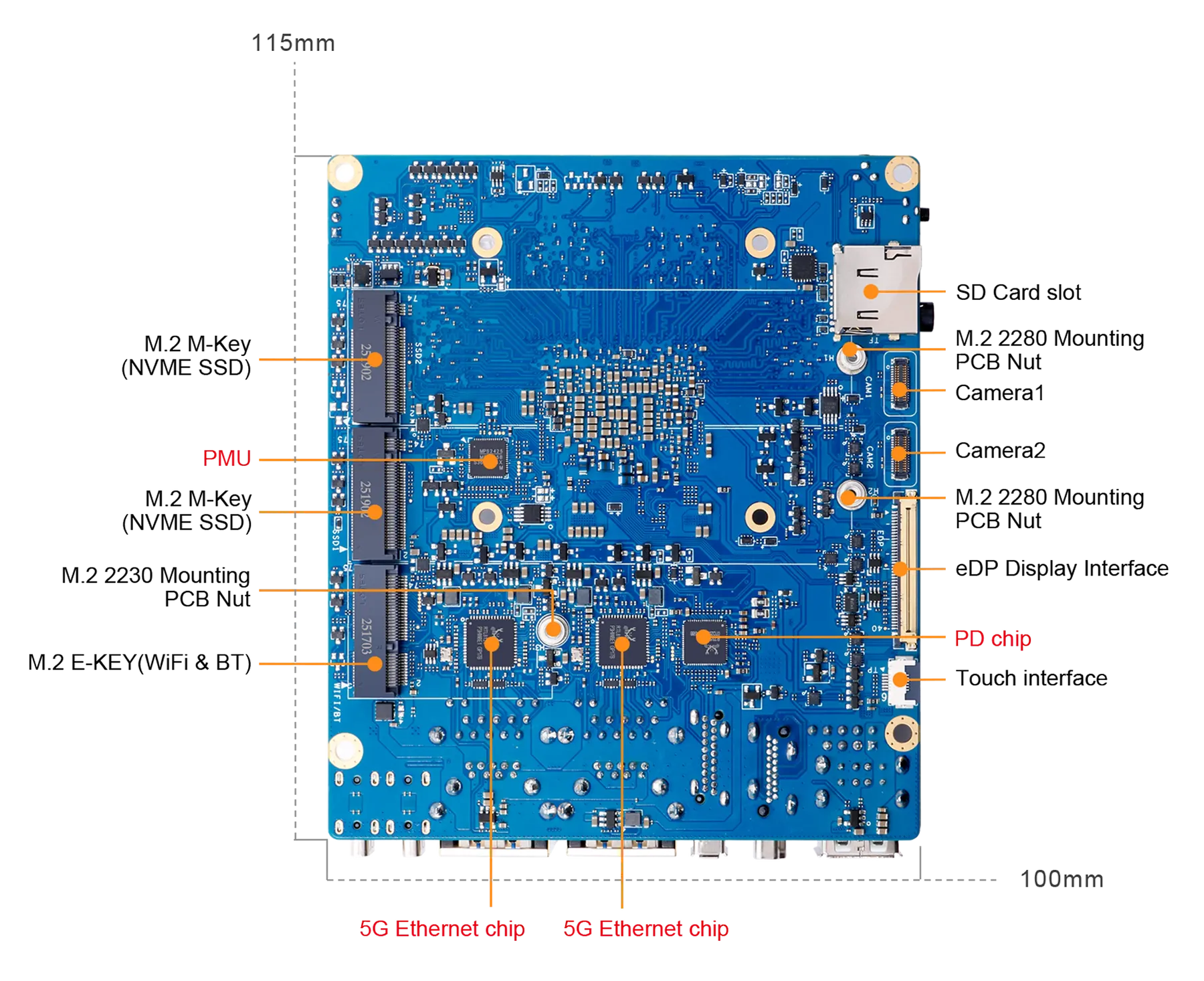

Orange Pi 6 Plus Pinout Diagram

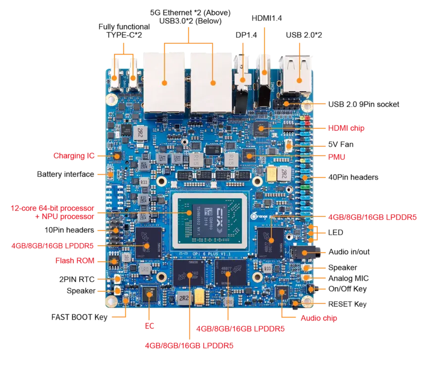

Orange Pi 6 Plus Top Hardware Overview

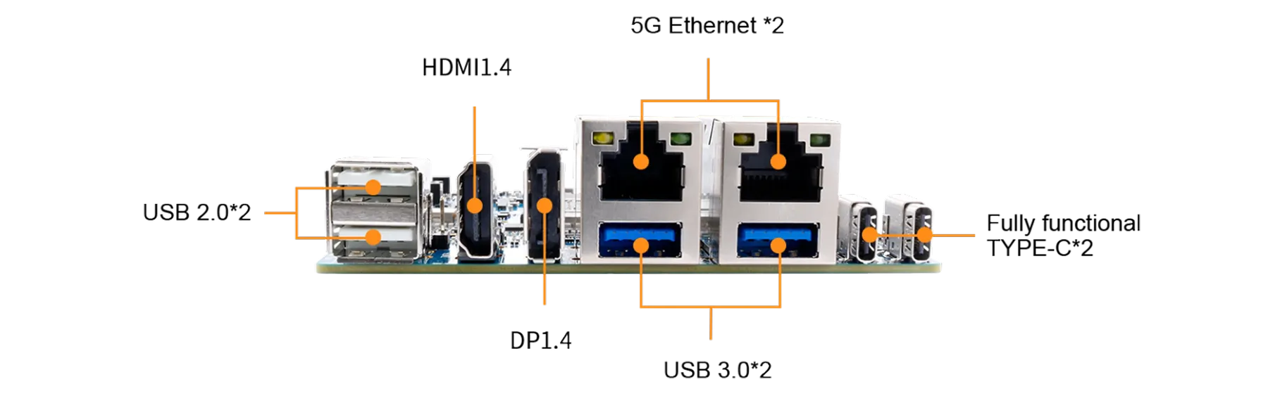

Orange Pi 6 Plus Side View

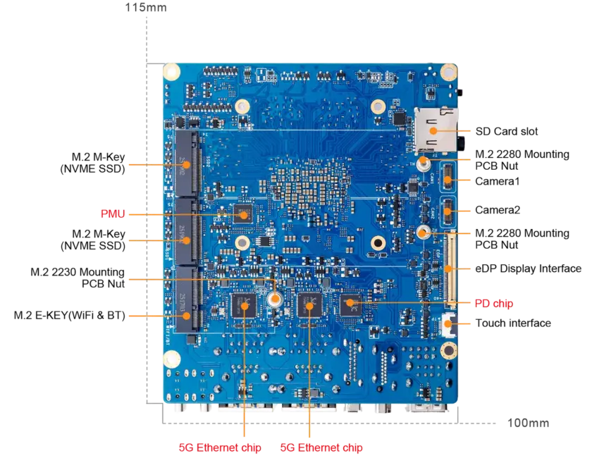

Orange Pi 6 Plus Bottom View
