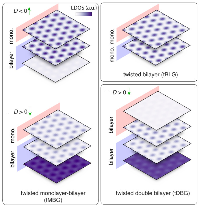

Graphene layers stacked and twisted
To conduct the experiment, the scientists stacked a monolayer sheet of graphene onto a bilayer sheet and twisted them by about 1 degree. At temperature levels a couple of degrees over, the group observed a range of insulating states and which do not carry out electrical energy, but they are driven by strong interactions between electrons. They also discovered that these states can be managed by using an electrical field throughout the graphene sheets.
We learned that the direction of an applied electric field matters a lot,
stated Yankowitz, who is likewise a previous postdoctoral scientist in Dean’s group.
On the other hand, when the scientists pointed the electrical field towards the monolayer graphene sheet, the system looked like twisted bilayer graphene. But when they put the direction of the electrical field towards the bilayer graphene sheet, it resembled twisted double bilayer graphene—the four-layer structure.
Besides, the group found completely new magnetic statesin the twisted system. Unlike standard magnets, which are driven by a quantum mechanical residential or commercial property of electrons called “spin“. As they observed, a collective twisting movement of the electrons in the group’s three-layer structure carries the magnetism.
