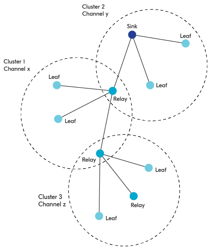

A DECT NR+ network can be point-to-point, star, or mesh. The mesh variant is organized as a clustered tree. One device, called the sink, connects to the internet, picks a channel, and sends beacons that other devices hear before they join.
Relay nodes pass data between clusters, and leaf nodes sit at the edge. Each device chooses its own next hop. If a path fails, the network can find another route.
Figure 1. DECT NR+ mesh network with one sink, relay nodes, and leaf nodes grouped into clusters on different channels. Image used courtesy of Nordic Semiconductors

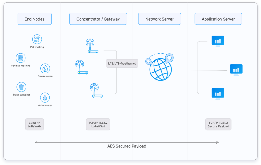

LoRaWAN uses a star-of-stars layout in which devices talk only to gateways, and the gateways forward the data to a network server. Its data rate ranges from 0.3 to 50 kbps, and in Europe a 1% duty cycle limits airtime.

Figure 2. In a LoRaWAN network, end nodes reach the system only through gateways, creating a star-of-stars layout. Image used courtesy of The Things Network
