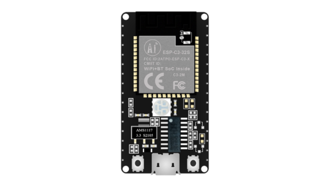

One of the NodeMCU boards, the NodeMCU ESP32-C3S kit is built around the ESP32-C3S module featuring a RISC-V 32-bit single-core processor that is clocked up to the frequency of 160MHz with 400 KB SRAM, 384 KB ROM, and 8KB RTC SRAM. The onboard ESP32-C3S module also supports IEEE 802.11b/g/n along with BLE 5.0 wireless connectivity.
NodeMCU ESP32-C3S Kit
Features of ESP32-C3S:
  • CPU: RISC-V 32-bit single-core processor @ 160MHz
  • Memory: 400 KB SRAM and 8KB RTC SRAM
  • Storage: 384 KB ROM, 4MByte flash
  • Wireless Connectivity: IEEE 802.11b/g/n and BLE 5.0
  • Interface: UART/GPIO/ADC/PWM/I2C/I2S
  • Power supply: 3.3V
More details on the Ai-Thinker module that is fitted on the NodeMCU ESP32-C3S Kit are available in the official datasheet provided by Ai-Thinker. You can buy the board on Aliexpress priced at $8.30.
