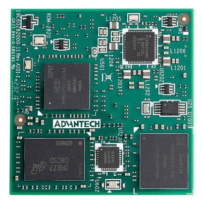

The new lineup of computer-on-modules features the NXP i.MX 95 processor.
The new lineup of computer-on-modules features the NXP i.MX 95 processor. Image used courtesy of Advantech.

The AOM-2521 Computer-on-Module comes in the OSM Size L form factor
The AOM-2521 Computer-on-Module comes in the OSM Size L form factor. Image used courtesy of Advantech.
