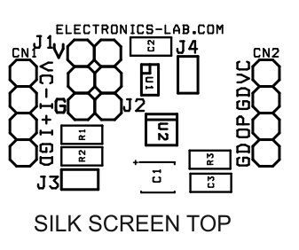

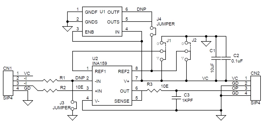

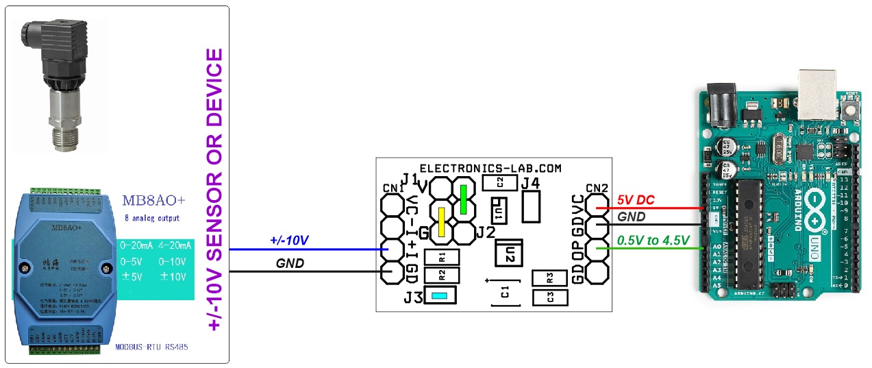

This board will make your work easy if you want to interface +/- 10V (Dual 10V) device or sensor to single-supply signal ADC. This tiny project has been made for industrial and process control applications and provides an easy interface between +/-10V (Dual 10V) sensor or device to single-supply ADC. Connect +/-10V sensor/device to pin 3 of connector CN1, and circuit outputs 0.5V to 4.5V at pin 3 of connector CN2. The operating supply of the circuit is 5V and it draws few milliamps of current. The project is also provided with optional precision Ref voltage for accurate output.

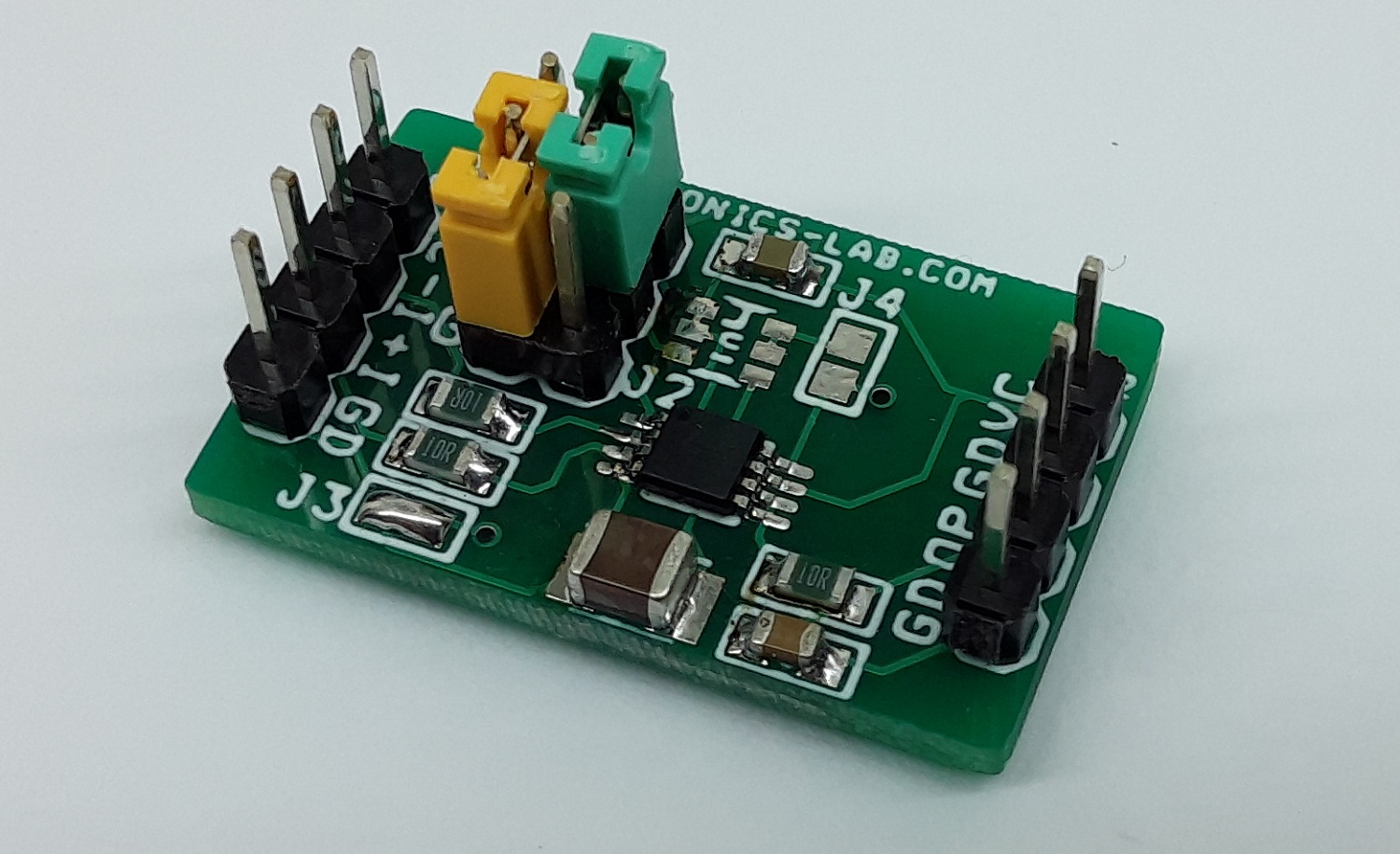

Testing this project is easy, close jumper J1 to VCC, J2 to GND, close the solder jumper J3, keep jumper J4 open, apply 5V DC to pin 1 and 2 of CN2, connect +/-10V source to pin 3 (+I) and GND. Measure the output at pin 3 (OP) of CN2.
Optional Reference Voltage: for precision output, use reference voltage chip U1 REF3425 or REF3225 from Texas, close Jumper J3, J4, and J1 to GND.
The INA159 is a high slew rate, G = 1/5 difference amplifier consisting of a precision op amp with a precision resistor network. The gain of 1/5 makes the INA159 useful to couple ±10V signals to single-supply analog-to-digital converters (ADCs), particularly those operating on a single +5V supply. The on-chip resistors are laser-trimmed for accurate gain and high common-mode rejection. Excellent temperature coefficient of resistance (TCR) tracking of the resistors maintains gain accuracy and common-mode rejection over temperature. The input common-mode voltage range extends beyond the positive and negative supply rails. It operates on +1.8V to +5.5V single or split supplies. The INA159 reference input uses two resistors for easy mid-supply or reference biasing. The difference amplifier is the foundation of many commonly-used circuits. The INA159 provides this circuit function without using an expensive external precision resistor network.

Schematic
Parts List
NOQNTY.REF.DESCMANUFACTURERSUPPLIERSUPPLIER PART NO
12CN1,CN24 PIN MALE HEADER 2.54MM PITCHWURTHDIGIKEY732-5317-ND
21C110uF/16V SMD SIZE 1210 OR 1206MURATA/YAGEODIGIKEY
31C20.1uF/50V SMD SIZE 0805MURATA/YAGEODIGIKEY
41C31KPF/50V SMD SIZE 0805MURATA/YAGEODIGIKEY
52J1,J2JUMPER3PIN/SHUNTWURTHDIGIKEY732-5316-ND
62J3,J4PCB JUMPER/SOLDER JUMPER
72U1,R1DNP
82R2,R310E 5% SMD SIZE 0805MURATA/YAGEODIGIKEY
91U2INA159AIDGKTTEXASDIGIKEY296-18688-1-ND
102SHUNT2.54MM PITCH FEMALESULINSDIGIKEYS9001-ND
Connections

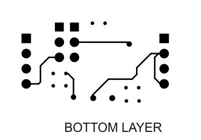

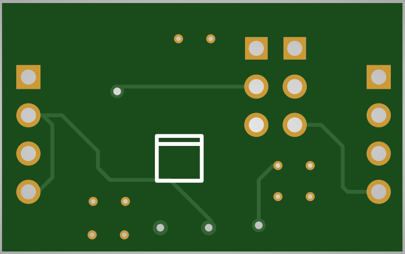

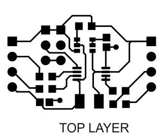

Gerber View

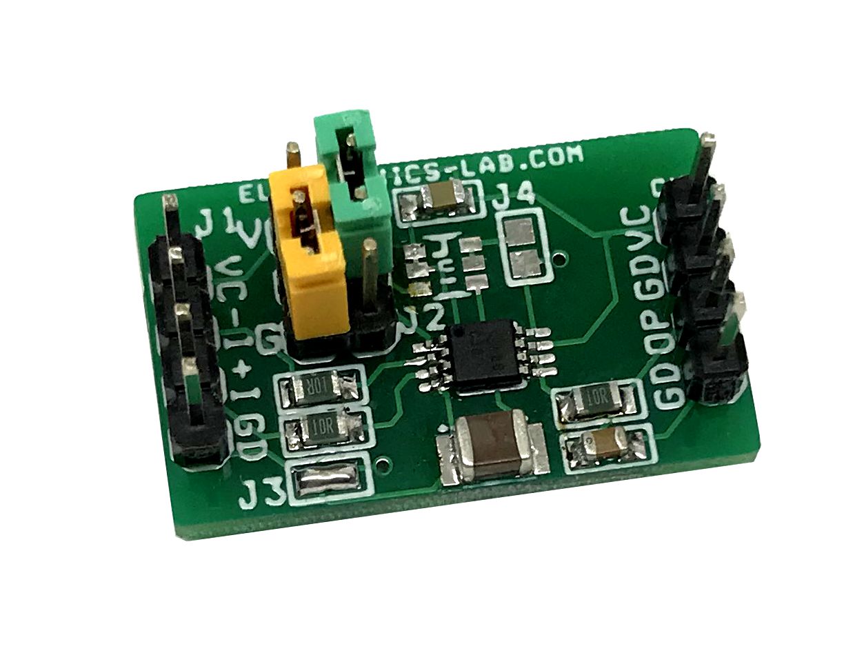

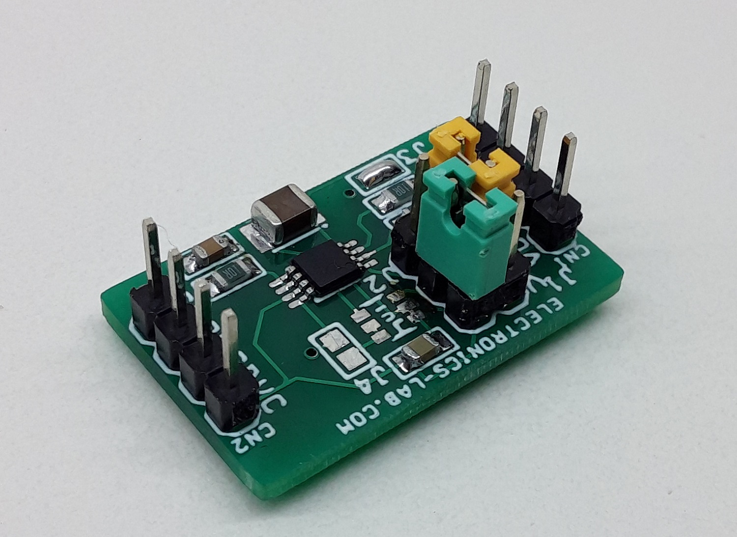

Photos
