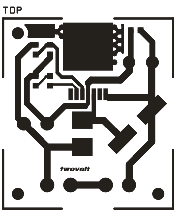

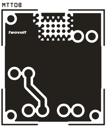

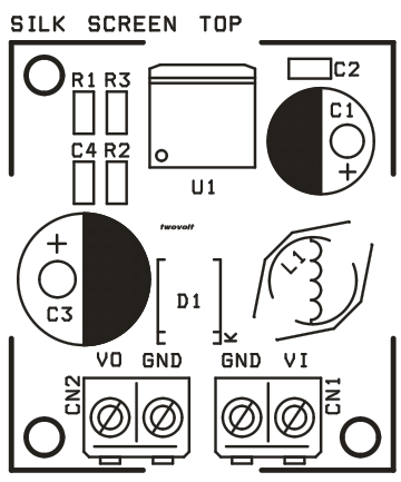

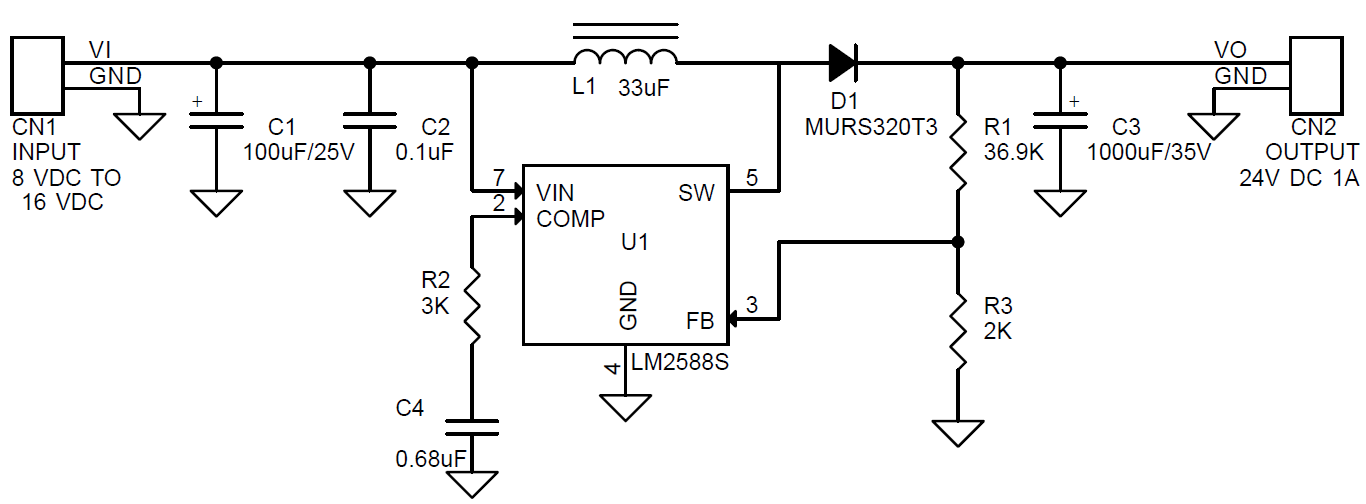

12V To 24V Booster is based on LM2588 IC from Texas Instruments. The LM2588 regulator integrated circuit specifically designed for fly-back, step-up (Boost) , and forward converter. The board provides 24V DC 1A DC output, Input 8V to 16V DC. Board has minimum components, screw terminal provided for input & outputs.
  • Supply Input 8V To 16V DC ( Ideal 12V DC)
  • Output 24V 1A
Schematic

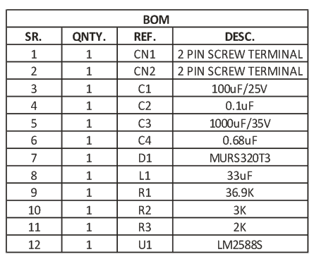

Parts List
