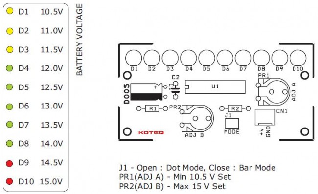

The LM3914 senses the voltage level at the input pin and drives the 10 light emitting diodes based on the voltage detected on input connector. Circuit works on same battery, doesnt not require separate supply input. Jumper is used to select the DOT mode or bar graph mode.
Specifications
- Supply input 15 VDC Max
- Maximum and Minimum range selectable with onboard preset
- Output 10 LED’s
- 2 Types of display Bar and Dot selectable by a jumper

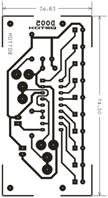

- Four mounting holes of 3.2 mm each
- PCB dimensions 37 mm x 75 mm

Where is + – battery conecting cable
You connect the battery to CN1 and the LEDs indicate the battery voltage. In other words it’s self powered from the measuring voltage, no need for additional power.
