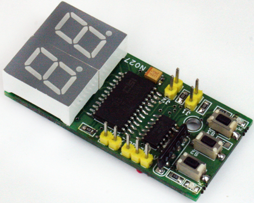

The projects shown here is a 2 Digit 00-99 Seconds or 00-99 Minutes Countdown kitchen timer based on PIC16F1825 micro-controller. The timer is useful in various applications like Cooking, Sports, Industrial, Sleeping.

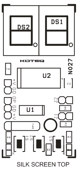

The projects shown here is a 2 Digit 00-99 Seconds or 00-99 Minutes Countdown kitchen timer based on PIC16F1825 micro-controller. The timer is useful in various applications like Cooking, Sports, Industrial, Sleeping. On board switches provided to set the time and start, a jumper to select the mode 99 Seconds or 99 Minutes. TTL output directly drives the Buzzer.
  • Supply 5V DC
  • Timer 0-99 Seconds Or 0-99 Minutes
  • On Board Power LED
  • On Board Output LED
  • Jumper J1 Mode Selection Open Seconds, Closed Minutes
  • 2 Digit 0.5Inch 7 Segment Display
  • Tact Switch for Time Set & Start
  • Output 5V TTL Direct Drive Buzzer
Schematic

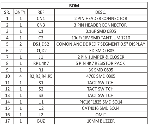

Parts List
Connections
