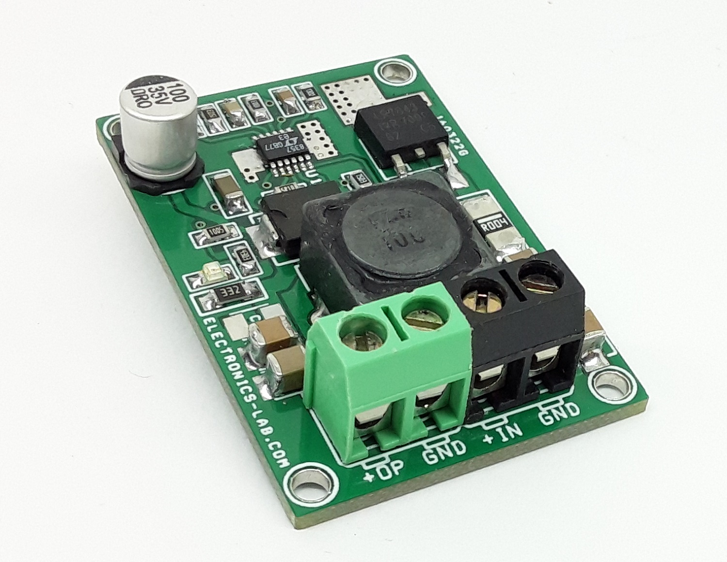

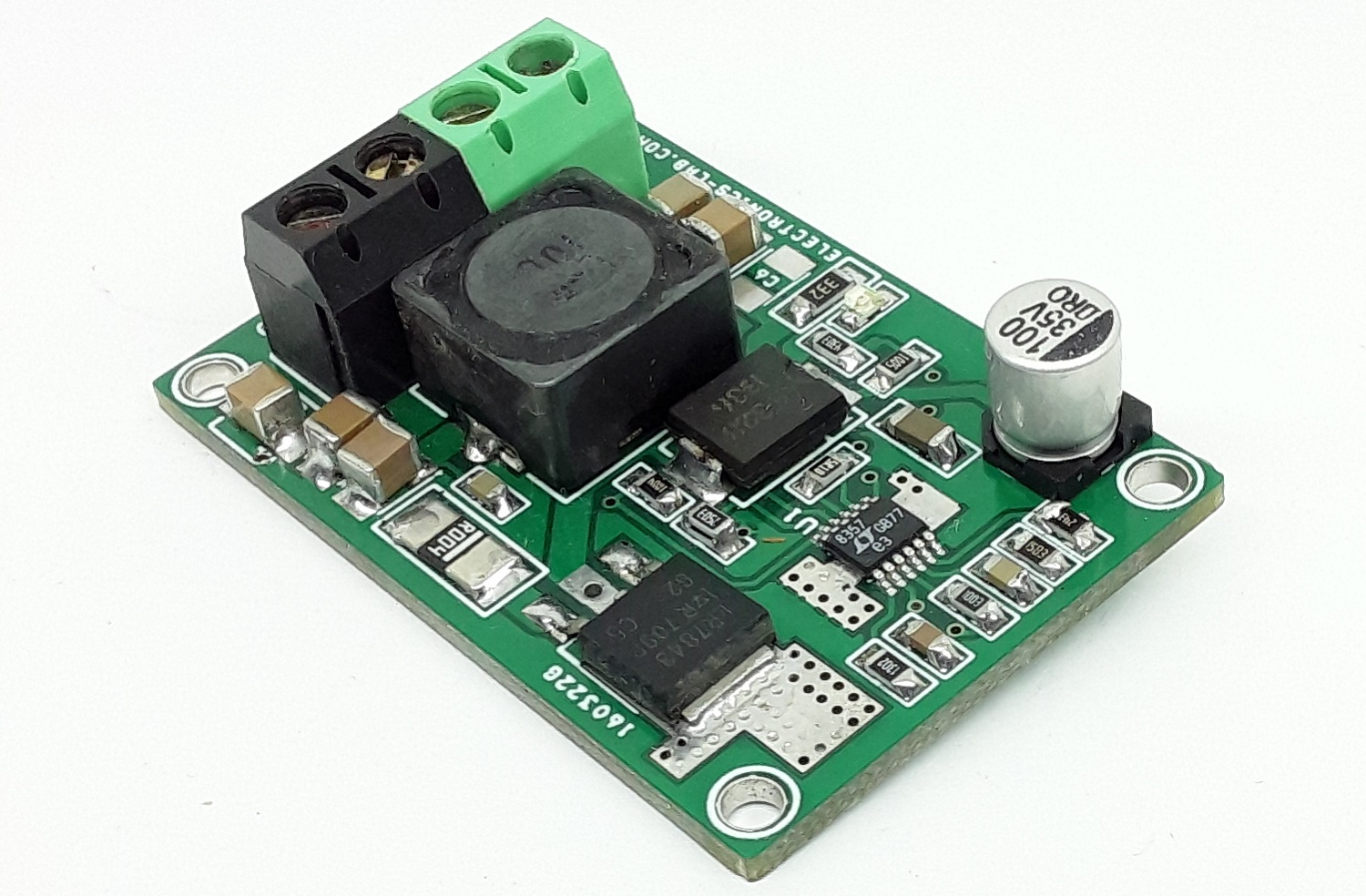

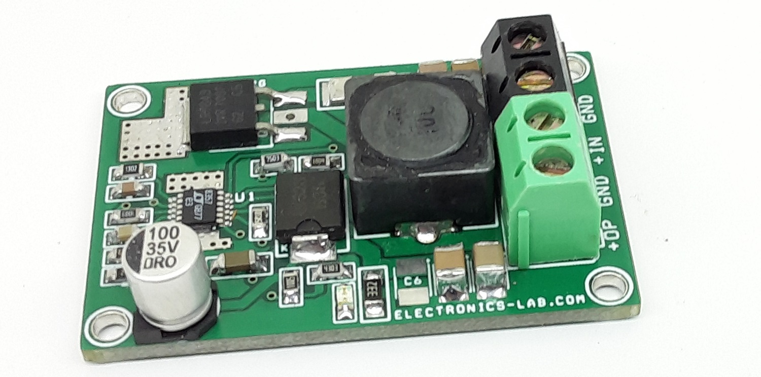

24V Boost Converter from 4.5V to 20V Input

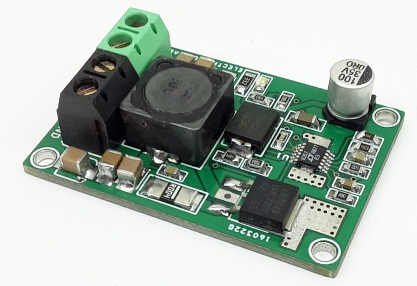

The project presented here is a boost converter with 24V output from 4.5V to 20V DC Input. The project is built using an LT8357 chip and configured as a boost converter.
The project presented here is a boost converter with 24V output from 4.5V to 20V DC Input. The project is built using an LT8357 chip and configured as a boost converter. Under voltage lockout, and soft-start are a few key features of the project. LED D1 indicates the output, and screw terminals are provided for easy output and input connections.

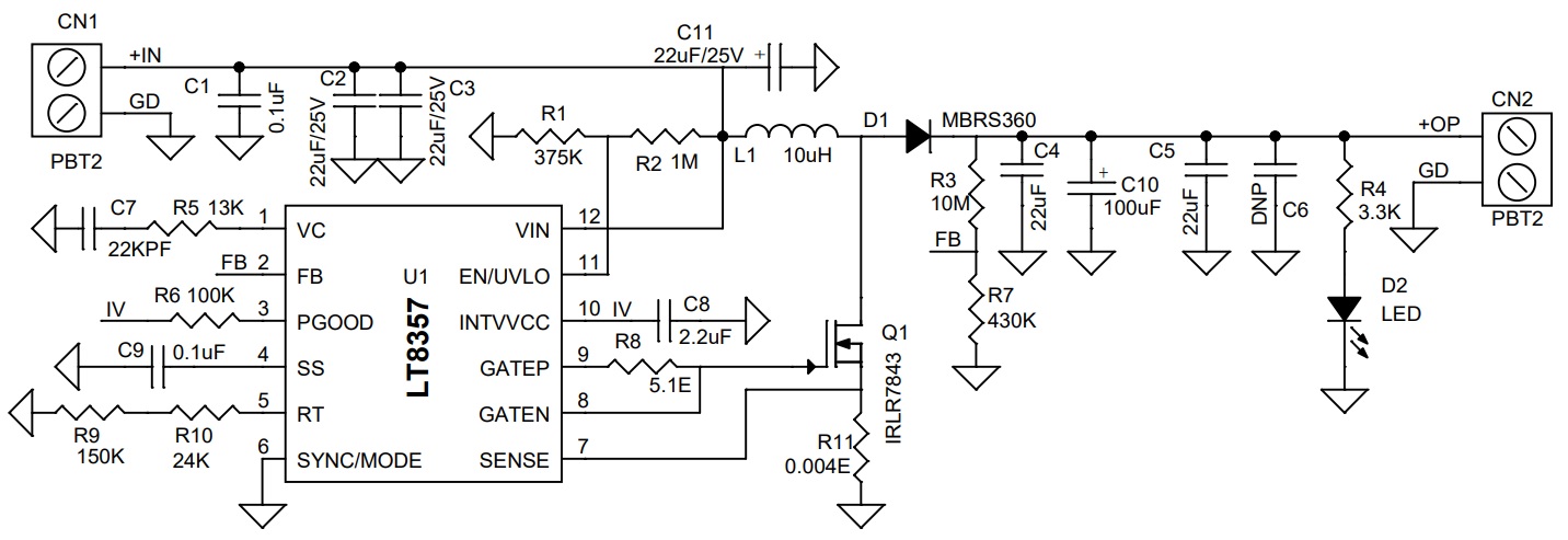

The LT8357 is a wide input range, current mode, and DC/DC controller which can be configured as a boost, SEPIC, or flyback converter. The LT8357 drives a low-side N-channel power MOSFET with a 5V split gate drive. The current mode architecture allows adjustable and synchronizable 100kHz to 2MHz fixed frequency operation, or internal 19% triangle spread spectrum operation for low EMI. At light load, either pulse-skipping mode or low-ripple Burst Mode operation can be selected. Additional features include output power good and output short circuit protection in SEPIC and flyback configurations with a wide 3V to 60V input voltage range and 8μA low quiescent current, the LT8357 provides a simple, compact and efficient solution for automotive, industrial, and battery-powered systems.

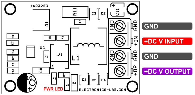

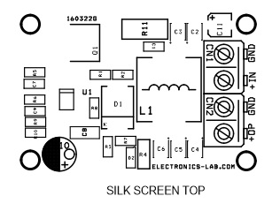

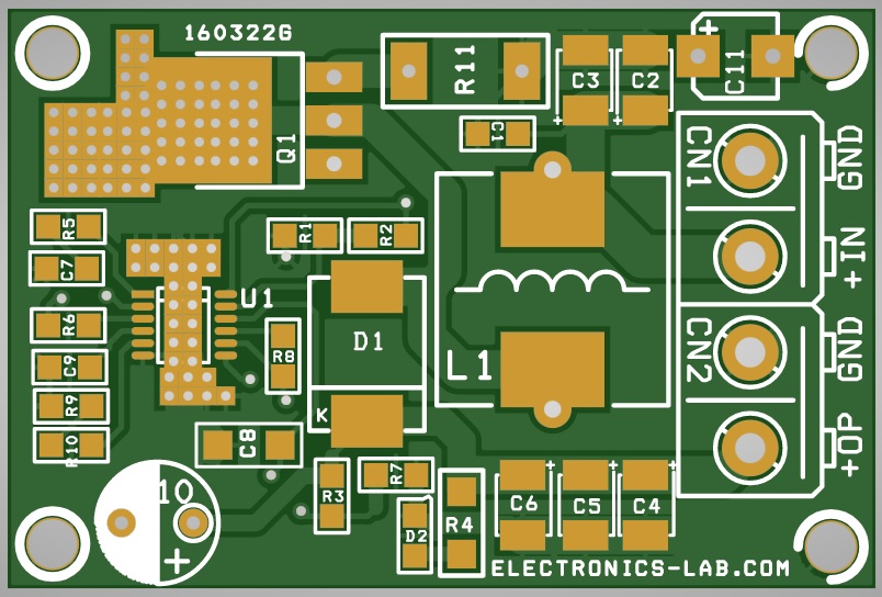

Connections
- CN1: Pin 1 = DC Supply Input 4.5V to 20V DC, Pin 2 = GND
- CN2: Pin 1 = +24V DC Output, Pin 2 = GND
- D2: Power LED
- Input Supply Range 4.5V to 20V
- Output 24V DC (Up to 2Amps)
- Operating Frequency 200Khz
- Under Voltage Lockout 4.3V
- Efficiency Up to 90-95%
- Soft Start Feature

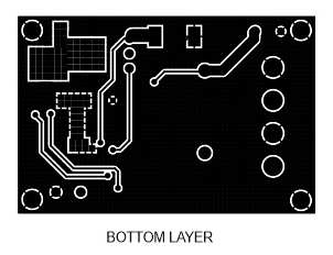

- PCB Dimensions 46.04 x 30.80 mm
- Power LED On Output
- 4 x 2.5mm Mounting Holes
Schematic

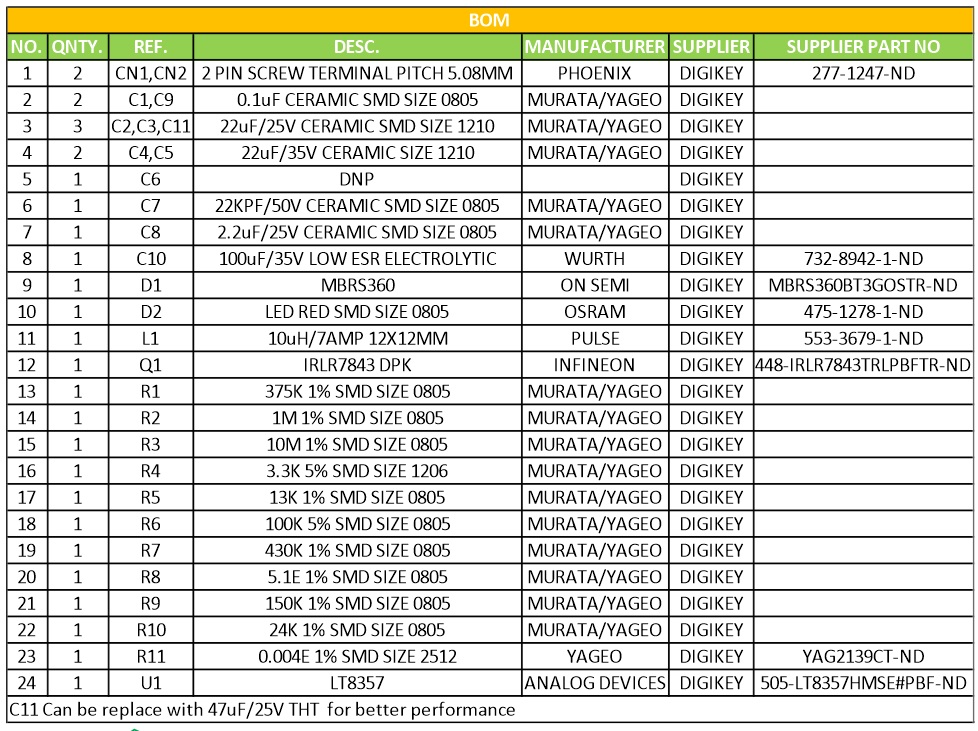

Parts List
| NO. | QNTY. | REF. | DESC. | MANUFACTURER | SUPPLIER | PART NO |
| 1 | 2 | CN1,CN2 | 2 PIN SCREW TERMINAL PITCH 5.08MM | PHOENIX | DIGIKEY | 277-1247-ND |
| 2 | 2 | C1,C9 | 0.1uF CERAMIC SMD SIZE 0805 | MURATA/YAGEO | DIGIKEY | |
| 3 | 3 | C2,C3,C11 | 22uF/25V CERAMIC SMD SIZE 1210 | MURATA/YAGEO | DIGIKEY | |
| 4 | 2 | C4,C5 | 22uF/35V CERAMIC SIZE 1210 | MURATA/YAGEO | DIGIKEY | |
| 5 | 1 | C6 | DNP | DIGIKEY | ||
| 6 | 1 | C7 | 22KPF/50V CERAMIC SMD SIZE 0805 | MURATA/YAGEO | DIGIKEY | |
| 7 | 1 | C8 | 2.2uF/25V CERAMIC SMD SIZE 0805 | MURATA/YAGEO | DIGIKEY | |
| 8 | 1 | C10 | 100uF/35V LOW ESR ELECTROLYTIC | WURTH | DIGIKEY | 732-8942-1-ND |
| 9 | 1 | D1 | MBRS360 | ON SEMI | DIGIKEY | MBRS360BT3GOSTR-ND |
| 10 | 1 | D2 | LED RED SMD SIZE 0805 | OSRAM | DIGIKEY | 475-1278-1-ND |
| 11 | 1 | L1 | 10uH/7AMP 12X12MM | PULSE | DIGIKEY | 553-3679-1-ND |
| 12 | 1 | Q1 | IRLR7843 DPK | INFINEON | DIGIKEY | 448-IRLR7843TRLPBFTR-ND |
| 13 | 1 | R1 | 375K 1% SMD SIZE 0805 | MURATA/YAGEO | DIGIKEY | |
| 14 | 1 | R2 | 1M 1% SMD SIZE 0805 | MURATA/YAGEO | DIGIKEY | |
| 15 | 1 | R3 | 10M 1% SMD SIZE 0805 | MURATA/YAGEO | DIGIKEY | |
| 16 | 1 | R4 | 3.3K 5% SMD SIZE 1206 | MURATA/YAGEO | DIGIKEY | |
| 17 | 1 | R5 | 13K 1% SMD SIZE 0805 | MURATA/YAGEO | DIGIKEY | |
| 18 | 1 | R6 | 100K 5% SMD SIZE 0805 | MURATA/YAGEO | DIGIKEY | |
| 19 | 1 | R7 | 430K 1% SMD SIZE 0805 | MURATA/YAGEO | DIGIKEY | |
| 20 | 1 | R8 | 5.1E 1% SMD SIZE 0805 | MURATA/YAGEO | DIGIKEY | |
| 21 | 1 | R9 | 150K 1% SMD SIZE 0805 | MURATA/YAGEO | DIGIKEY | |
| 22 | 1 | R10 | 24K 1% SMD SIZE 0805 | MURATA/YAGEO | DIGIKEY | |
| 23 | 1 | R11 | 0.004E 1% SMD SIZE 2512 | YAGEO | DIGIKEY | YAG2139CT-ND |
| 24 | 1 | U1 | LT8357 | ANALOG DEVICES | DIGIKEY | 505-LT8357HMSE#PBF-ND |
| Note: | C11 | use a 47uF/25V Electrolytic THT | for better performance |
