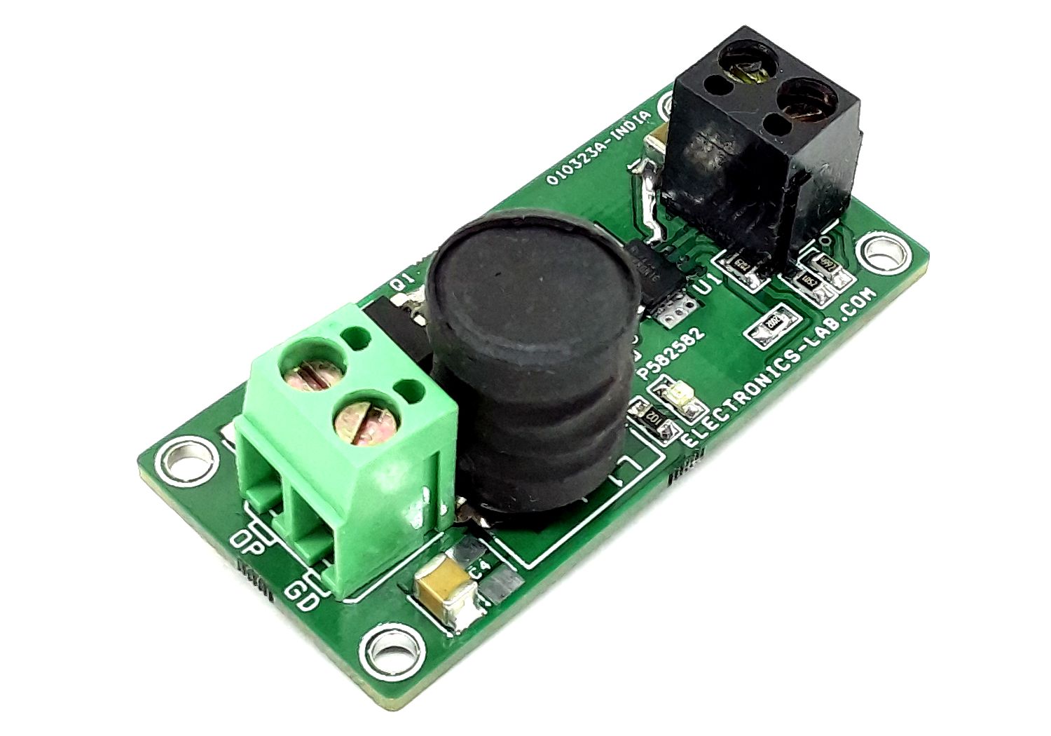

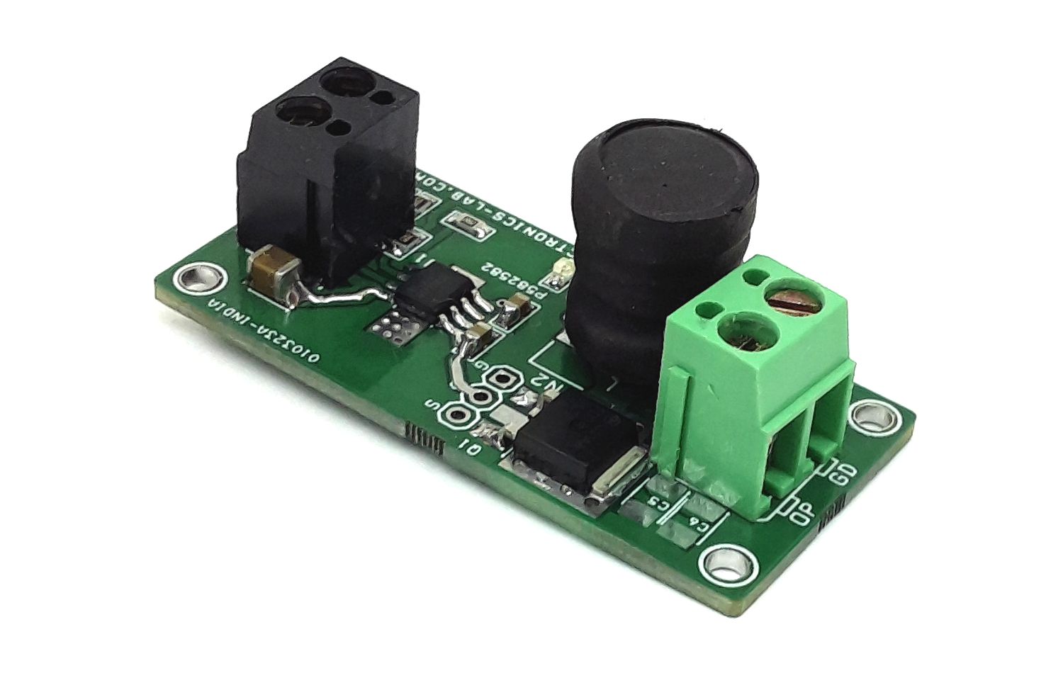

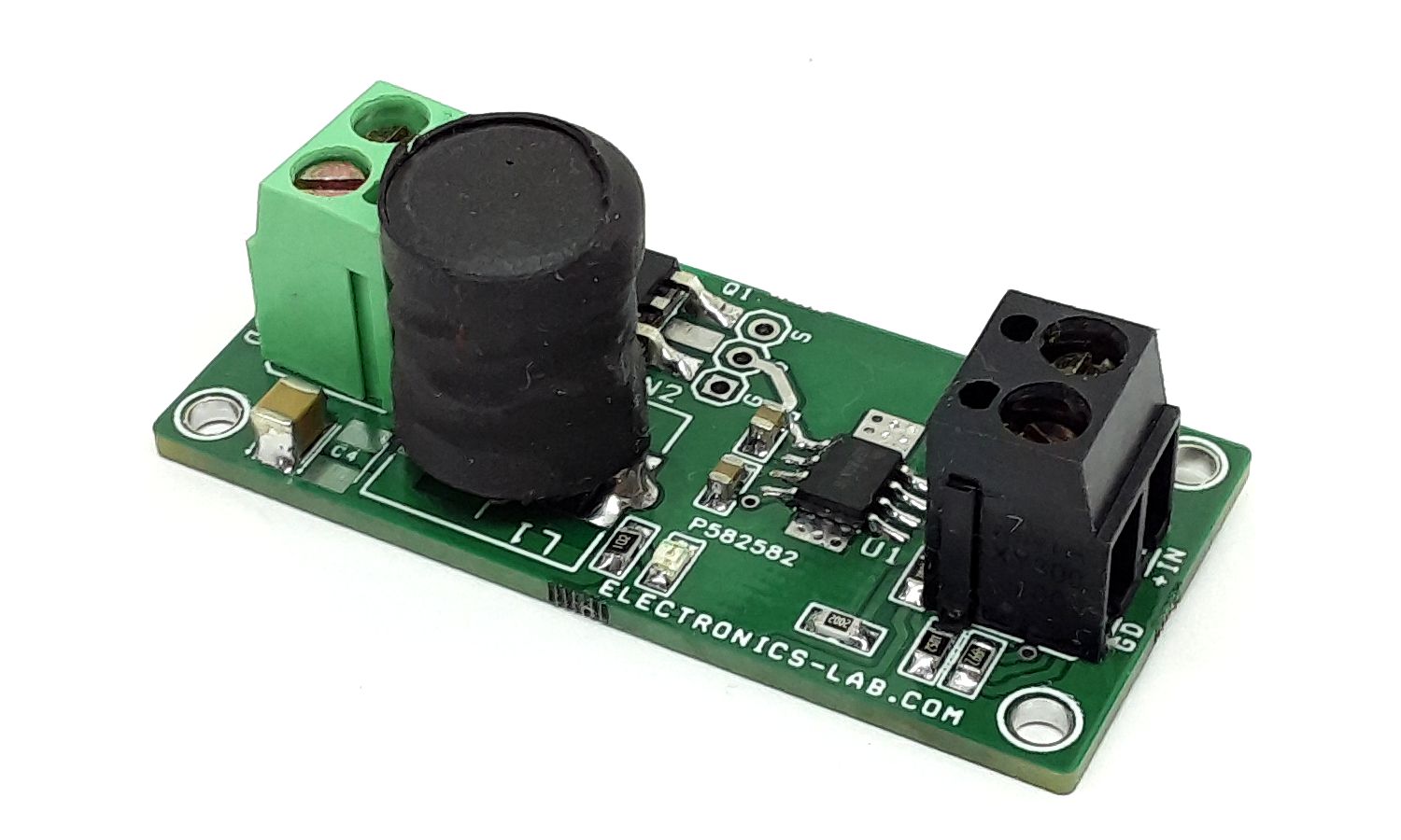

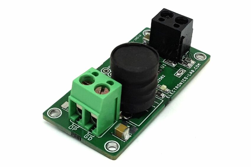

3.3V-5A Output DC-DC Converter with 10 to 24V Input

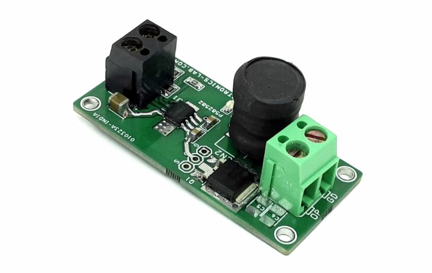

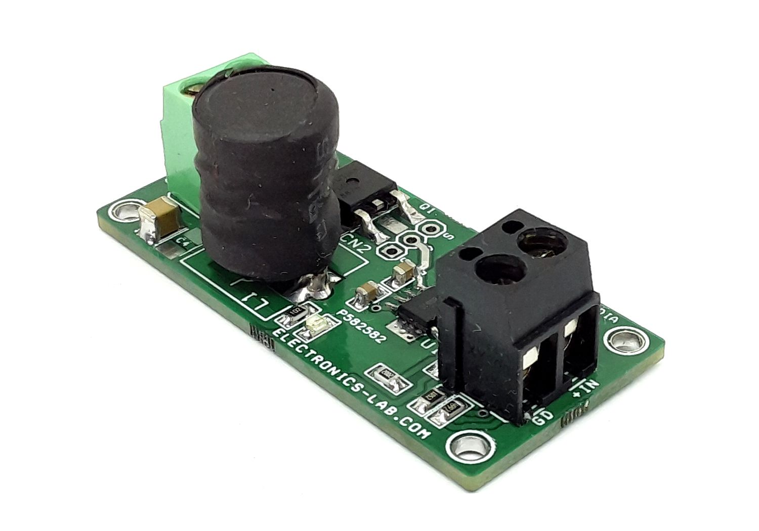

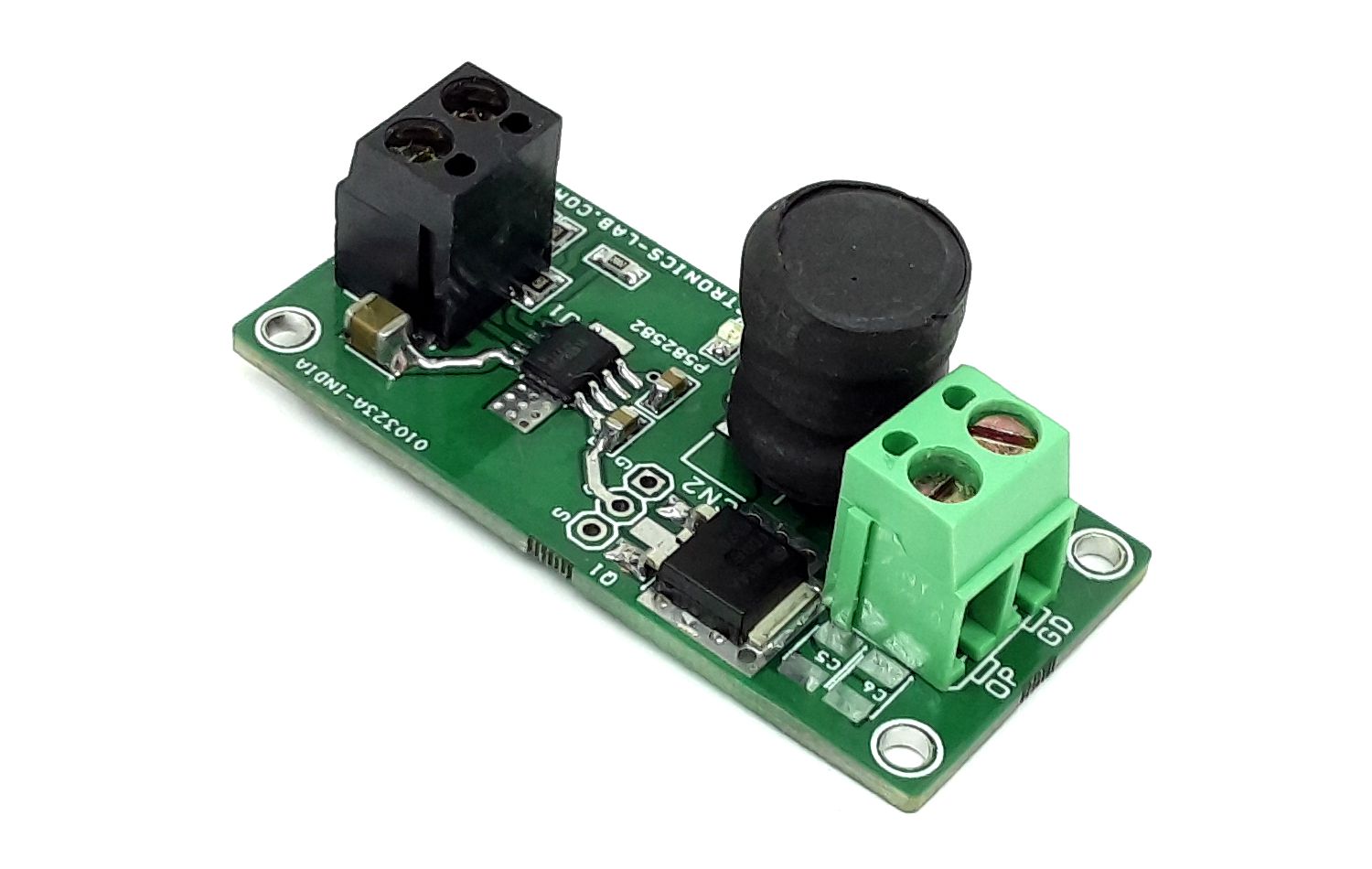

The project published here is a synchronous step-down DC/DC converter based on the RT7258 chip. The chip has integrated high-side internal power MOSFET and gate driver for a low-side external power MOSFET.
The project published here is a synchronous step-down DC/DC converter based on the RT7258 chip. The chip has integrated high-side internal power MOSFET and gate driver for a low-side external power MOSFET. The board delivers 3.3V DC – 5A output current from 10V to 24V input supply. The RT7258‘s current mode architecture allows the transient response to be optimized over a wide input voltage and load range. Cycle-by-cycle current limit provides protection against shorted outputs and softy-start eliminates input current surge during start-up.
- Supply 10V to 24V DC
- Output 3.3V DC
- Load Current 5Amps
- Current Mode Control
- Switching Frequency 600Khz
- Up to 90% Efficiency
- Cycle-by-cycle Current Limit
- Input Under Voltage Lockout
- Output Under Voltage Protection
- Thermal Shutdown Protection, Threshold 150°C
- Output Power LED
- 4 x 2.5mm Mounting Holes
- PCB Dimensions 51.44 x 24.13 mm

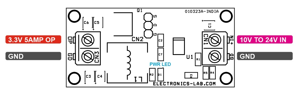

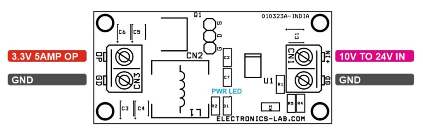

Connections
- CN1: Pin 1 = 10V to 24V DC Input, Pin 2 = GND
- CN2: Optional Connector for TO220 MOSFET
- CN3: Pin 1 = 3.3V / 5Amps Output, Pin 2 = GND
- D1: Output Power LED

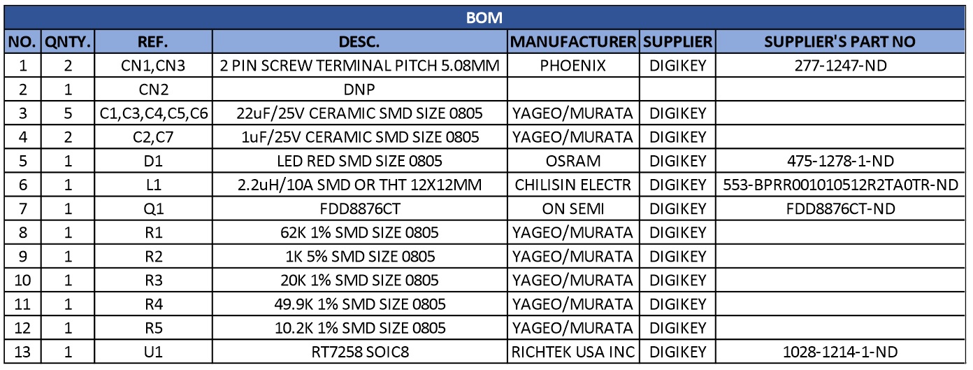

Parts List
| NO. | QNTY. | REF. | DESC. | MANUFACTURER | SUPPLIER | SUPPLIER'S PART NO |
| 1 | 2 | CN1,CN3 | 2 PIN SCREW TERMINAL PITCH 5.08MM | PHOENIX | DIGIKEY | 277-1247-ND |
| 2 | 1 | CN2 | DNP | |||
| 3 | 5 | C1,C3,C4,C5,C6 | 22uF/25V CERAMIC SMD SIZE 0805 | YAGEO/MURATA | DIGIKEY | |
| 4 | 2 | C2,C7 | 1uF/25V CERAMIC SMD SIZE 0805 | YAGEO/MURATA | DIGIKEY | |
| 5 | 1 | D1 | LED RED SMD SIZE 0805 | OSRAM | DIGIKEY | 475-1278-1-ND |
| 6 | 1 | L1 | 2.2uH/10A SMD OR THT 12X12MM | CHILISIN ELECTR | DIGIKEY | 553-BPRR001010512R2TA0TR-ND |
| 7 | 1 | Q1 | FDD8876CT | ON SEMI | DIGIKEY | FDD8876CT-ND |
| 8 | 1 | R1 | 62K 1% SMD SIZE 0805 | YAGEO/MURATA | DIGIKEY | |
| 9 | 1 | R2 | 1K 5% SMD SIZE 0805 | YAGEO/MURATA | DIGIKEY | |
| 10 | 1 | R3 | 20K 1% SMD SIZE 0805 | YAGEO/MURATA | DIGIKEY | |
| 11 | 1 | R4 | 49.9K 1% SMD SIZE 0805 | YAGEO/MURATA | DIGIKEY | |
| 12 | 1 | R5 | 10.2K 1% SMD SIZE 0805 | YAGEO/MURATA | DIGIKEY | |
| 13 | 1 | U1 | RT7258 SOIC8 | RICHTEK USA INC | DIGIKEY | 1028-1214-1-ND |
