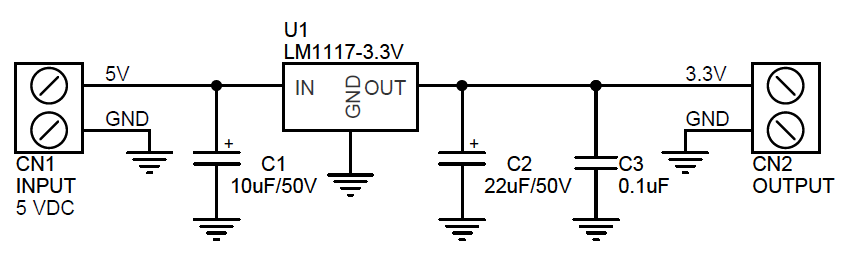

This project is a 3.3V Voltage Regulator
Description
This project  will provide 3.3 V @ 800 mA DC Regulated Supply.  The project is based on the LM1117 Low-Dropout Linear Regulator. The LM1117-3.3 is a low dropout voltage regulator with a dropout of 3.3V @ 800mA of load current.
Specifications
  • Input – 5 to 15 VDC
  • Output Current/Voltage 0<Iout<800mA, 4.75V<Vin<12V
  • Output – 3.3 V @ 800 mA regulated low ripple DC voltage
  • Current limiting and Thermal shutdown circuit protection (provided by IC feature)
  • Filter capacitors for low ripple DC output

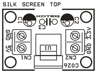

  • Power Battery Terminal (PBT) for easy connection of input and output
  • Four mounting holes of 3.2 mm each
  • PCB dimensions 34.29 x 23.34mm
Schematic
SCHEMATIC

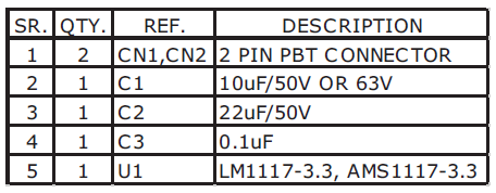

Parts List
BOM

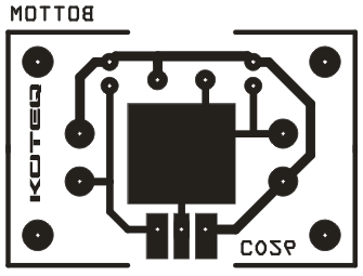

Gerber View

sir i want to know, can i change the capasitor ? thanks

Where is the gerber file?
