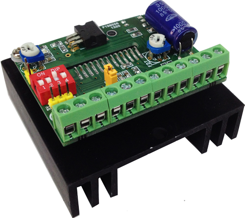

4A Bipolar Stepper Motor Driver Based on LV8727E
The Project is based on LV8727E IC from ON Semiconductor. The LV8727 is a PWM current-controlled micro step bipolar stepping motor driver.
4A_BIPOLAR_STEPPER_MOTOR_DRIVER_LV8727E_M040A
The Project is based on LV8727E IC from ON Semiconductor. The LV8727 is a PWM current-controlled micro step bipolar stepping motor driver. This driver can provide eight ways of micro step resolution of 1/2, 1/8, 1/16, 1/32, 1/64, 1/128, 1/10, 1/20, and can drive simply by the step input. This Bipolar Driver works with supply input 9V to 36V (Replace L317 with L317HVT for supply input up to 45V DC). Load current up to 4Amps.
  • Supply 9V to 36V DC (Replace L317 with L317HVT for Supply up to 45VDC)
  • Load Current Up to 4Amps
  • Inputs:  Step Pulse, Direction, Enable
  • Micro-Stepping: 4 Way DIP Slide Switch
  • On Board Power Indication
  • On Board L317 for 5V DC Regulator
  • Current Adjust Preset
  • Over Current protection
  • Thermal Shutdown
  • FDT Adjust Preset (DECAY Setting)
  • Single-Channel PWM current control stepping motor driver.
  • Output Current 4Amps
  • Micro Stepping 1/2,1/8,1/16,1/32,1/64,1/128,1/10,1/20 Step are selectable.
  • Advance the excitation step with the only step signal input

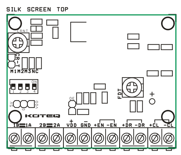

CN8 : 3Pin Header Connector
Auxiliary Power output 5V DC, GND, VDD-Supply Voltage
CN7 : 2 Pin Header Connector
Current Test (Voltage)

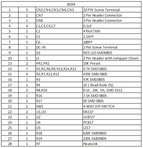

Parts List
4A_BIPOLAR_STEPPER_MOTOR_DRIVER_LV8727_BOM

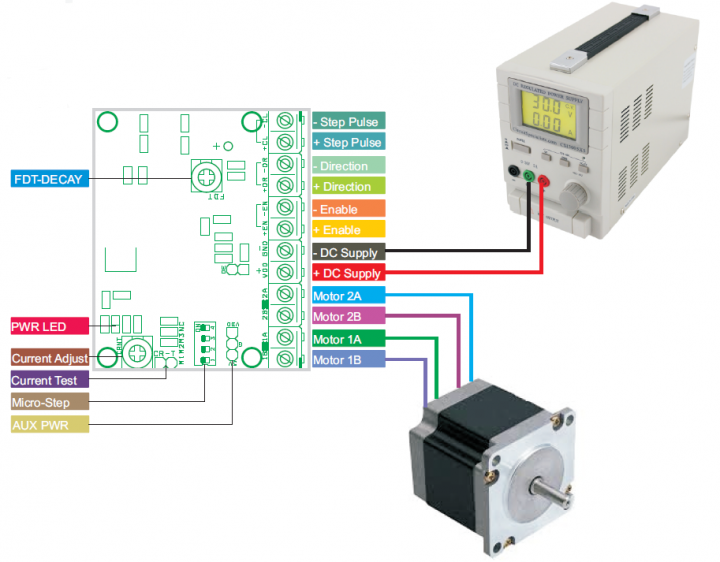

Connections
4A_BIPOLAR_STEPPER_MOTOR_DRIVER_LV8727E_CON

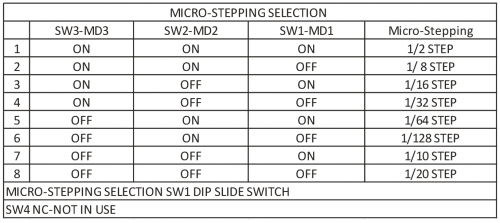

Micro-Stepping Selection
4A_BIPOLAR_STEPPER_MOTOR_DRIVER_LV8727E_MICRO_STEP_SETTING_TABLE

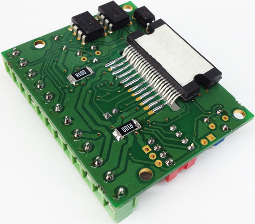

Photos
4A_BIPOLAR_STEPPER_MOTOR_DRIVER_LV8727E_M040B
4A_BIPOLAR_STEPPER_MOTOR_DRIVER_LV8727E_M040C
