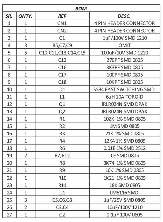

50V to 5V @7A Synchronous Buck (Step-down) Converteri am from Pakistan And i am PCB designer work at home design suit easy-Eda online easy-PC v15 and others i like your All Synchronous Buck (Step-down) Converter.Please Help me send value 50V to 5V @7A component list R5,C7,C9 and not found EASY EDA 6UH 10A torrid inductor coil
