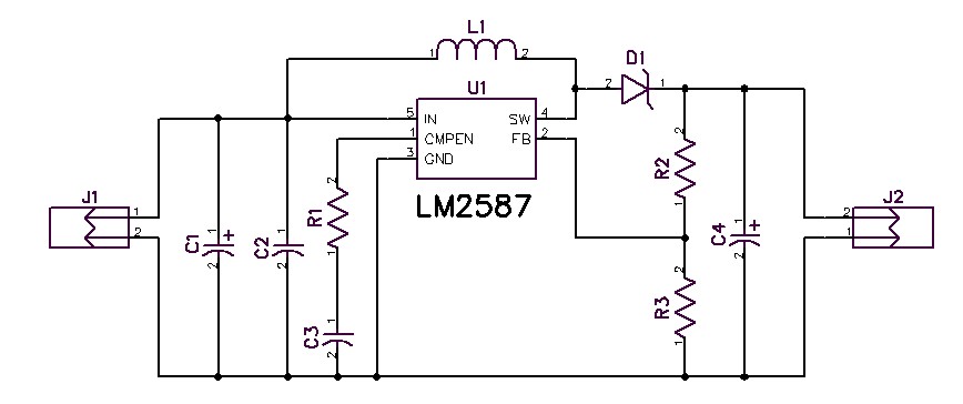

This circuit is based on LM2587, a simple boost converter from Texas instruments. It produces a 12V regulated output for a input of 5V.
Power by mixos

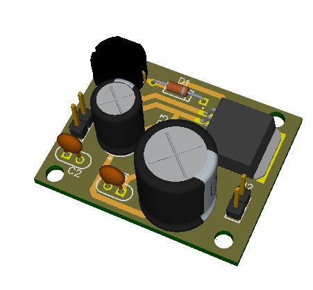

This circuit is based on LM2587, a simple boost converter from Texas instruments. It produces a 12V regulated output for a input of 5V. It can also be used as a multiple output regulator, forward converter and as a flyback regulator. This regulator requires minimum number of external components, which makes it cost effective.
  • Input(V): 4.5VDC to 5.5VDC
  • Output(V): 12V DC
  • Output load: 1.2A
  • PCB:38mm X 30mm
Schematic
