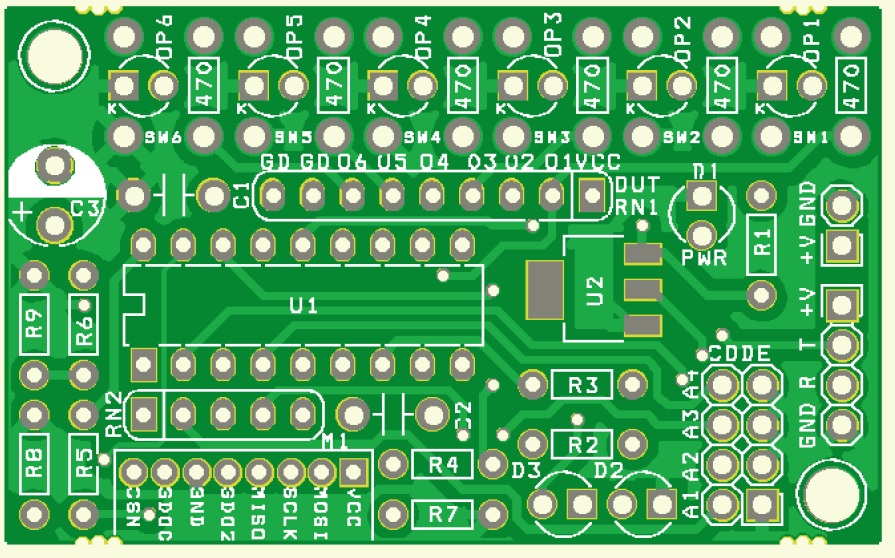

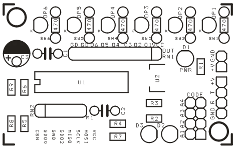

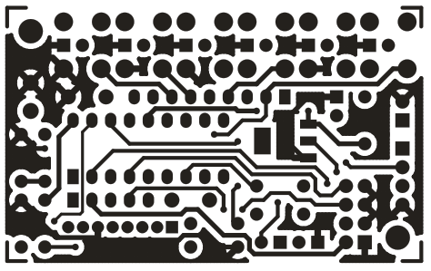

The 6 Channel RF Remote Controller designed using CC2500 RF Transceiver modules and PIC16F1847 micro-controller from microchip. Transmitter provided with 6 tact switch, 4 Address Jumpers to pair multiple unit so they don’t interfere with each other.
The 6 Channel RF Remote Controller designed using CC2500 RF Transceiver modules and PIC16F1847 micro-controller from microchip. Transmitter provided with 6 tact switch, 4 Address Jumpers to pair multiple unit so they don’t interfere with each other. Board provided with power LED, valid transmission LED. Project works with 5 V DC, On board LM1117-3.3V regulator for CC2500 Module.  Two in one PCB can be used as Transmitter & Receiver.
Receiver works with 5V DC. 4 Jumper to paring RX& TX units, valid signal LED, power LED, and 9 Pin connector for outputs.  Same PCB is used as transmitter and receiver.  All outputs are Latch Type and TTL 5V Signal for easy interface with other devices like Relay Boards, Solid State Relays.

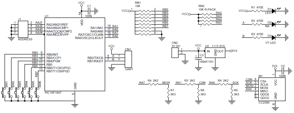

Features Transmitter
  • Supply Transmitter 5V DC
  • 4 Jumpers for Address Setting
  • 16 Remote can be used as same time with 4 Jumpers
  • 2 Pin Header Connector for Supply Input
  • Power LED
  • Transmission LED

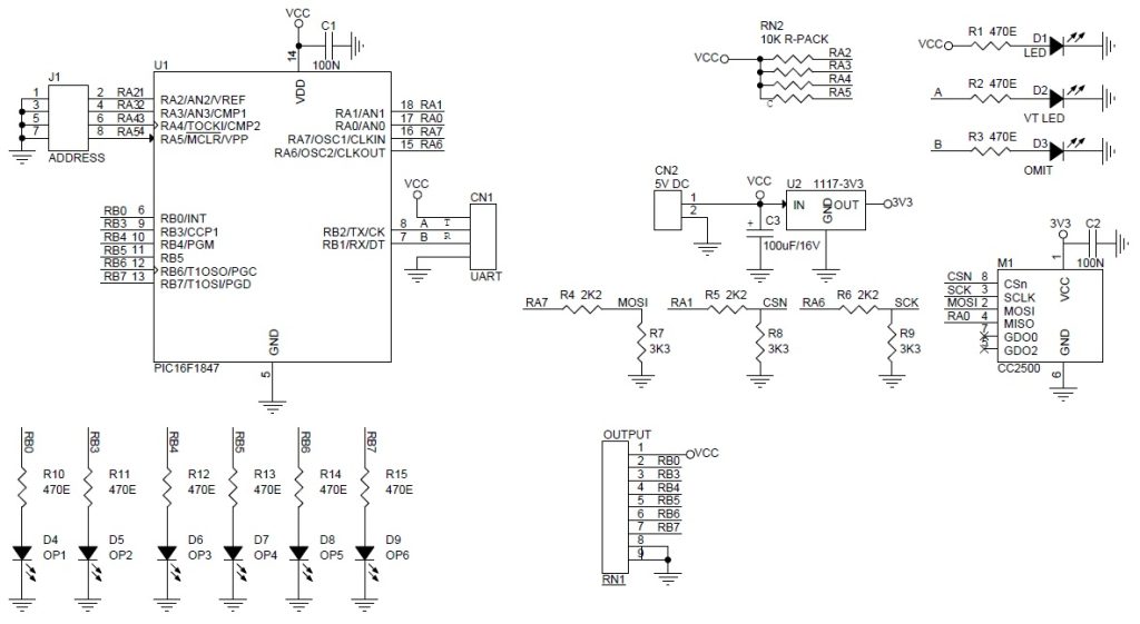

Features Receiver
  • Power LED
  • Valid Signal Receive LED
  • 9 Pin Header Connector for Outputs
  • 5V TTL Outputs
  • Latch Output
Transmitter Schematic
Receiver Schematic
