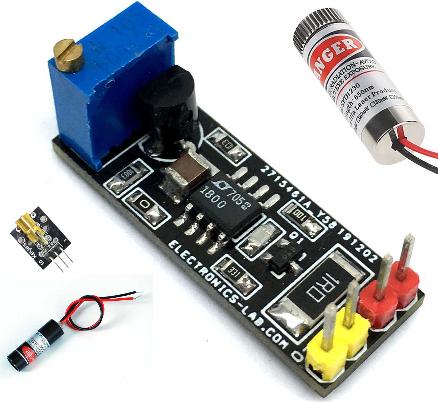

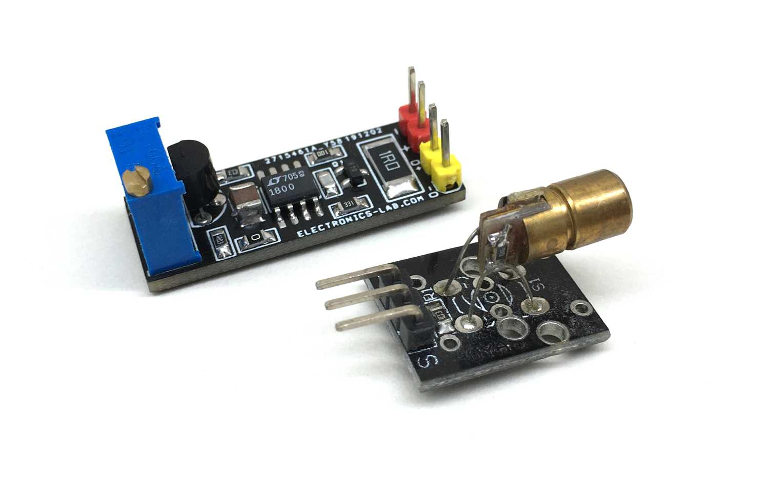

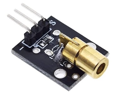

I was testing a couple of low-cost laser diodes that come from china and I was wondering why those diodes don’t have any protection/driver circuitry. Those diodes come with a simple series resistor for current control which is not a good idea nor stable.

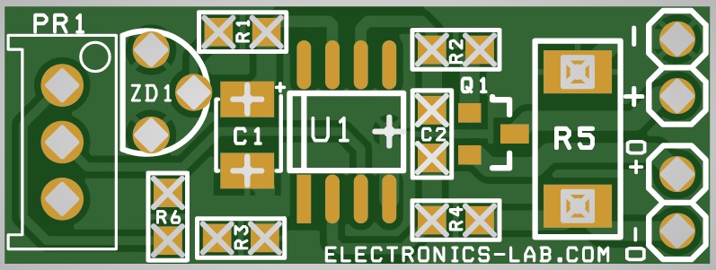

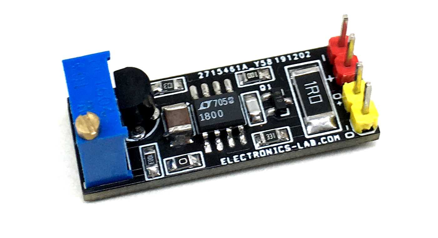

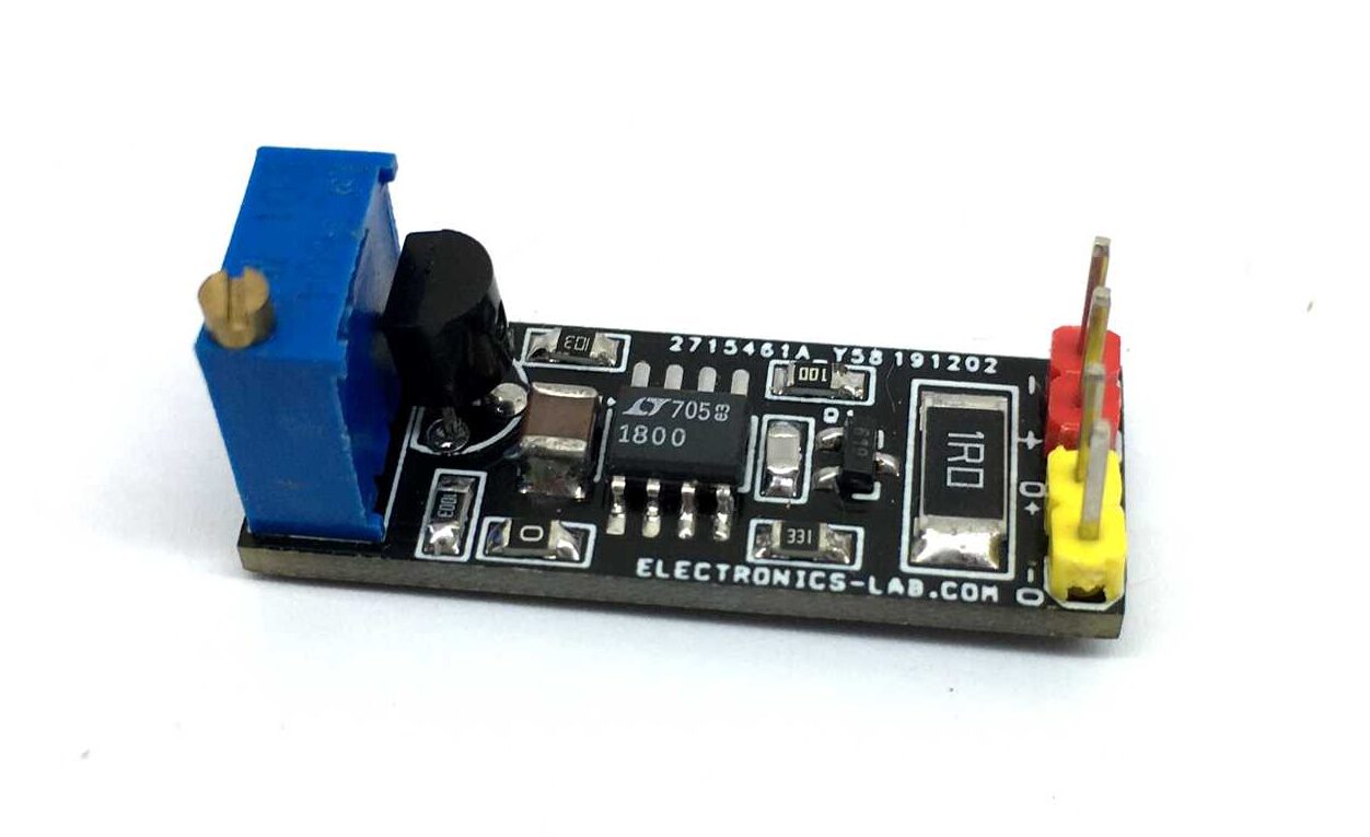

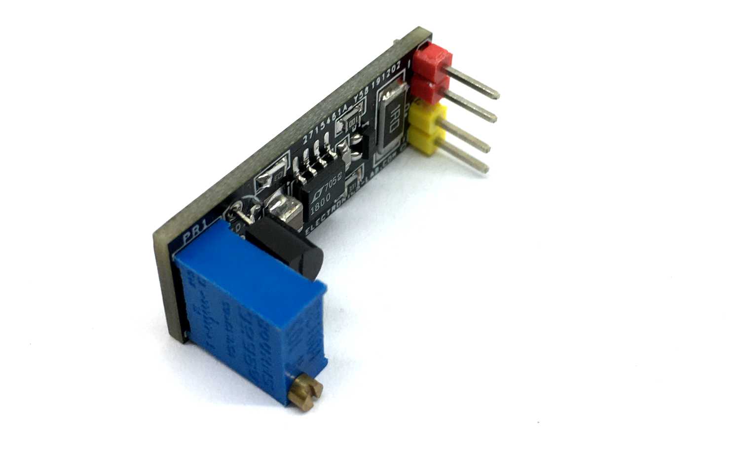

I was testing a couple of low-cost laser diodes that come from china and I was wondering why those diodes don’t have any protection/driver circuitry. Those diodes come with a simple series resistor for current control which is not a good idea nor stable. Laser diodes are harmful and should have some sort of constant current circuit as a basic protection for the laser diode. As result, I built this circuit which provides highly accurate current control.  The module is a great tool to drive low-cost laser diodes with superb accuracy. This circuit can drive diode starting from 0 mA to 115mA, usually, these cheap diodes require around 30mA current. The project has an onboard multi-turn potentiometer to adjust the output current with great accuracy. It is advisable to turn the trim-pot to zero level and then hook-up the laser diode.

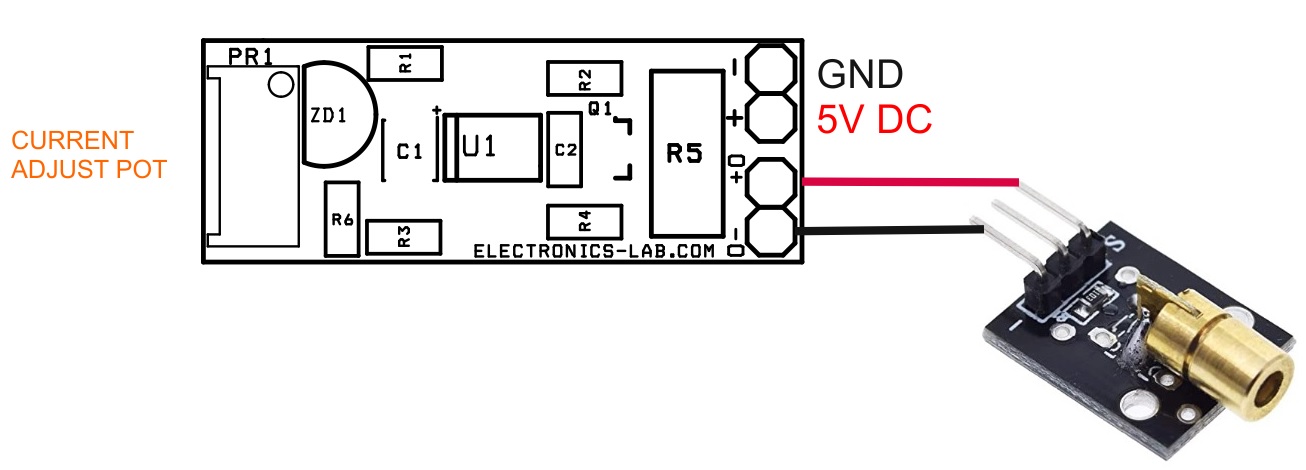

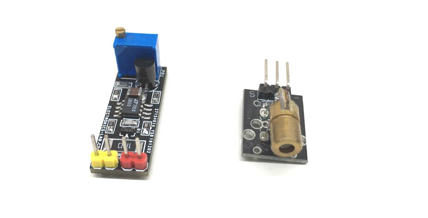

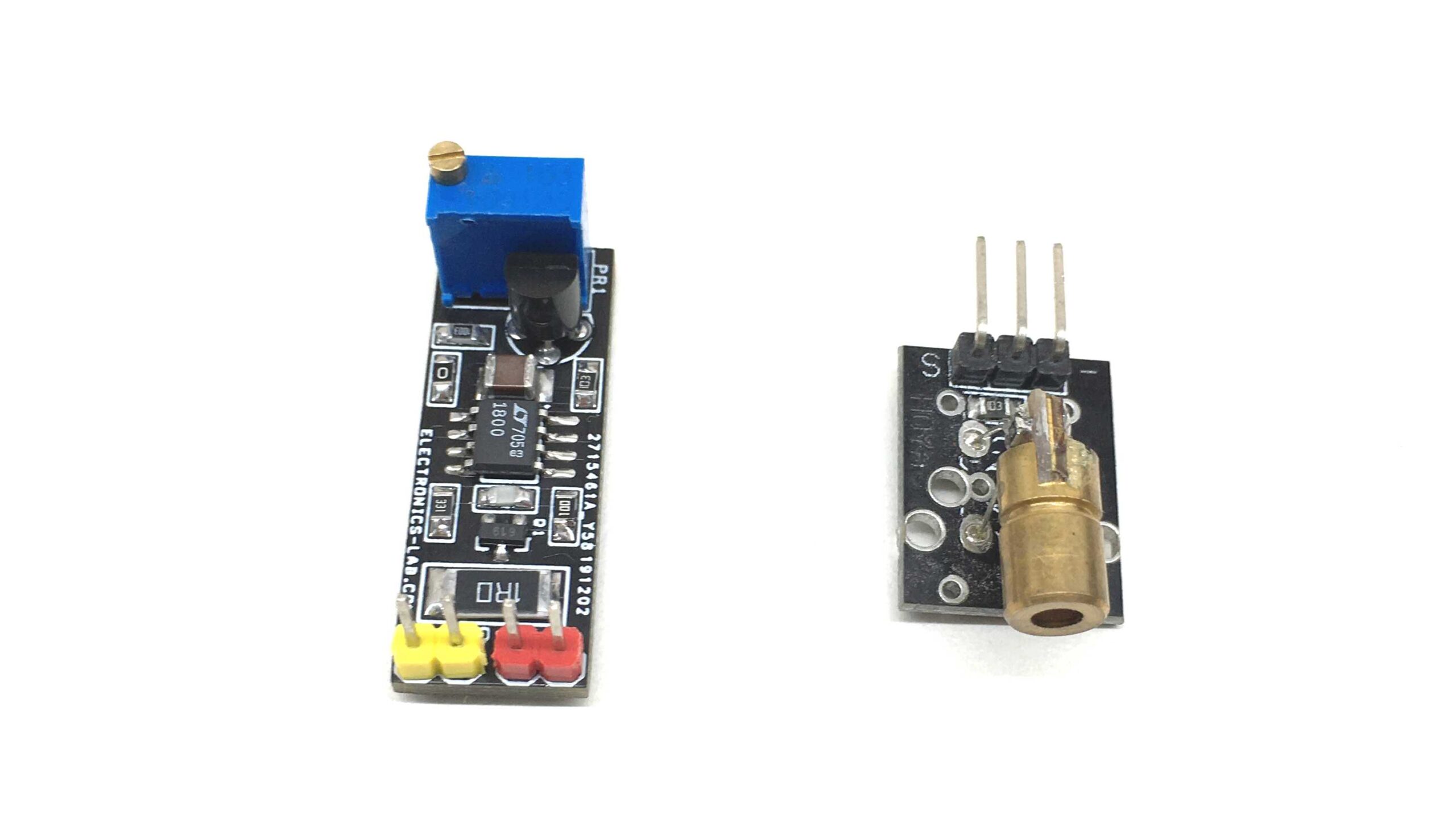

To test a diode with this circuit is very easy, the first step is to set the trim-pot to 0 level (fully turned CCW), power the board with 5V DC, check the voltage on the centre pin of trim-pot it should be 0 Volt, then connect the laser diode with a current meter in series, slowly turn the trim-pot Clockwise to set the current as per requirement.  Cheap laser diodes take approx. 30mA current.
The driver can also be used to drive LEDs, operating voltage of this circuit is 5V DC, and maximum load 115mA. Project built using LT1800 precision op-amp.

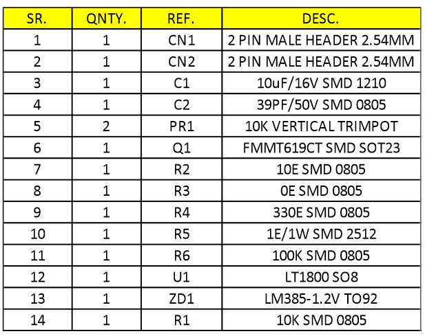

Parts List
