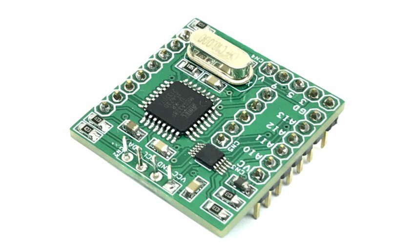

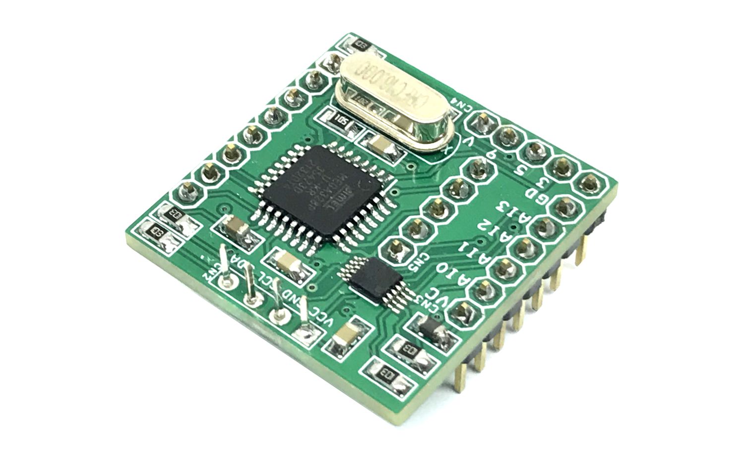

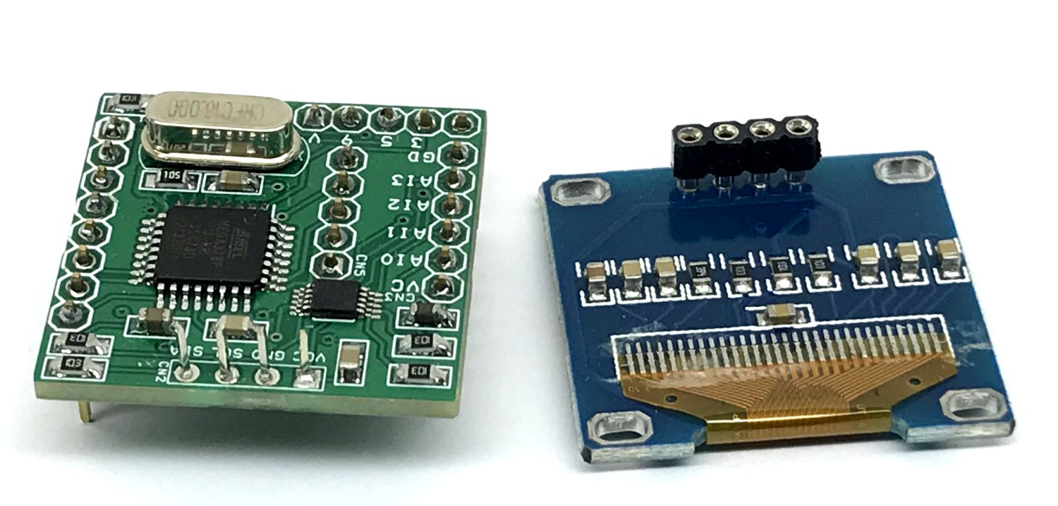

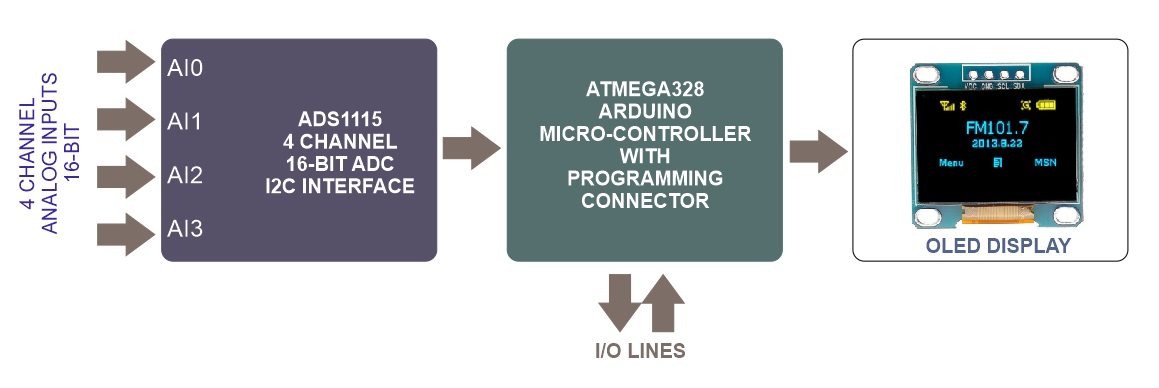

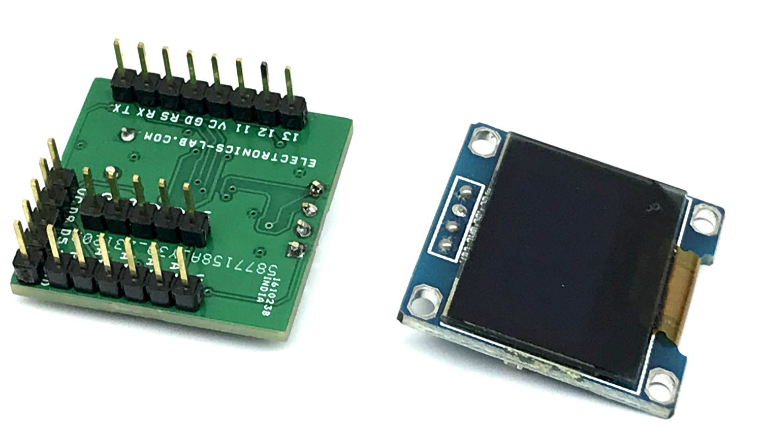

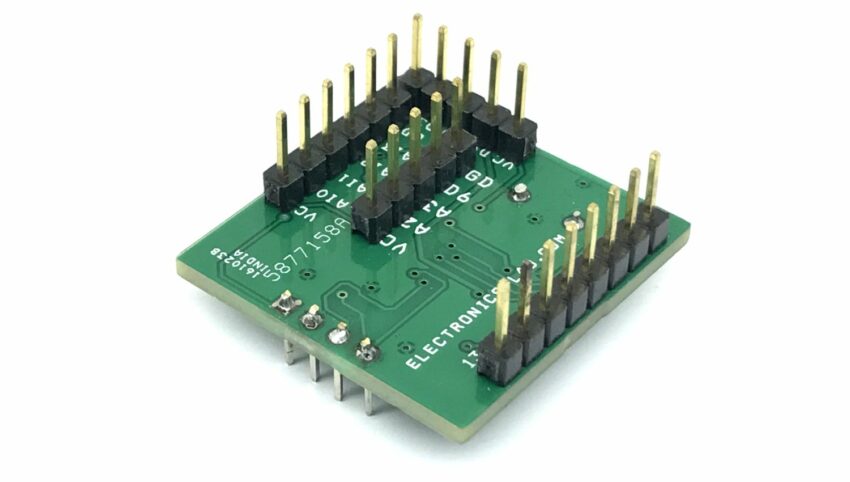

This board consists of Arduino-compatible hardware which includes an OLED display, ADS1115 4-Channel 16Bit ADC, Arduino-compatible Microcontroller ATMEGA328, a connector for Arduino Programming, a connector for 4 Channel Analog input, and a connector for a couple of I/O lines. Operating supply 5V DC.
The ADS1115 device is a precision, low-power, 16-bit, I2C-compatible, analog-to-digital converter (ADCs). It incorporates a low-drift voltage reference and an oscillator. The ADS1115 also incorporates a programmable gain amplifier (PGA) and a digital comparator. These features, along with a wide operating supply range, make the ADS1115 well-suited for power- and space-constrained, sensor measurement applications.
The ADS1115 performs conversions at data rates of up to 860 samples per second (SPS). The PGA offers input ranges from ±256 mV to ±6.144 V, allowing precise large- and small-signal measurements. The ADS1115 features an input multiplexer (MUX) that allows two differential or four single-ended input measurements. Use the digital comparator in ADS1115 for under and overvoltage detection.
The ADS1115 operates in either continuous-conversion mode or single-shot mode. The devices are automatically powered down after one conversion in single-shot mode; therefore, power consumption is significantly reduced during idle periods.
- Supply 5V DC

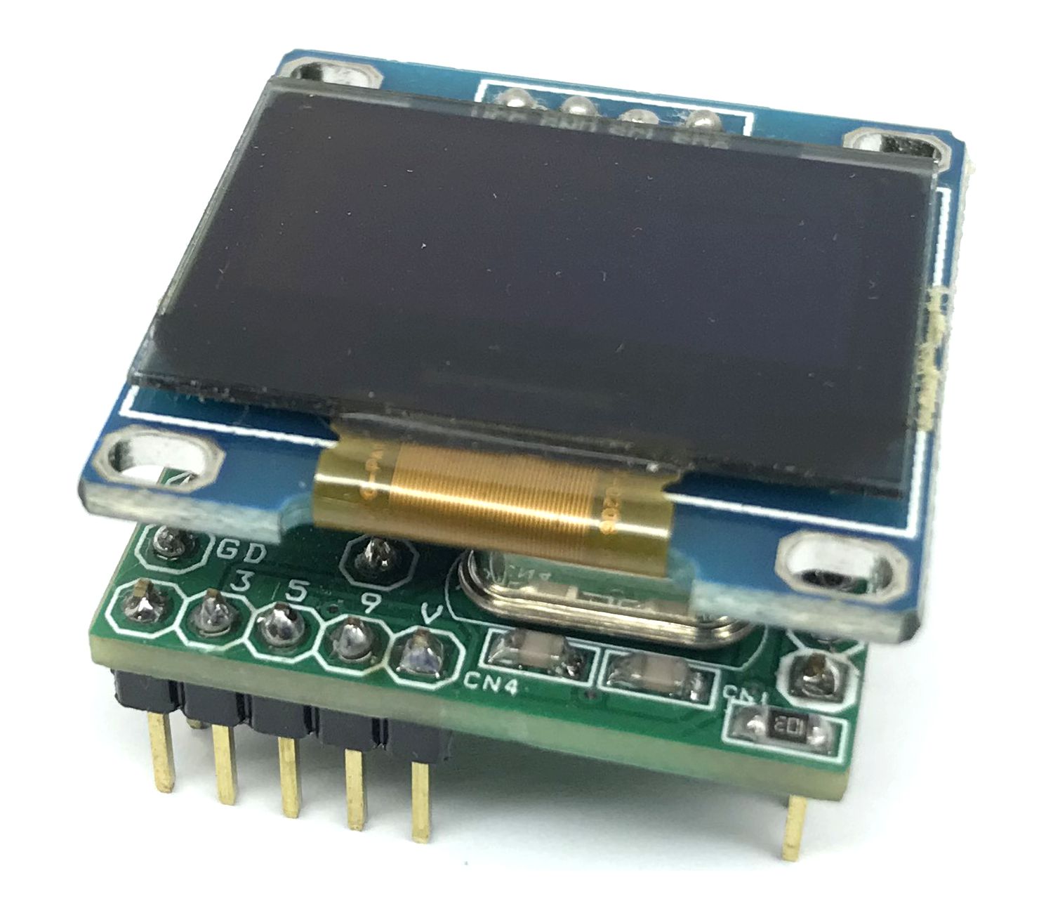

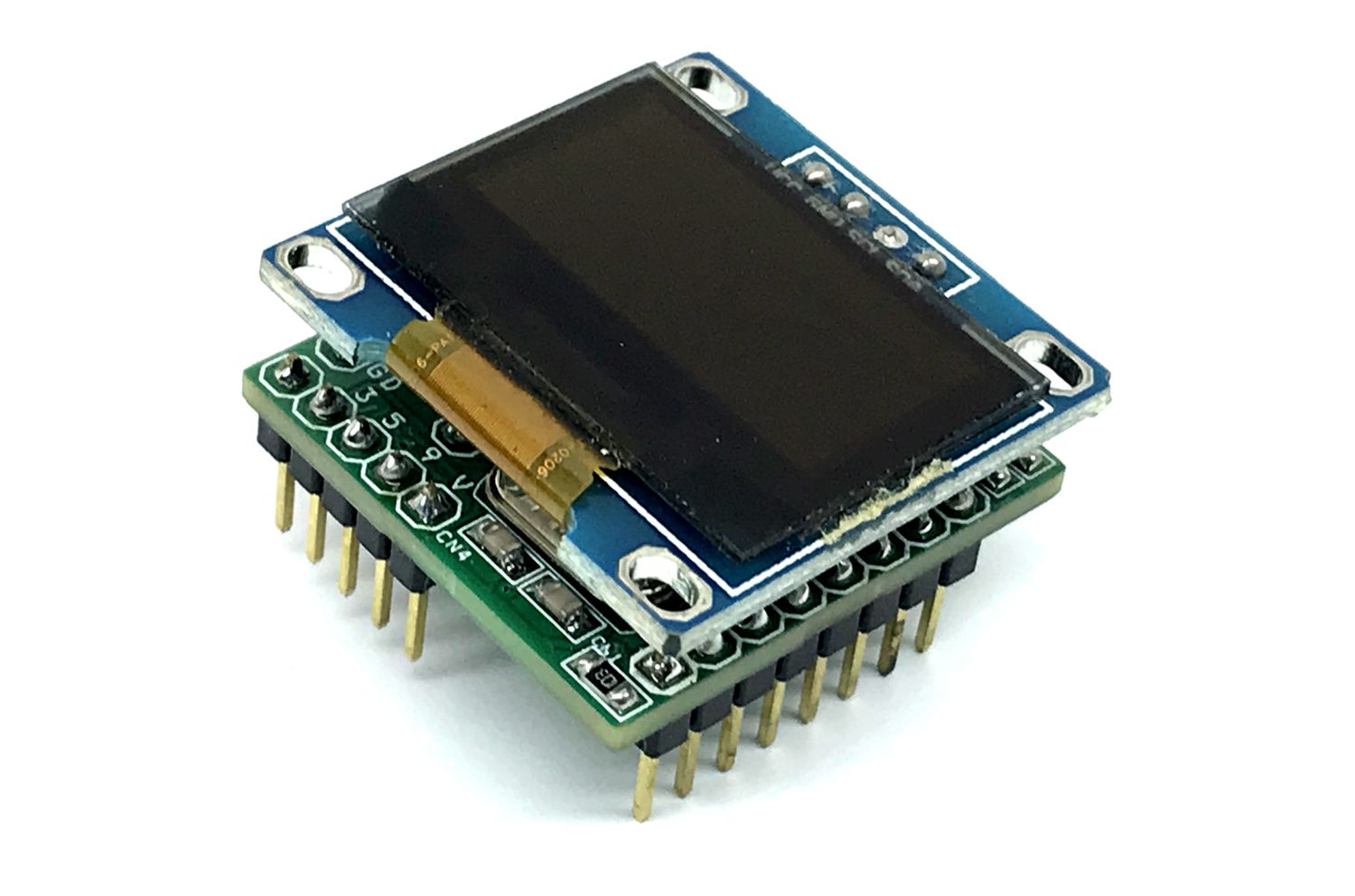

- Supports 0.96Inch OLED Display with I2C
- 4 Channel ADC (2 Differential Inputs or 4 Single-Ended Inputs
- Header Connector for Arduino Programming
- Header Connector for 4 Channel Analog Inputs and Power Supply
- Header Connector for Extra I/O Lines

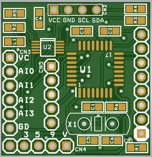

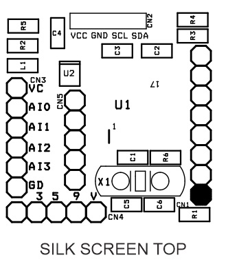

- Compact PCB Same Size as OLED Display
- PCB Dimensions 27.62 x 26.83 mm

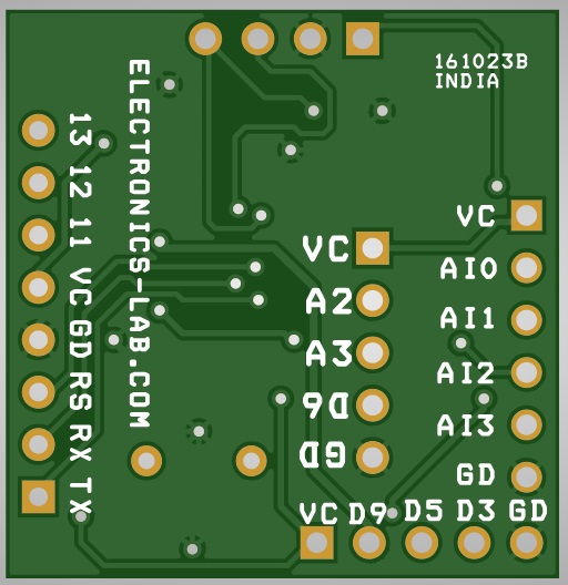

Connections

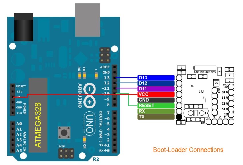

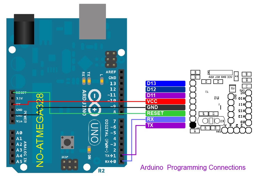

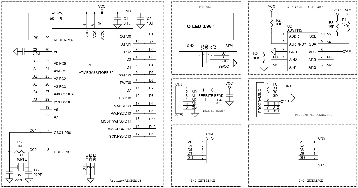

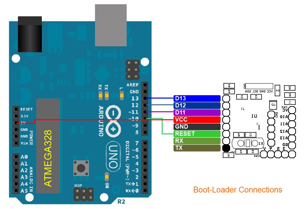

- CN1: Pin 1 TX, Pin 2 RX, Pin 3 Reset, Pin 4 GND, Pin 5 VCC, Pin 6 D11, Pin 7 D12, Pin 8 D13
- CN2: Pin 1 VCC, Pin 2 GND, Pin 3 SLA, Pin 4 SDA (OLED Display)
- CN3: Pin 1 VCC, Pin 2 Analog Input 0, Pin 3 Analog Input 1, Pin 4 Analog Input 2, Pin 5 Analog Input 3, Pin 6 GND
- CN4: Pin 1 VCC, Pin 2 D9, Pin 3 D5, Pin 4 D3, Pin 5 GND
- CN5: Pin 1 VCC, Pin 2 A2, Pin 3 A3, Pin 4 D6 Pin 5 GND
Schematic

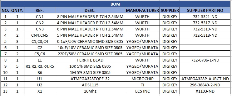

Parts List
| NO. | QNTY. | REF. | DESC. | MANUFACTURER | SUPPLIER | SUPPLIER PART NO |
| 1 | 1 | CN1 | 8 PIN MALE HEADER PITCH 2.54MM | WURTH | DIGIKEY | 732-5321-ND |
| 2 | 1 | CN2 | 4 PIN MALE HEADER PITCH 2.54MM | WURTH | DIGIKEY | 732-5317-ND |
| 3 | 1 | CN3 | 6 PIN MALE HEADER PITCH 2.54MM | WURTH | DIGIKEY | 732-5319-ND |
| 4 | 2 | CN4,CN5 | 5 PIN MALE HEADER PITCH 2.54MM | WURTH | DIGIKEY | 732-5318-ND |
| 5 | 3 | C1,C3,C4 | 0.1uF/50V CERAMIC SMD SIZE 0805 | YAGEO/MURATA | DIGIKEY | |
| 6 | 1 | C2 | 10uF/10V CERAMIC SMD SIZE 0805 | YAGEO/MURATA | DIGIKEY | |
| 7 | 2 | C5,C6 | 22PF/50V CERAMIC SMD SIZE 0805 | YAGEO/MURATA | DIGIKEY | |
| 8 | 1 | L1 | FERRITE BEAD | WURTH | DIGIKEY | 732-6706-1-ND |
| 9 | 5 | R1,R2,R3,R4,R5 | 10K 5% SMD SIZE 0805 | YAGEO/MURATA | DIGIKEY | |
| 10 | 1 | R6 | 1M 5% SMD SIZE 0805 | YAGEO/MURATA | DIGIKEY | |
| 11 | 1 | U1 | ATMEGA328TQPF-32 | MICROCHIP | DIGIKEY | ATMEGA328P-AURCT-ND |
| 12 | 1 | U2 | ADS1115 | TI | DIGIKEY | 296-38849-2-ND |
| 13 | 1 | X1 | 16Mhz | ECS INC | DIGIKEY | X1103-ND |

Block Diagram
Arduino Programming
