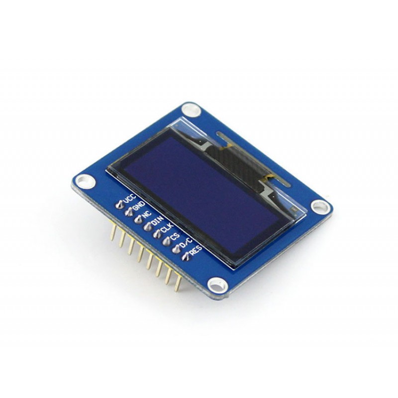

At the center of today’s project is the DHT11 temperature and humidity sensor, and the OLED Display. OLED (Organic light-emitting diode) displays are made of light-emitting diodes (LED) in which the emissive electroluminescent layer is made up of a film of organic compound that emits light in response to an electric current. For this tutorial, we will use the 1.3″ OLED Display from Waveshare. The display is monochrome blue in color, has a resolution of 128×64 pixels and communicates over 4 wire SPI or I2C. It is low power as it only consumes 0.04W of energy which is one-tenth of what is required to power a 16×2 LCD display.
1.3″ OLED display

  2. 128×64 / 1.3″ OLED Display

As usual, a pin-map showing how the components are connected to one another, pin to pin, is described below.
OLED  – Arduino
VCC - 5v
GND - GND
DIN - D13
CLK - D11
RES - D8
D/C - D9
CS - D10
