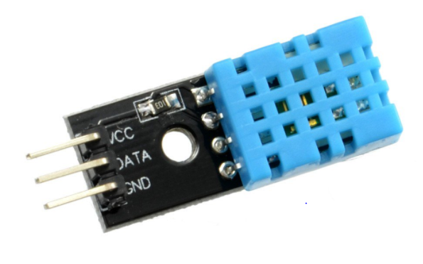

The DHT11 is something we are familiar with, it has been used in couple of our tutorials here as a low cost temperature and humidity sensor that operates using the 1-wire protocol. It costs about $2 and you can get it here.
DHT11 Temperature and Humidity Sensor
The readings from this sensor are fairly accurate, so we will be using this sensor to only measure humidity since the BMP180 gives more accurate temperature readings.
This sensor has three pins, the first which is the power pin VCC, next pin which is the middle one, which is the signal out or DATA pin and lastly the ground pin labelled GND.

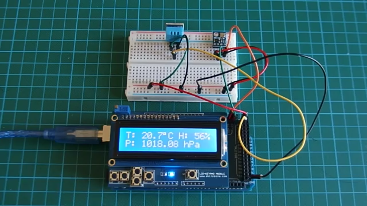

Demo
After uploading the code to your Arduino, You should see something like the Image shown below.
Demo
Worked right? Yea!!.

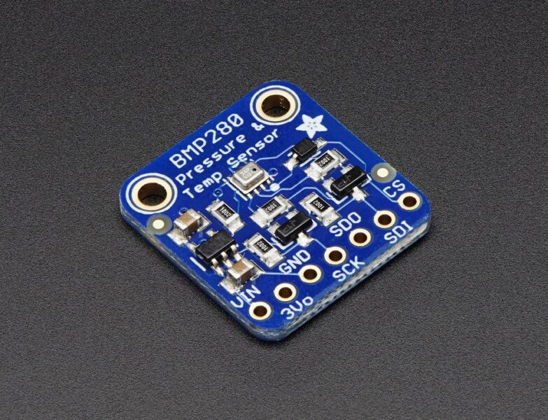

Can I use in this code in BMP280 sensor?
