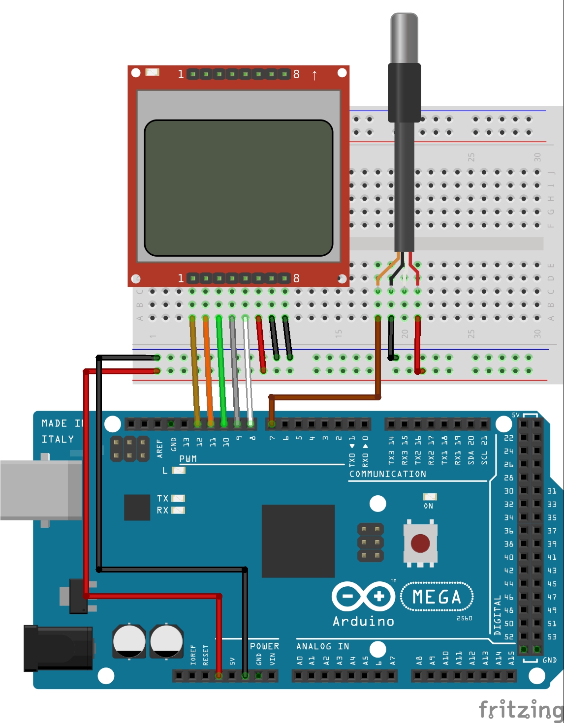

Schematics
Connect all the components as shown in the schematics below.
For clarity, the pin connections are also described below.
DS18b20 – Arduino Mega
VCC - 3.3v
GND - GND
SIG - D7
The other part of the schematic is only needed by those who have the Nokia 5110 display.
Nokia 5110 – Arduino
Display - Arduino
Pin 1(RST) – D12
Pin 2(CE) – D11
Pin 3(DC) – D10
Pin 4(DIN) – D9
Pin 5(CLK) – D8
Pin 6(VCC) - VCC
Pin 7(LIGHT) - GND
Pin 8(GND) - GND
