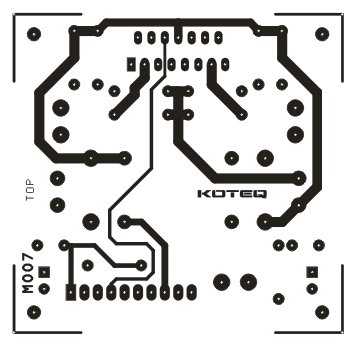

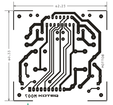

  •  Four mounting holes of 3.2 mm each
  •  PCB dimensions 61 mm x 63 mm

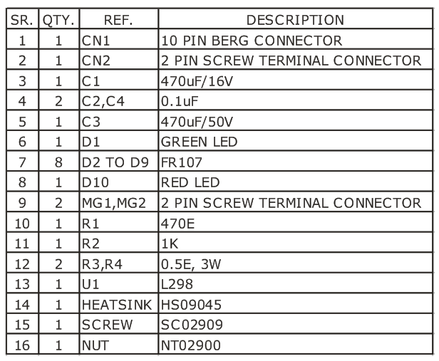

Parts List
BOM

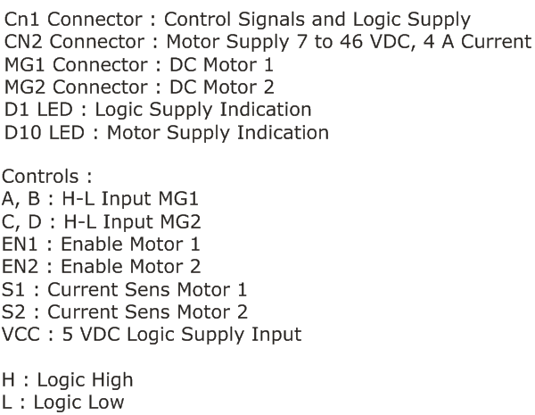

Connections
Connections
