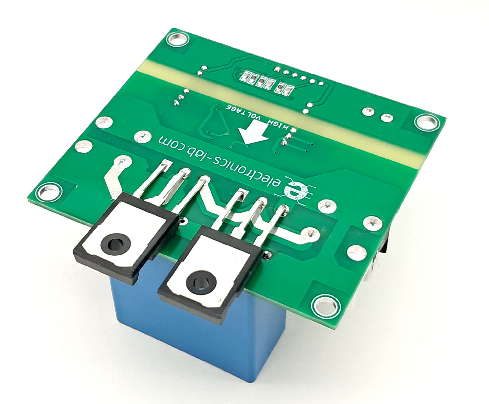

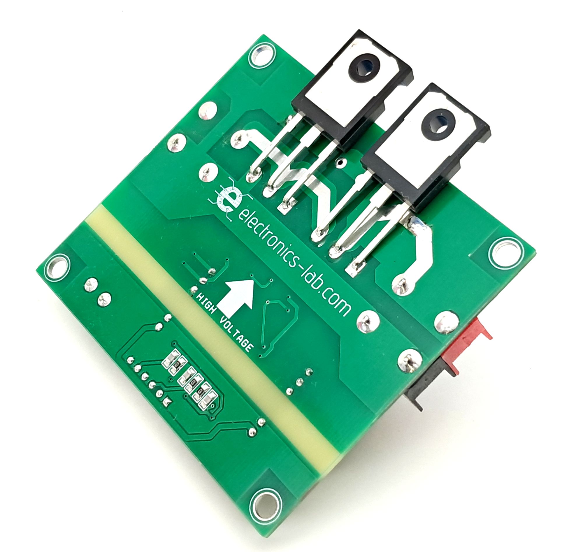

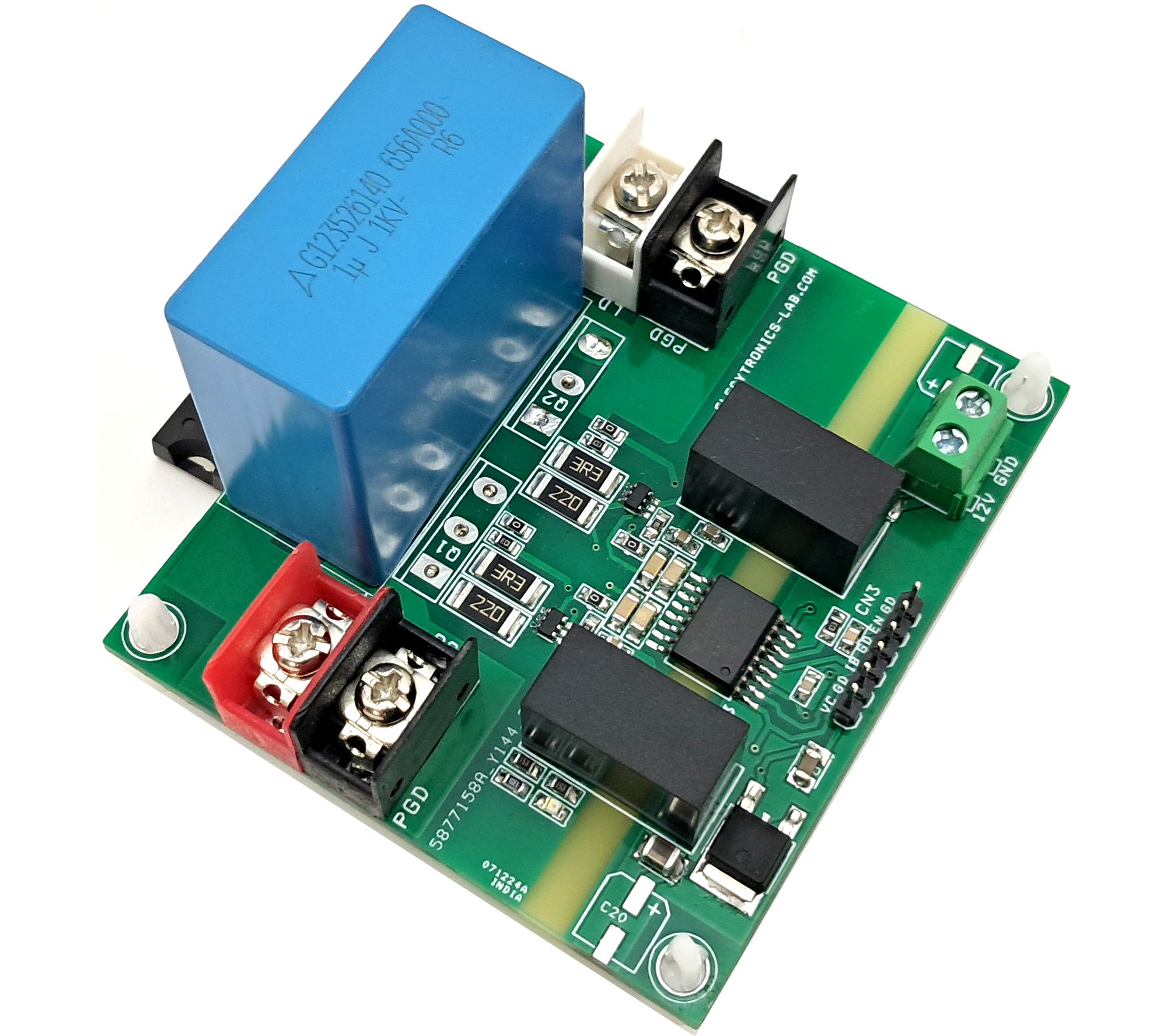

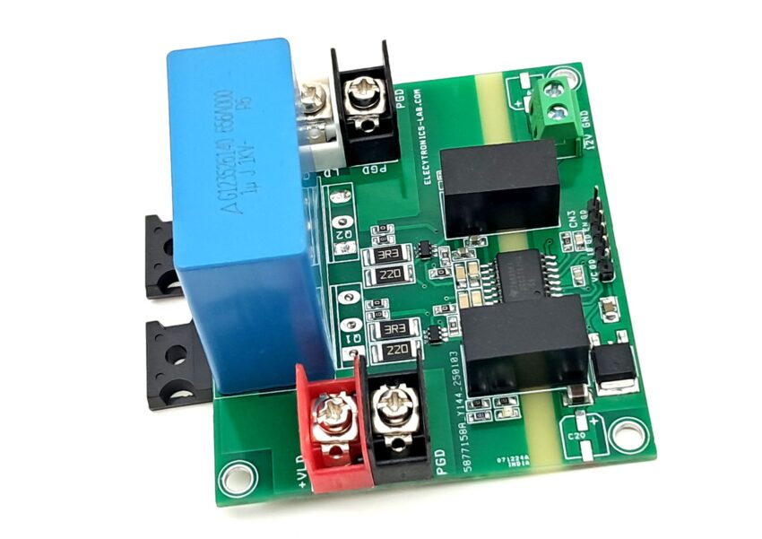

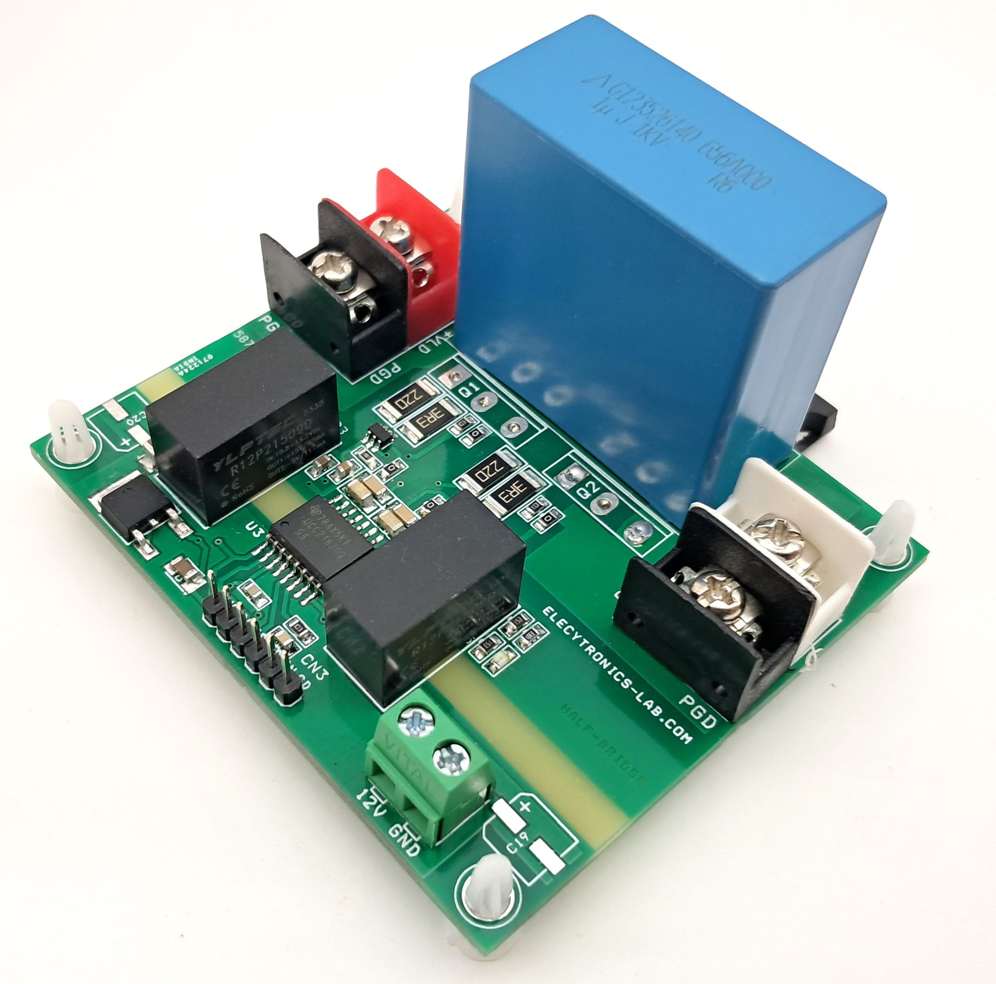

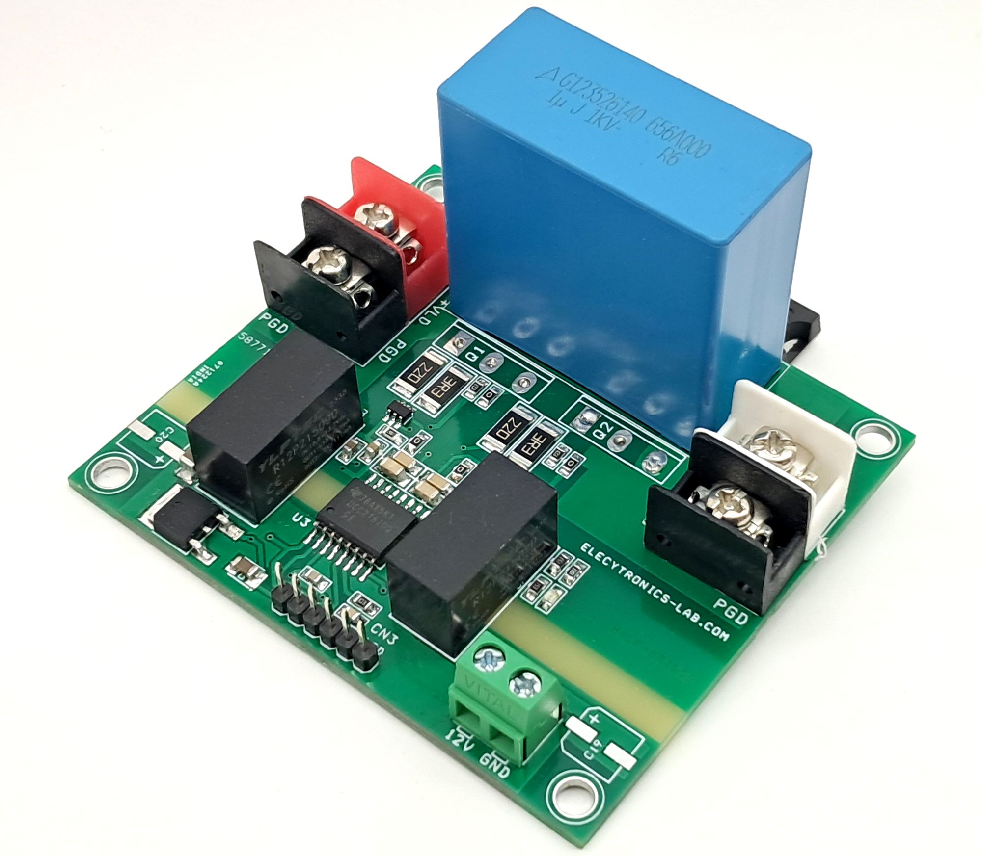

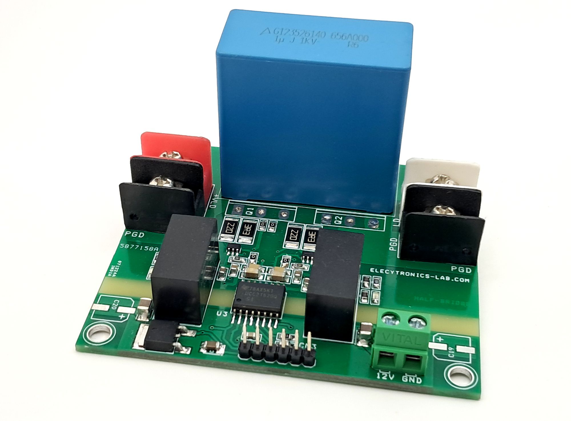

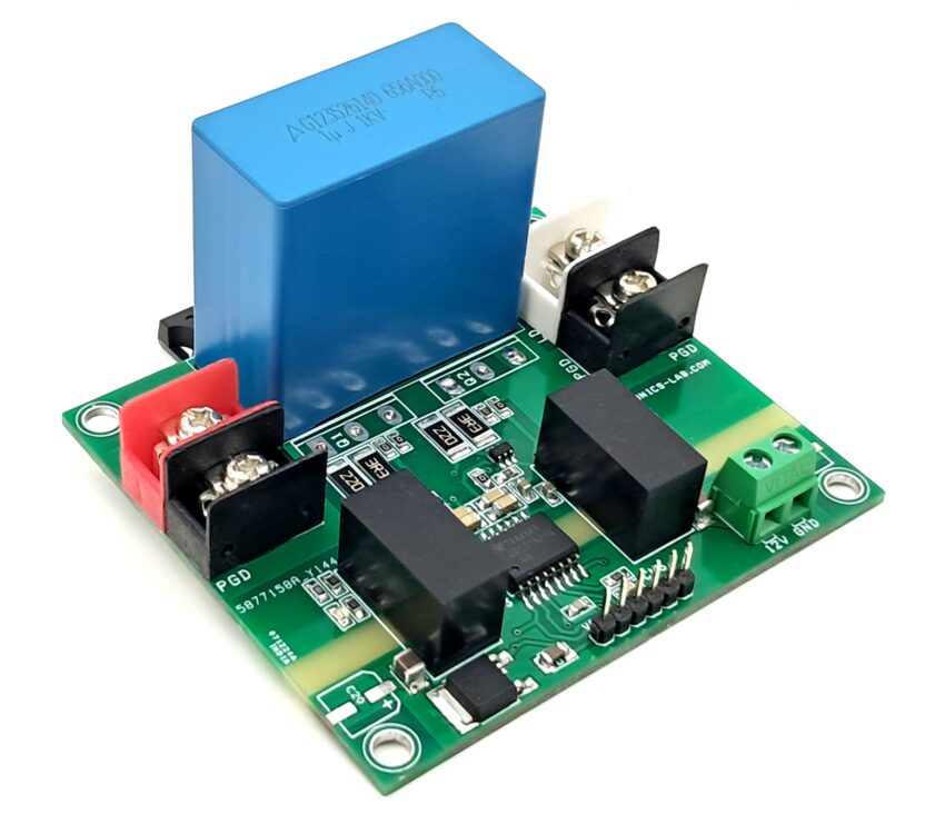

High-Voltage Isolated Half-Bridge Driver (Up to 1kV)
A fully isolated 1kV half-bridge driver for high-voltage use. Features isolated DC-DC converters, 1.2KV IGBTs, power LEDs, and 2.5kV galvanic isolation between signal and power grounds. Accepts 12V DC input and PWM control.

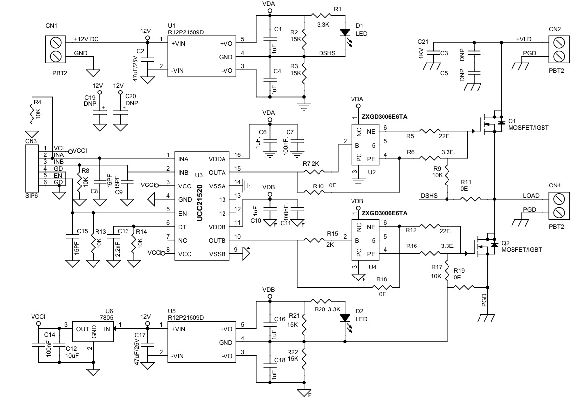

This fully isolated half-bridge driver is designed for high-voltage applications up to 1kV. It features 2 x 2W isolated DC-DC converters to independently power the low-side and high-side switching elements. The board is assembled with 1.2KV IGBTs, Two power LEDs provide visual indication of power presence for both the low-side and high-side gate drivers. The signal ground is galvanically isolated from the power ground, allowing it to be connected to any potential up to 2.5kV. Barrier connectors are provided for the load and its power supply. A screw terminal connector facilitates the 12V DC input for the gate driver circuitry. A LM78M05 regulator provides a 5V supply to the logic side of the gate driver input circuit. A header connector allows for PWM input via channels A and B, as well as enable/disable control.
The driver incorporates the following key components:
- UCC21520 Isolated Half-Bridge Driver Chip
- Two Isolated DC-DC Converters (one for each side), R12P21509D
- ZXGD30006 High-Current Gate Driver Chip
- Two 1.2KV/40Amp, FGH40T120SMD-ND
Important Considerations:
- Select appropriate IGBTs based on your specific power and frequency requirements.
- This board is suitable for DC bus voltages up to 800V Max 1KV.
- Testing was performed using a 6.5kHz TTL signal and a 105V DC power supply.
- Power Supply Gate Driver 12V DC
- Power Supply Load 800V DC (Max 1KV)
- Gate Drive DC-DC Converter Voltage Output +15V / -9V
- On Board 5V Regulator to power the Gate Driver Input side circuit
- Common-Mode Transient Immunity (CMTI) greater than 125V/ns
- High Gate-drive Currents (up to 10A source and sink)
- Surge immunity up to 10kV
- Programmable overlap and dead time
- Fast disable for power sequencing
- 8000VPK reinforced Isolation per DIN EN IEC 60747-17 (VDE 0884-17)
- 7kVRMS isolation for 1 minute per UL 1577 (UCC21520)
- 4 x 4MM PCB Mounting Holes
- PCB Dimensions 79.69 x 70.17 mm

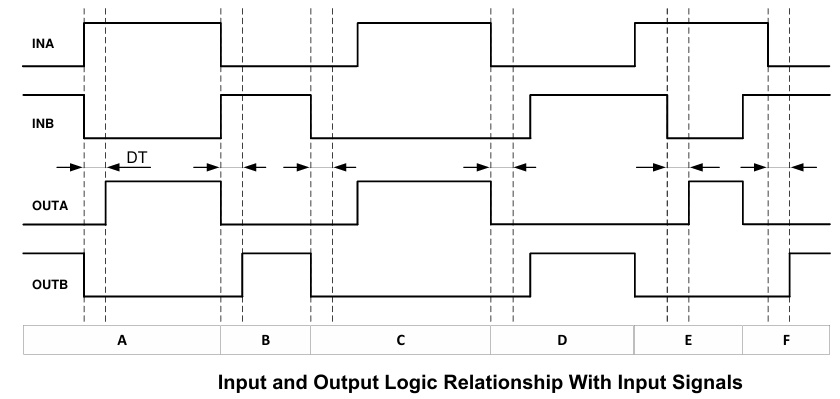

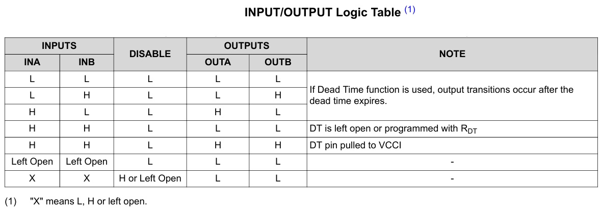

Inputs and Outputs
- Condition A: INB goes low, INA goes high. INB sets OUTB low immediately and assigns the programmed dead time to OUTA. OUTA is allowed to go high after the programmed dead time.
- Condition B: INB goes high, INA goes low. Now INA sets OUTA low immediately and assigns the programmed dead time to OUTB. OUTB is allowed to go high after the programmed dead time.
- Condition C: INB goes low, INA is still low. INB sets OUTB low immediately and assigns the programmed dead time for OUTA. In this case, the input signal’s own dead time is longer than the programmed dead time. Thus, when INA goes high, it immediately sets OUTA high.
- Condition D: INA goes low, INB is still low. INA sets OUTA low immediately and assigns the programmed dead time to OUTB. INB’s own dead time is longer than the programmed dead time. Thus, when INB goes high, it immediately sets OUTB high.
- Condition E: INA goes high, while INB and OUTB are still high. To avoid overshoot, INA immediately pulls OUTB low and keeps OUTA low. After some time OUTB goes low and assigns the programmed dead time to OUTA. OUTB is already low. After the programmed dead time, OUTA is allowed to go high.
- Condition F: INB goes high, while INA and OUTA are still high. To avoid overshoot, INB immediately pulls OUTA low and keeps OUTB low. After some time OUTA goes low and assigns the programmed dead time to OUTB. OUTA is already low. After the programmed dead time, OUTB is allowed to go high.

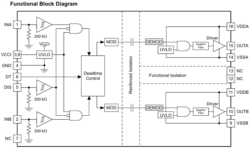

The UCC21520 is an isolated dual-channel gate driver with 4A source and 6A sink peak current. It is designed to drive power MOSFETs, IGBTs, and SiC MOSFETs up to 5MHz.The input side is isolated from the two output drivers by a 5.7kVRMS reinforced isolation barrier, with a minimum of 125V/ns common-mode transient immunity (CMTI). Internal functional isolation between the two secondary-side drivers allows a working voltage of up to 1500VDC.Every driver can be configured as two low-side drivers, two high-side drivers, or a half-bridge driver with programmable dead time (DT). A disable pin shuts down both outputs simultaneously when it is set high, and allows normal operation when left open or grounded. As a fail-safe measure, primary-side logic failures force both outputs low. Each device accepts VDD supply voltages up to 25V. A wide input VCCI range from 3V to 18V makes the driver suitable for interfacing with both analog and digital controllers. All supply voltage pins have under voltage lock-out (UVLO) protection. With all these advanced features, the UCC21520 enables high efficiency, high power density, and robustness. Each device accepts VDD supply voltages up to 25 V. A wide input VCCI range from 3 V to 18 V makes the driver suitable for interfacing with both analog and digital controllers. All supply voltage pins have under voltage lock-out (UVLO) protection. With all these advanced features, the UCC21520 and the UCC21520A enable high efficiency, high power density, and robustness in a wide variety of power applications.
Schematic

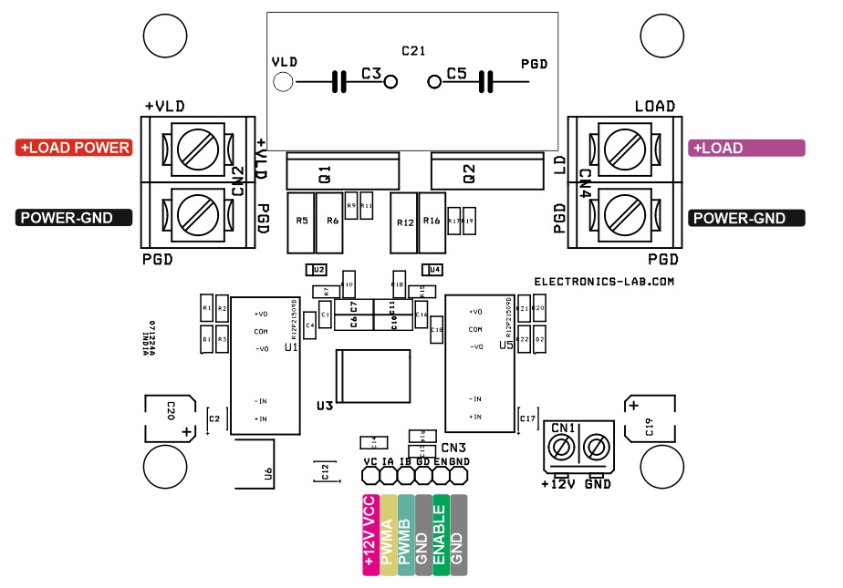

Connections
UCC21520 Block Diagram
Input/Output Waveforms
Input/Output Logic Table
