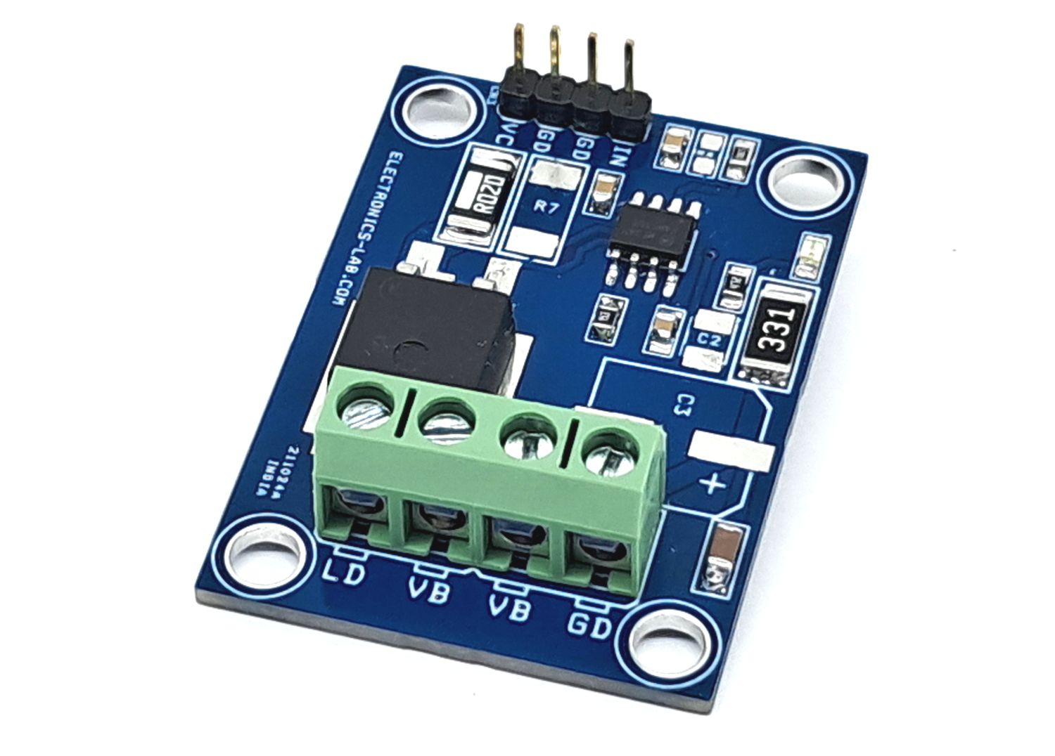

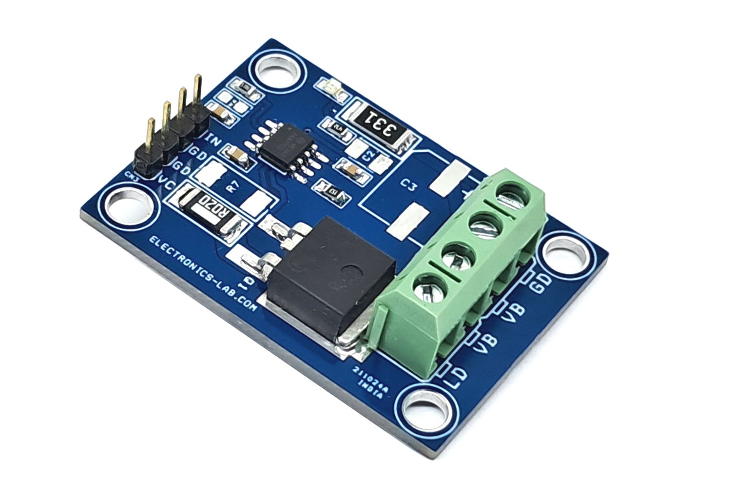

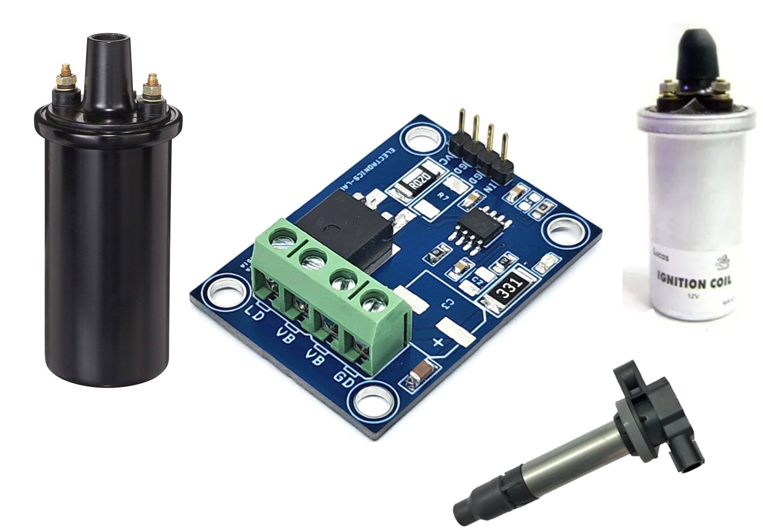

The project presented here is an Ignition coil driver featuring FAN1100-F085 ignition gate driver chip and IGBT. Chip is designed to directly drive an ignition IGBT and control the current and spark event of the coil.
Automotive by mixos

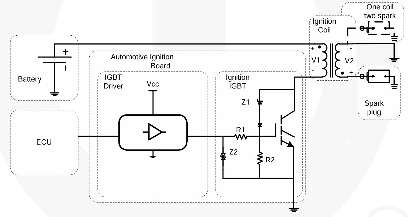

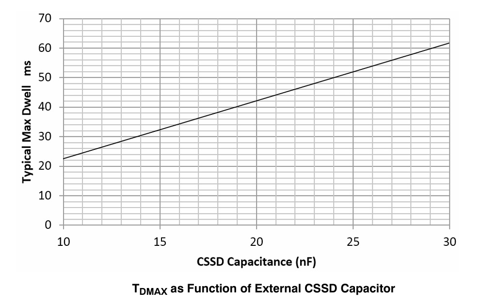

The project presented here is an Ignition coil driver featuring FAN1100-F085 ignition gate driver chip and IGBT. Chip is designed to directly drive an ignition IGBT and control the current and spark event of the coil. The coil current is controlled via the input signal pin. When the input is driven high, the output of the chip is enabled to turn on the IGBT and start charging the coil. Output sink current is programable using resistor R5 (RA). An input spike filter suppresses input signals of less than 13uS in duration. A Max Dwell timer is included in the chip which will turn off the IGBT if input stays active for longer than the programmable time. This time interval can be modified through an external capacitor on the CSSD pin. When the Max Dwell timer is exceeded, the CHIP will enter a Soft-Shut-Down mode (SSD) slowly dropping the collector current by lowering the gate drive to the IGBT thereby discharging the coil such as to inhibit a spark event. Once the soft shutdown operation has started, any transition on the input signal is ignored until after the completion of the soft shutdown function. Chip also limits the collector current of the IGBT during charging. This is done through the sense resistor R6 in the emitter leg of the ignition IGBT developing a signal input to the V-Sense pin of the chip.

  • Programmable Maximum Dwell Time

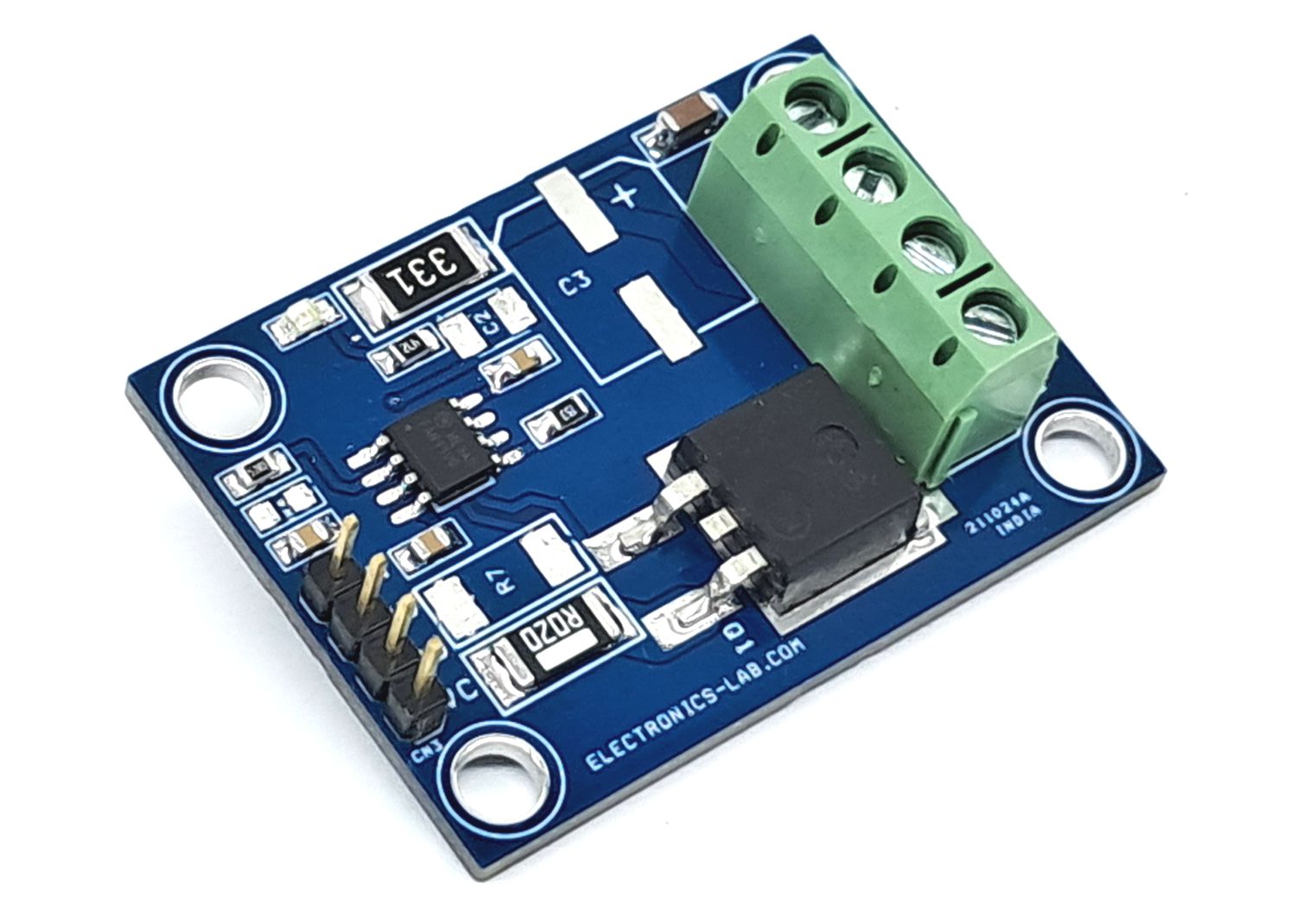

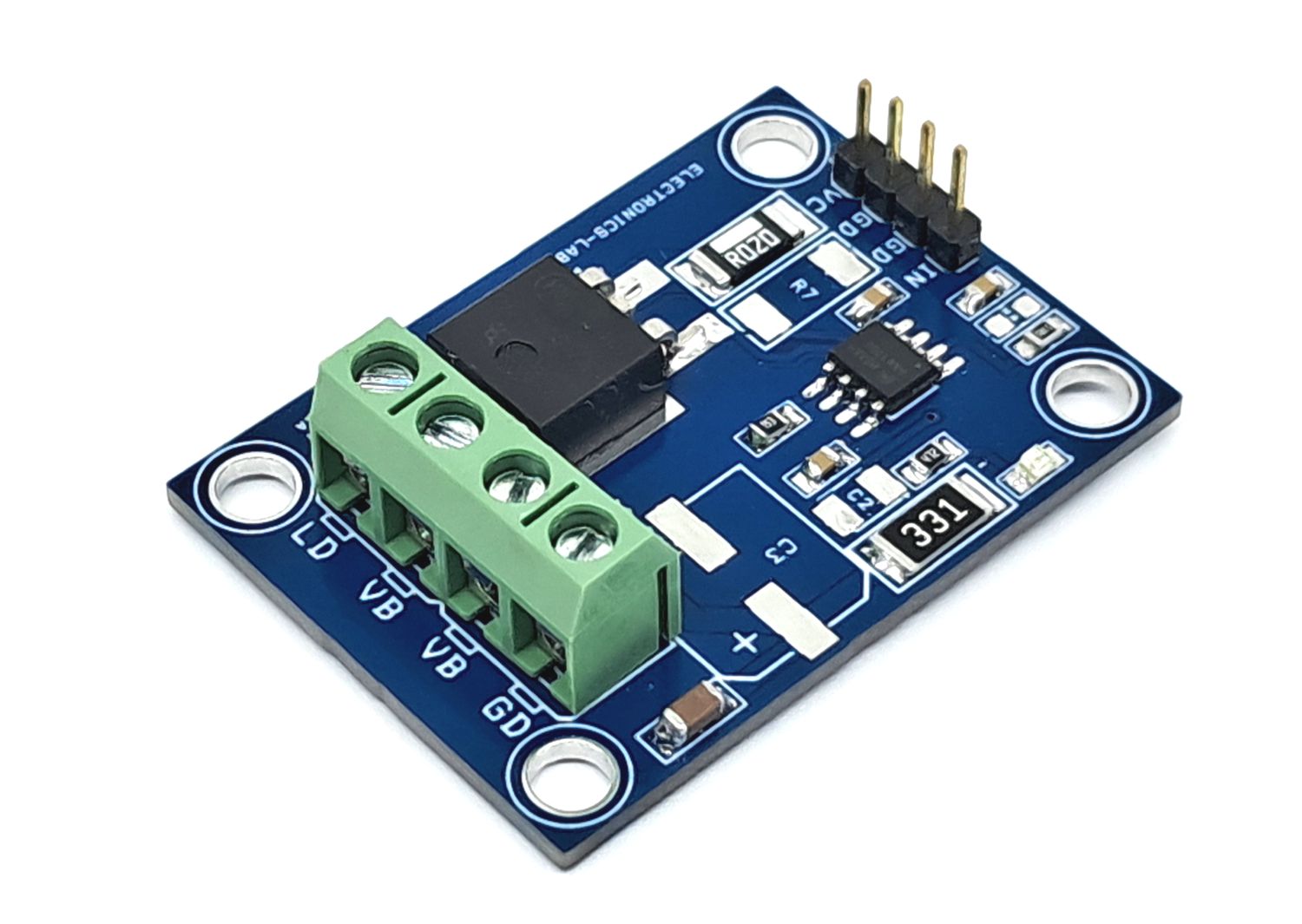

  • On Board Power LED

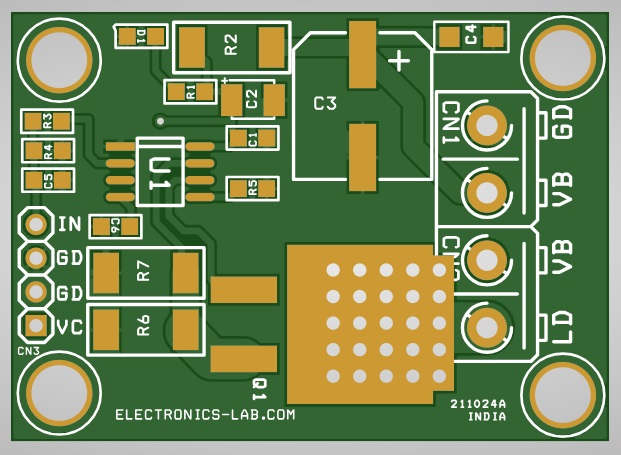

  • Screw Terminals for Power Input and Ignition Coil
  • Header Connector for Signal Input
  • 4 x 4 mm PCB Mounting Holes
  • PCB Dimensions 45.09 x 32.39 mm

These Logic Level Insulated Gate Bipolar Transistor (IGBT) features monolithic circuitry integrating ESD and Overvoltage clamped protection for use in inductive coil drivers’ applications. Primary uses include Ignition, Direct Fuel Injection, or wherever high voltage and high current switching is required. Ignition IGBTs are optimized to control the load current through the ignition coil and feature an integrated clamp structure that limits the maximum voltage on the primary side.

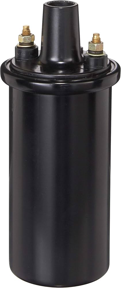

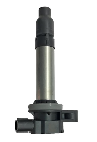

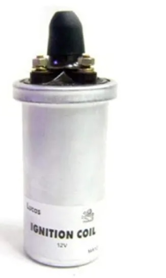

Typical Ignition Coil

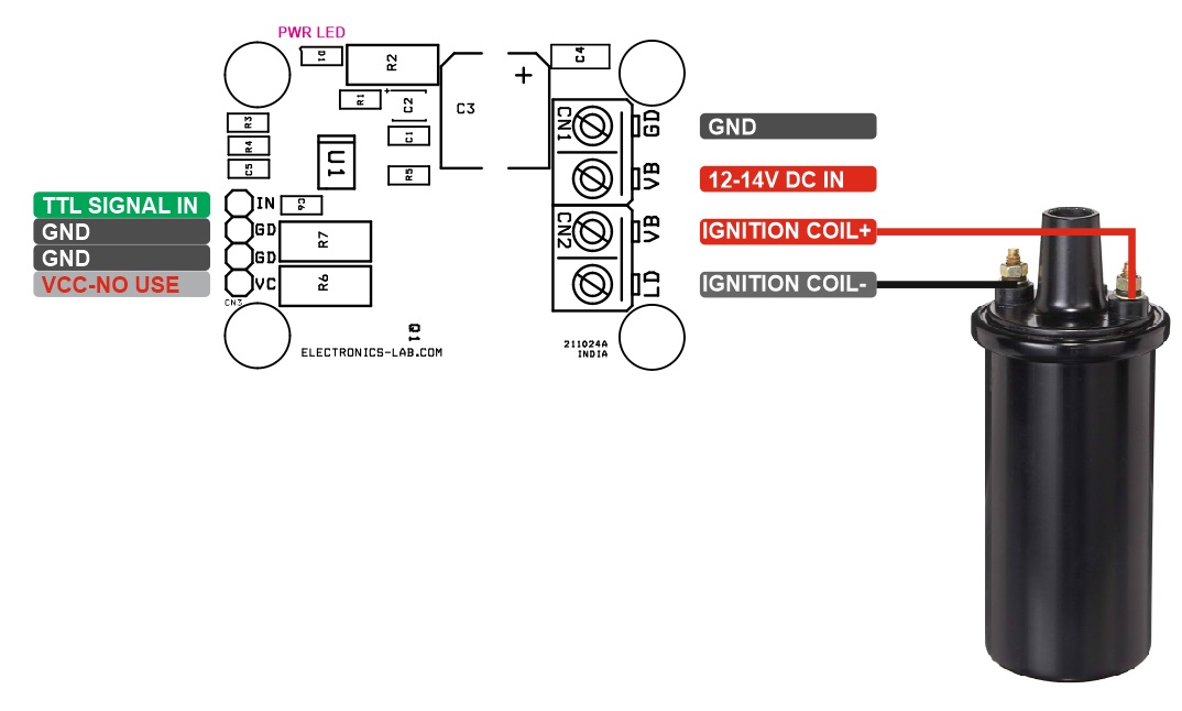

Connections
  • CN1 Power Input: Pin 1 = Pin 1 +12V to 14V DC, Pin 2 = GND
  • CN2 Ignition Coil: Pin 1 = + Coil, Pin 2 = -Coil
  • CN3 Signal Input: Pin 1 = VCC No Use, Pin 2 = GND, Pin 3 = GND, Pin 4 = Signal Input (TTL)
  • D1: Power LED

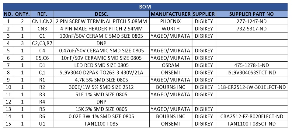

Parts List
NO.QNTY.REF.DESC.MANUFACTURERSUPPLIERSUPPLIER PART NO
12CN1,CN22 PIN SCREW TERMINAL PITCH 5.08MMPHOENIXDIGIKEY277-1247-ND
21CN34 PIN MALE HEADER PITCH 2.54MMWURTHDIGIKEY732-5317-ND
31C1100nF/50V CERAMIC SMD SIZE 0805YAGEO/MURATADIGIKEY
43D2,C3,R7DNP
51C40.47uF/50V CERAMIC SMD SIZE 0805YAGEO/MURATADIGIKEY
62C5,C610nF/50V CERAMIC SMD SIZE 0805YAGEO/MURATADIGIKEY
71D1LED RED SMD SIZE 0805OSRAMDIGIKEY475-1278-1-ND
81Q1ISL9V3040 D2PAK-TO263-3 430V/21A ONSEMIDIGIKEYISL9V3040S3STCT-ND
91R14.7K 5% SMD SIZE 0805YAGEO/MURATADIGIKEY
101R2300E/1W 5% SMD SIZE 2512BOURNS INCDIGIKEY118-CR2512-JW-301ELFCT-ND
111R351E 1% SMD SIZE 0805YAGEO/MURATADIGIKEY
121R4DNP
131R515K 5% SMD SIZE 0805YAGEO/MURATADIGIKEY
141R60.02E 3W 1% SMD SIZE 0805BOURNS INCDIGIKEYCRA2512-FZ-R020ELFCT-ND
151U1FAN1100-F085ONSEMIDIGIKEYFAN1100-F085CT-ND

Cssd Capacitor vs Dwell Time

1 Comment
dhanushka
HI, Why C3 D2 R7 is not soldered?
