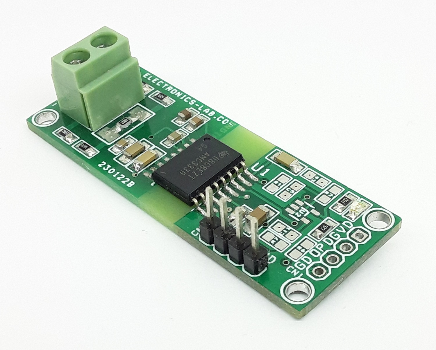

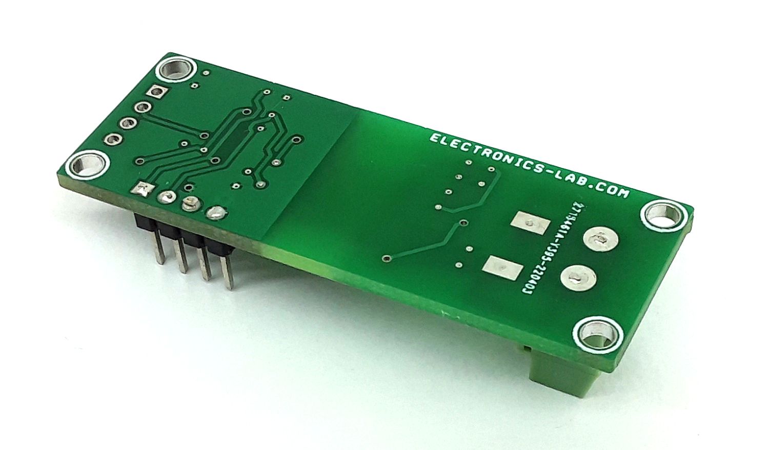

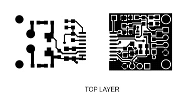

Isolated Voltage-Measurement with ±1V Input, Differential Output and Integrated DC/DC Converter
This project can be used in bidirectional high-voltage measurements. The output is fully isolated from the input side and can be used for applications such as high-voltage DC-DC converters, High-Voltage EV chargers, SMPS, 3 Phase motor drivers, inverters, etc.
This project can be used in bidirectional high-voltage measurements. The output is fully isolated from the input side and can be used for applications such as high-voltage DC-DC converters, High-Voltage EV chargers, SMPS, 3 Phase motor drivers, inverters, etc. The board is built using the AMC3330 chip. This chip is a precision, isolated amplifier with a fully integrated, isolated DC/DC converter that allows single-supply operation from the low side of the device. The reinforced capacitive isolation barrier is certified according to VDE V 0884-11 and UL1577 and separates sections of the system that operate on different common-mode voltage levels and protect low-voltage domains from damage. The circuit senses high voltage in the range from -1V to 1V across resistor dividers R11, R4, R5, R8, and R12 and provides differential analog output Out-P and Out-N. The integrated isolated DC/DC converter allows the measurement of non-ground-referenced signals.
The board offers a differential analog output comprised of OUTP and OUTN pins. For differential input voltages (VINP – VINN) in the range from –1 V to 1 V, the device provides a linear response with a nominal gain of 2. For example, for a differential input voltage of 1 V, the differential output voltage (VOUTP – VOUTN) is 2 V. At zero input (INP shorted to INN), both pins output the same voltage, VCMout. For absolute differential input voltages greater than 1.0 V but less than 1.25 V, the differential output voltage continues to increase in magnitude but with reduced linearity performance.
Note 1: Do not leave the analog inputs INP and INN of the project unconnected (floating) when the device is powered up on the high side. If the device input is left floating, the bias current may generate a negative input voltage that exceeds the specified input voltage range and the output of the device will be invalid.
Note 2: It is advisable to use 1% tolerance for divider/voltage sense resistors.

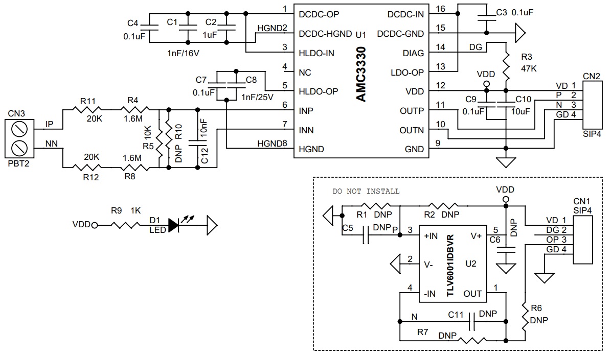

Voltage Range and Divider Resistor Calculation
The board is optimized for 230V AC measurements, thus it can be modified for higher or lower voltage measurement range by altering the value of divider resistors R11, R4, R5, R8, R12. Current through resistor divider is 100uA, resulting in voltage drop on sense resistor R5 = 1V.
  • For 230V-RMS Line Voltage (Peak Voltage 325V) R11=20K + R4=1.6M, R5 = 10K, R12 = 20K + R8=1.6M Tolerance 1%
  • For 120V-RMS Line Voltage (Peak Voltage 170V) R11=25K + R4=820K, R5 = 10K, R12 = 25K + R8=820K Tolerance 1%

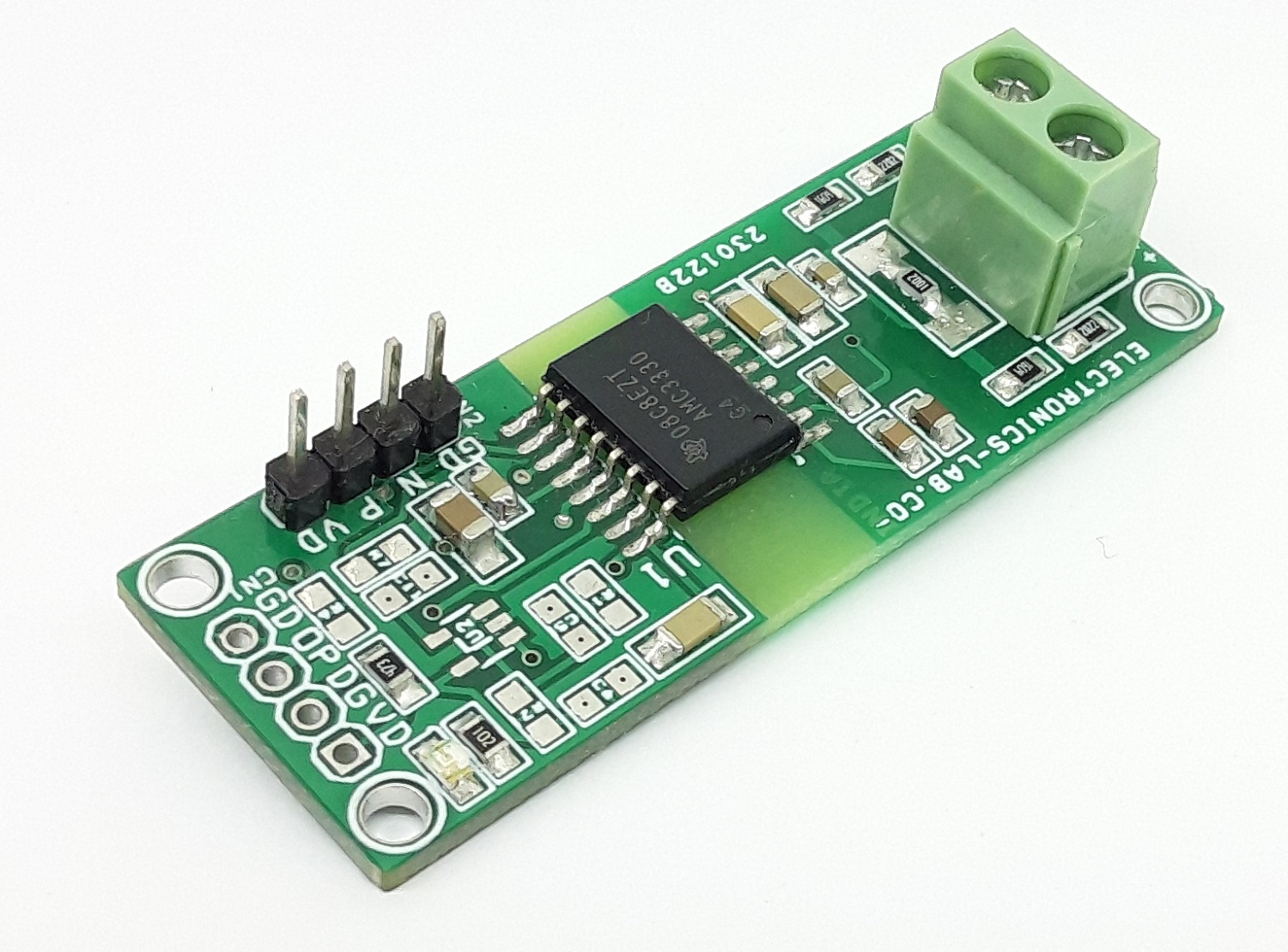

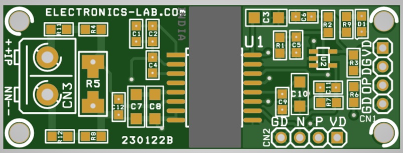

  • CN1: Pin 1 = DIAG, PIN 2 = No Use, Pin 3 = Op, Pin 4 = GND
  • CN2: Pin 1 = VDD 5V DC In, Pin 2 = Output-P, Pin 3 = Output-N, Pin 4 = GND
  • CN3: Pin 1 = Primary Input +P, Pin 2 = Primary Input -N
  • D1: Power LED
  • Power Supply Input 5V DC (Range 3.3V to 5V)
  • ±1-V input voltage range optimized for voltage measurements with a high input impedance
  • Fixed gain: 2.0
  • 6000-VPK reinforced isolation
  • Low DC errors: – Gain error: ±0.2% (max) – Gain drift: ±45 ppm/°C (max) – Offset error: ±0.3 mV (max) – Offset drift: ±4 µV/°C (max) – Nonlinearity: ±0.02% (max)
  • Common Mode Output 1.44V (Voltage Output at zero 1.44V)
  • Clipping Differential Output Voltage +/-2.49V (VOUT = (VOUTP – VOUTN); |VIN| = |VINP – VINN| > VClipping)
  • Output Short-circuit Current 14mA
  • PCB Dimensions 53.98 x 19.69mm
  • 4 x 2.5 mm Mounting Holes

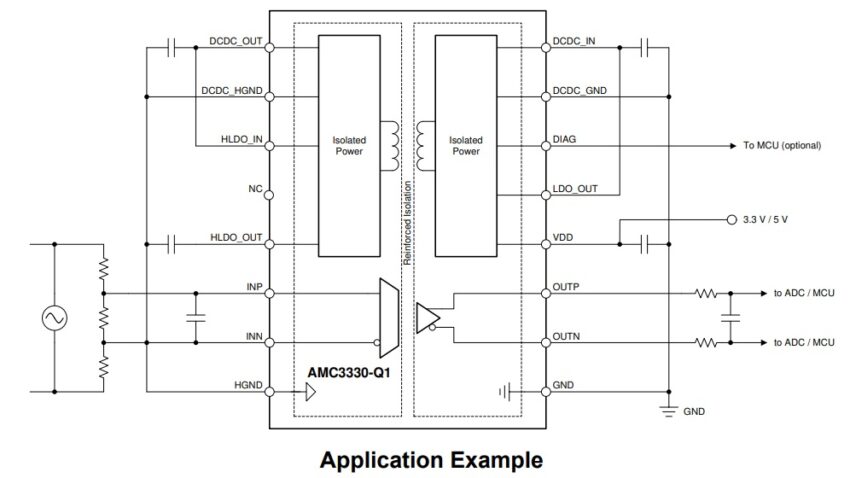

Diagnostic Output and Fail-Safe Behaviour
The open-drain DIAG pin can be monitored to confirm the device is operational, and that the output voltage is valid. During power-up, the DIAG pin is actively held low until the high-side supply is in regulation and the device operates properly. The DIAG pin is actively pulled low if:
  • The low-side does not receive data from the high-side (for example, because of a loss of power on the high side). The amplifier outputs are driven to negative full-scale.
  • The high-side DC/DC output voltage (DCDC_OUT) or the high-side LDO output voltage (HLDO_OUT) drop below their respective undervoltage detection thresholds VDCDCUV and VHLDOUV as specified in the Electrical Characteristics table. In this case, the low-side may still receive data from the high-side but the data may not be valid. The amplifier outputs are driven to negative full-scale. During normal operation, the DIAG pin is in a high-impedance state. Connect the DIAG pin to a pull-up supply through a resistor or leave open if not used.

Hello,
I wanted to use your design to measure +/-1v to unipolar input and so use the opamp part on the PCB. But I see that the two input resistors coming from P and N and going to the opamp are forgotten in the design. In the way, the amplifier gain is almost infinitive.
Is it possible to add those 2 resistors to the design and update the PCB (or share the PCB that I can add them myself)?
