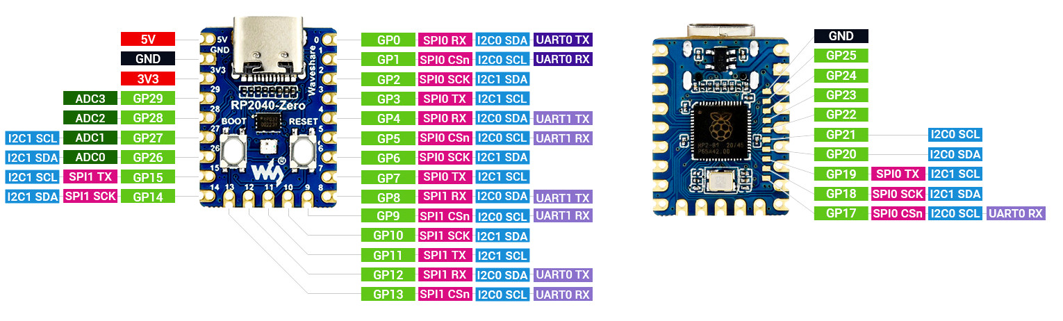

RP2040 pinout
The circuit for this article will be supplied straight from a USB connection, using the USB-C available in the RP2040 Zero seen in the image above. Both our OLED screen and distance sensor will receive 3.3V and GND from the RP2040 Zero board. So, no worries about power conversion and external power, everything comes via USB cable.
As stated above, both the 0.49” OLED display and the VL53L0x distance sensor use an I2C port for communication with our microcontroller. I have implemented such communication using I2C0 SDA and I2C0 SCL on pins GP0 and GP1. In case you are using an Arduino UNO for this tutorial, just connect SDA and SCL to A4 and A5.

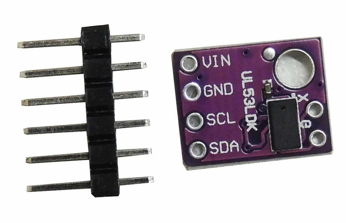

The sensor called VL53L0x is a time-of-flight ranging sensor from ST Semiconductors, whose datasheet is here. Applications of this sensor include (as stated) robotics, liquid level detection, and access control.
Its laser detects objects up to two (2) meters regardless of the reflectance, while being totally invisible to the human eye. Using the I2C scanner sketch, I determined its I2C address as 0x29. You also don’t have to worry about that, since addressing is handled for you by the sensor’s library.
vl53l0x range sensor

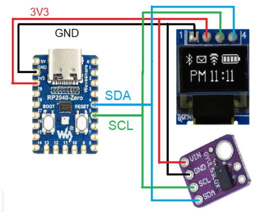

Schematic diagram

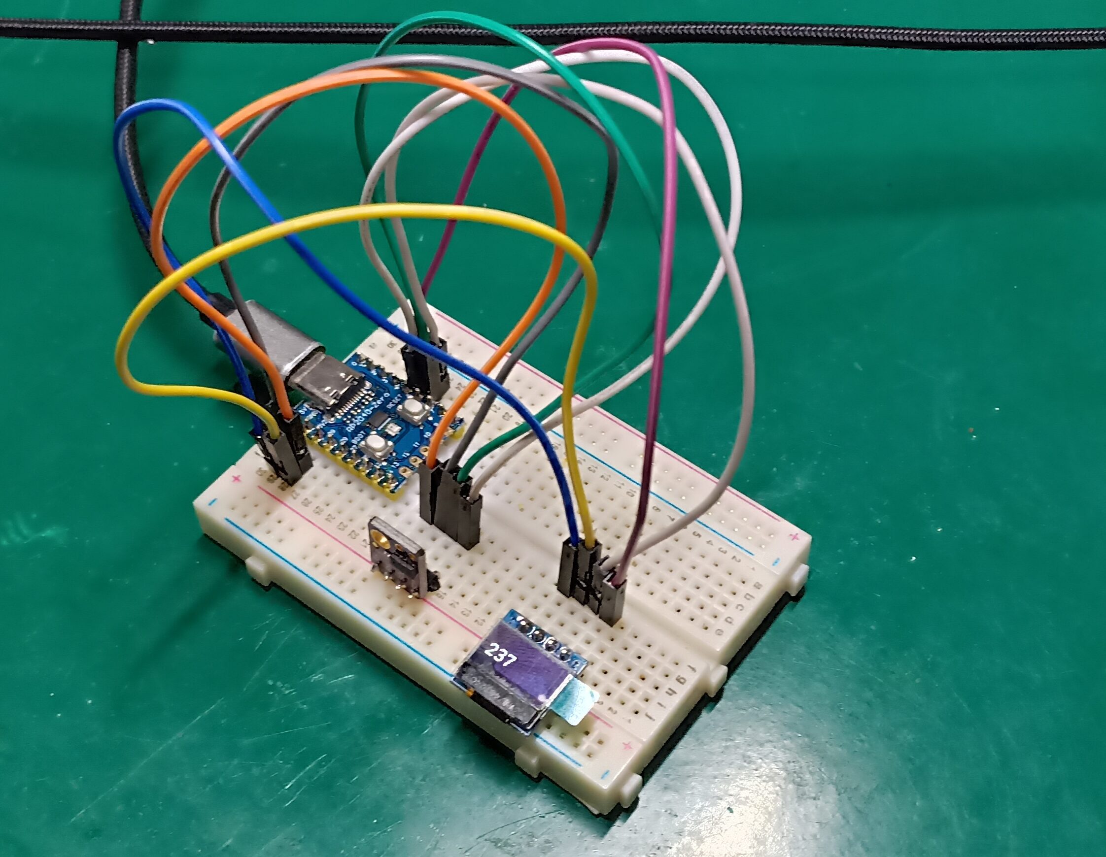

The schematic diagram for our project is rather simple, as stated before, both the OLED and the distance sensor use I2C communication. So only four wires will suffice to connect both; these are +3.3V, GND, SDA, and SCL. Als,o as stated, power comes via USB-C C so no worries about that, we just use the 3.3V generated by the RP2040 Zero board.

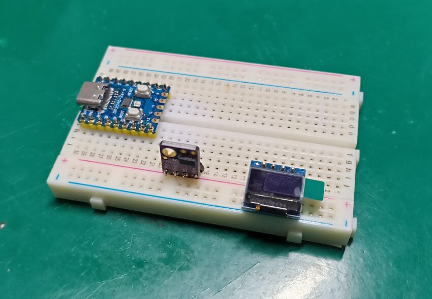

I have assembled the prototype on an 830-point breadboard, but I am very sure it would fit in a 400-point one as well.
Note: for the RP2040 Zero to fit on a breadboard, you should not solder/assemble the pin header of pins 9 to 13.
vl53l0x distance sensor schematic diagram
I2C’s SDA goes on pin 4 and SCL on pin 5 of the RP2040 Zero. I had to figure that out myself, since in the pinout diagram I made available above, the RP2040 has multiple possible sets of I2C pins. Then I had to test one by one, starting from I2C0 (because I knew it would be on I2C0, not I2C1) on pins 0 and 1. I was lucky I2C2 enough that I tested pins 4 and 5 second and already found them to be the ones.
vl53l0x on a breadboard with RP2040

VL53L0x laser distance sensor on a breadboard

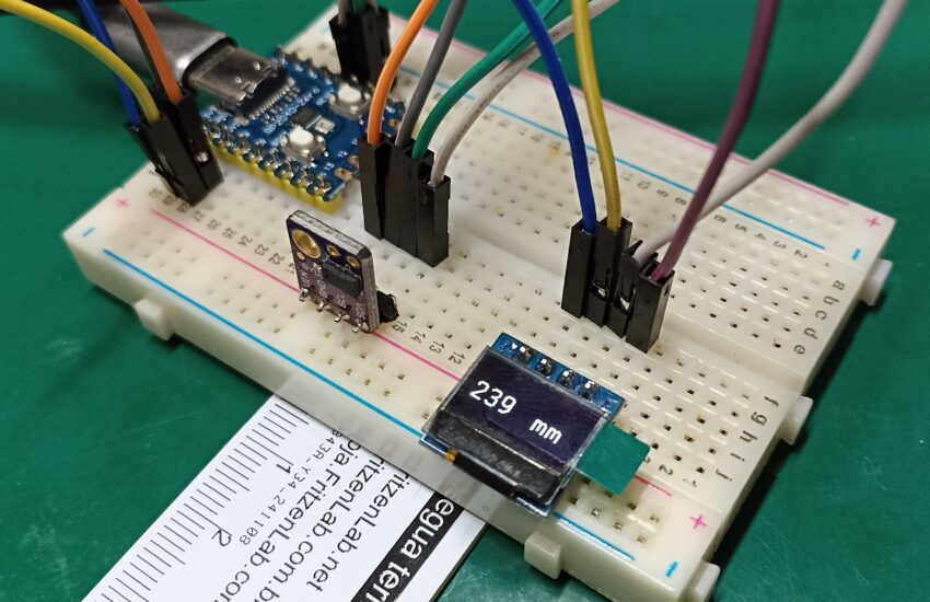

As you can see in the picture and video below, a distance is read every 100ms and printed in our small OLED. Fixed text “mm” does not bother or get bothered by anything around it. There is a “Serial.print” function to send data to the Arduino IDE serial monitor, for you to have a look at it and compare.
Video
Conclusions
If you look closely at the ruler under the breadboard, our measurement on the screen is not quite precise as it is. It may come down to calibration (most certainly), some exercise I will leave to you to implement. Tip: Just subtract a constant from the measured value.
