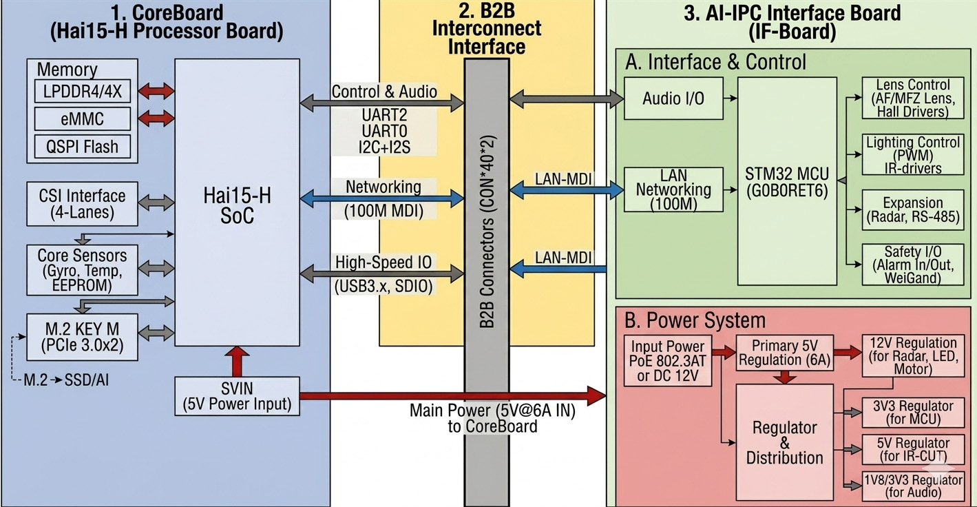

The camera is built around a Sony IMX678 1/1.8-inch 4K CMOS image sensor and an 8–32 mm autofocus zoom lens with an F1.6–F1.7 aperture. The imaging system uses the Hailo Gen2 AI-ISP, supports H.264/H.265 hardware encoding at up to 4K@30fps, and is specified to operate in lighting conditions down to <0.01 lux. The main control board is a dual-board architecture that features a core processing board with the Hailo-15H SoC, memory, and storage, and an interface board based on an STMicroelectronics STM32G0B0RET6 Cortex-M0+ MCU that manages external I/O, power management, and lens control. This targets applications such as smart security, industrial inspection, and AIoT.

NeoEyes NE503 dual-board hardware architecture showing the Hailo-15H processor board and STM32G0 interface board.

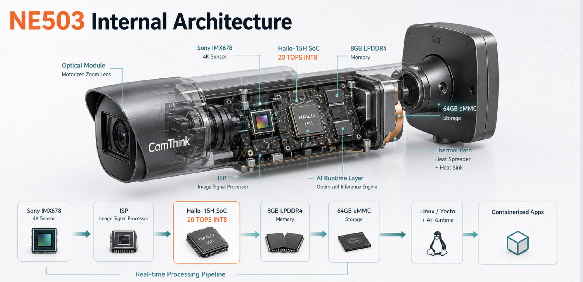

Internal view of the NeoEyes NE503 highlighting the Hailo-15H SoC, Sony IMX678 sensor, LPDDR4 memory, and eMMC storage.
The NE503 runs an embedded Linux built with Yocto and uses a containerd runtime to support OCI-compatible container deployment. It also implements a zero-copy data pipeline (DMA/SHM) to transfer data between the video capture, AI inference, and video encoding modules. The camera ships with pre-installed AI models including YOLOv8n for person detection, Face Landmarks, and a CLIP Image Encoder.
