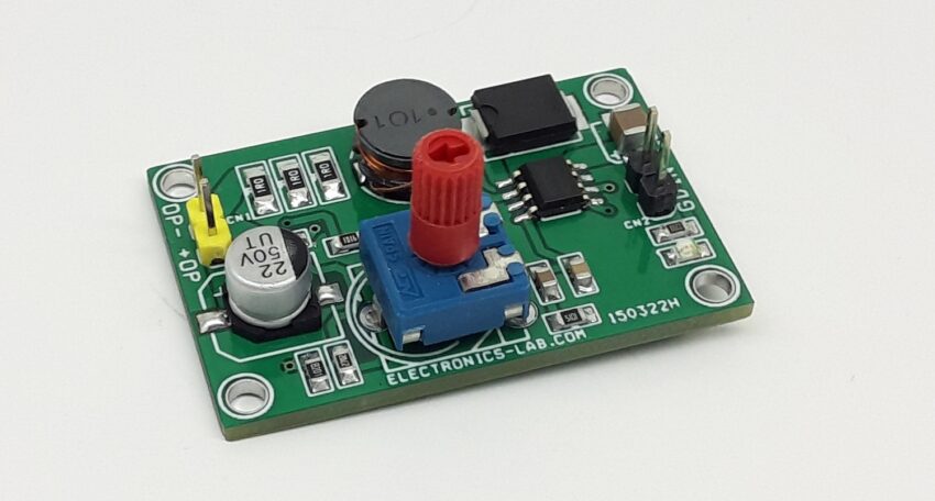

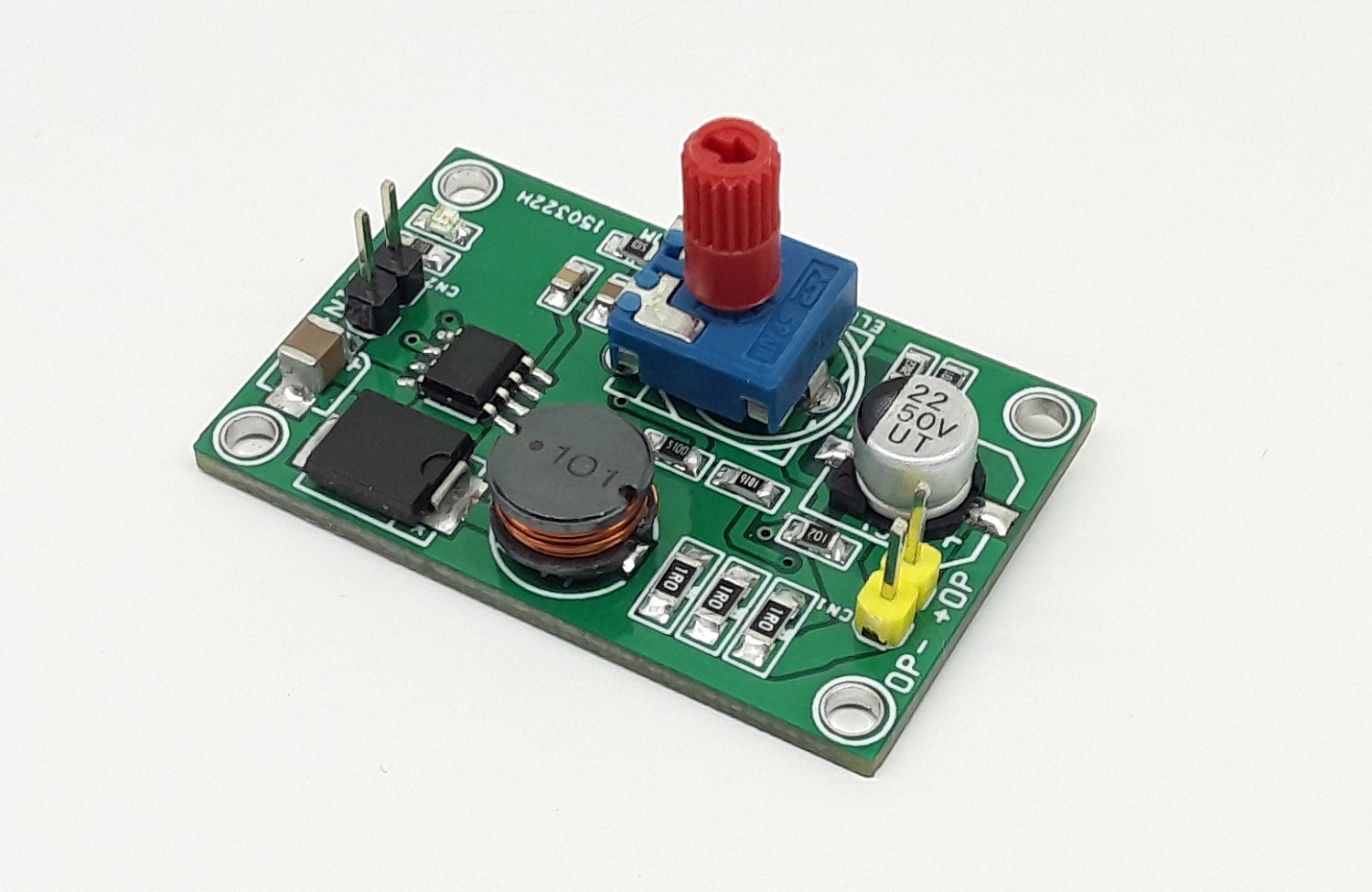

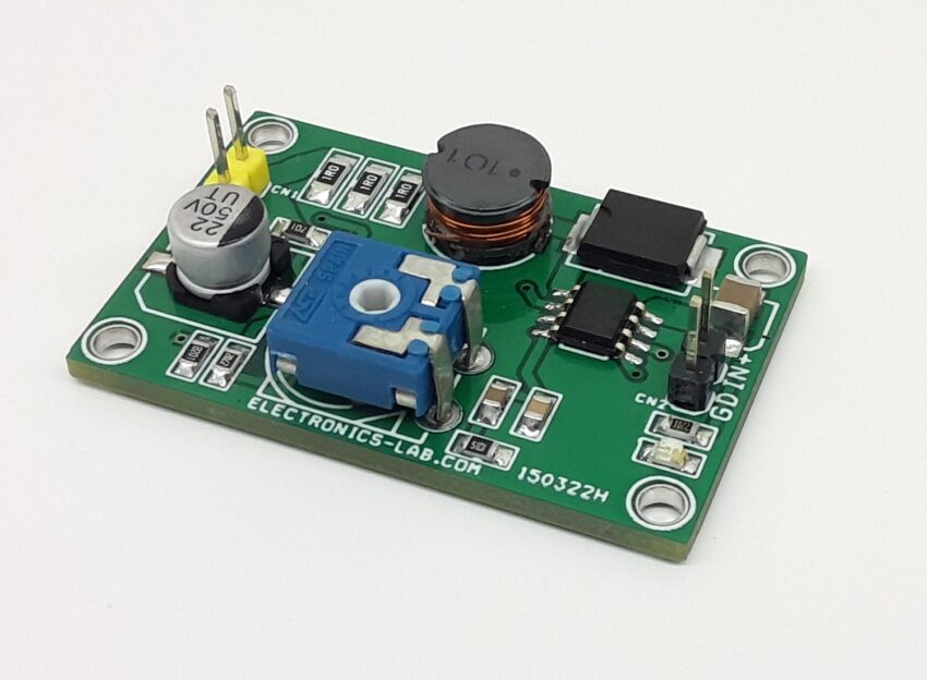

This is a high-efficiency and reliability DC/DC converter with a dimming feature for super high brightness LEDs. The project is built using L6902D chip.

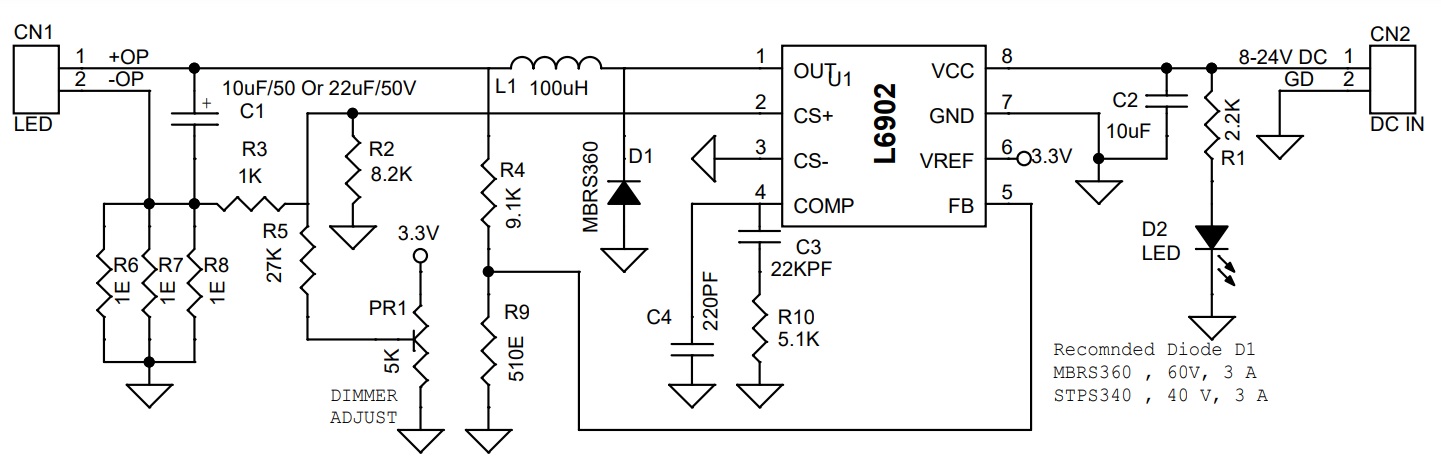

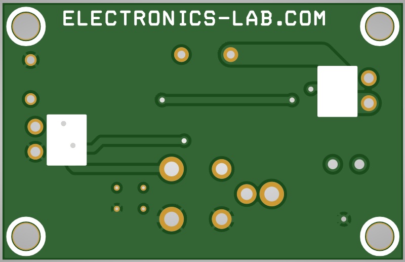

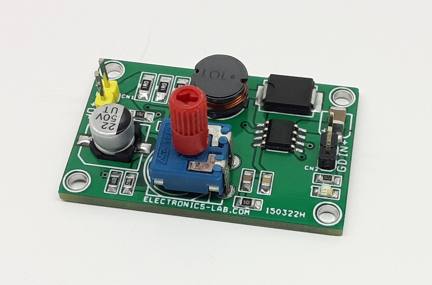

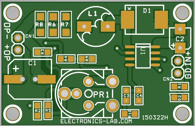

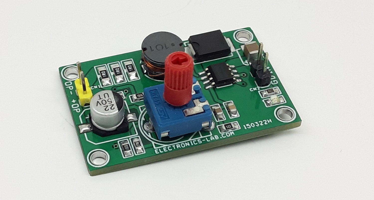

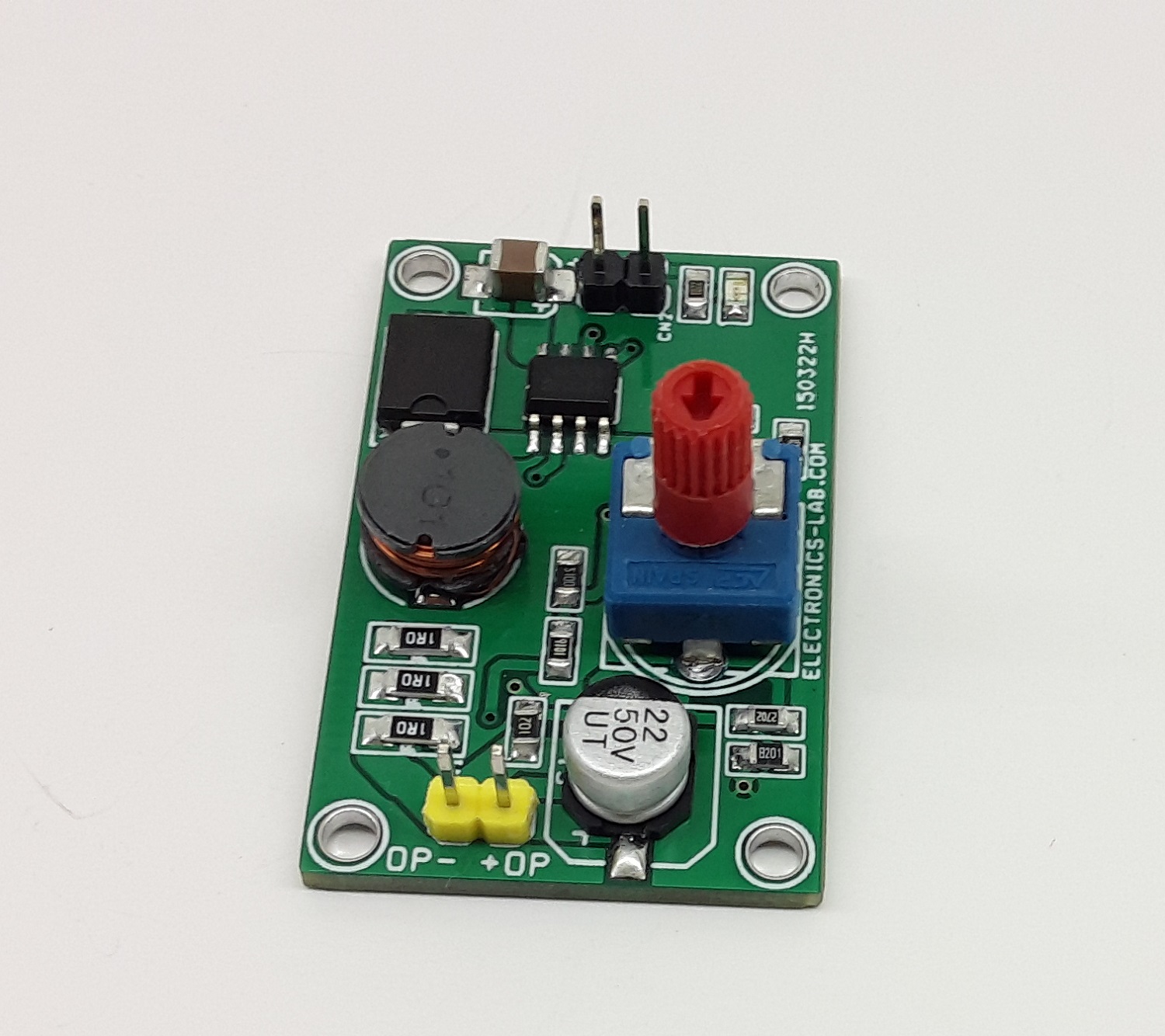

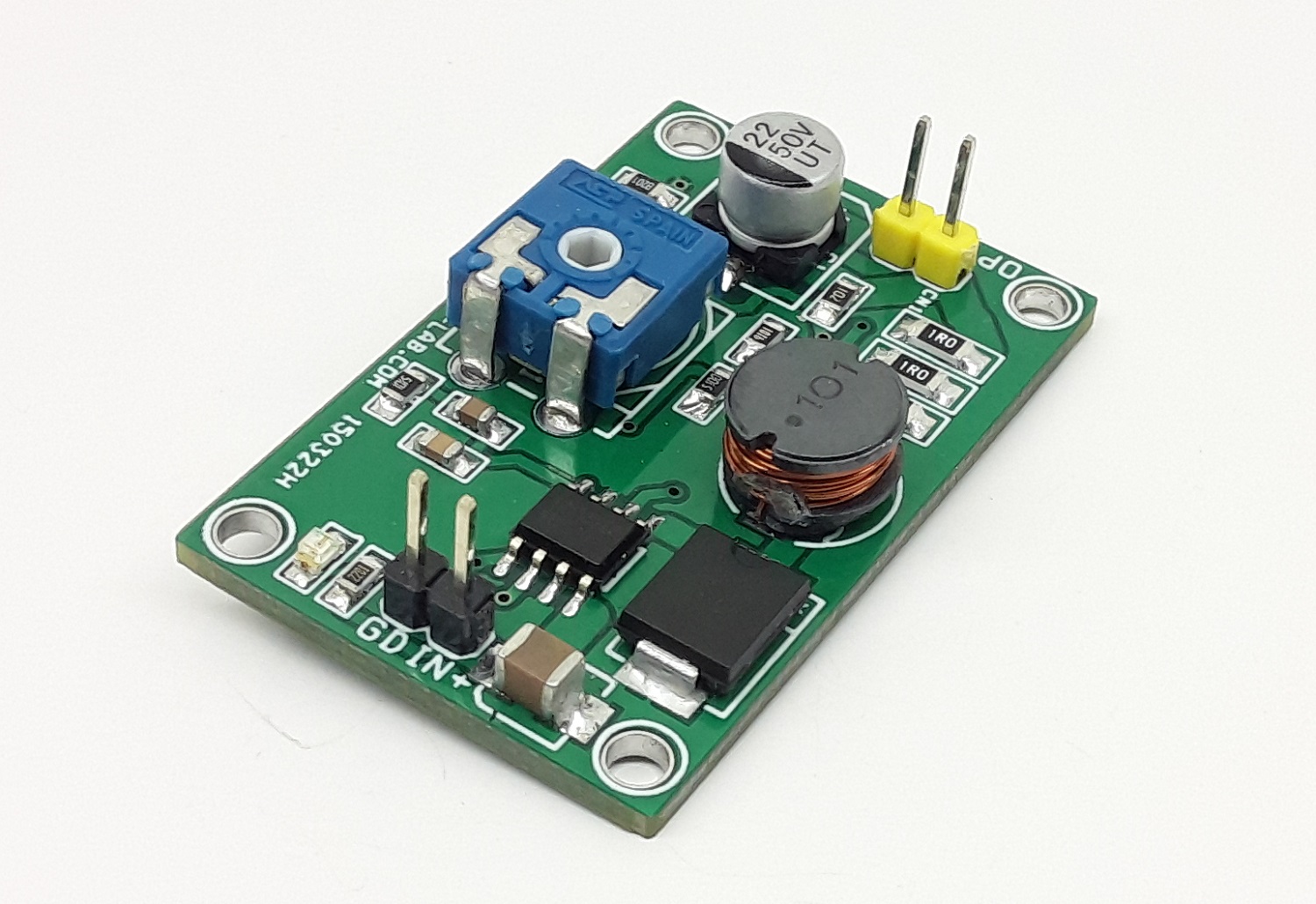

This is a high-efficiency and reliability DC/DC converter with a dimming feature for super high brightness LEDs. The project is built using L6902D chip. L6902 is a complete and simple step-down switching regulator with adjustable current limit. The current control loop with external sense resistors R6, R7, and R8 are able to work in constant current mode providing up to 350mA output current with an accuracy of 5%. Potentiometer PR1 helps to control the dimming of the LEDs. PR1 is connected to the 3.3V reference pin of the chip. When the dimming (CS+) pin is grounded (0V) the maximum output current is provided (350mA) and vice versa when 3.3V is applied to the pin, the current provided is zero and so the LED is off.
- Supply 24V DC (Range 8 to 24V DC)

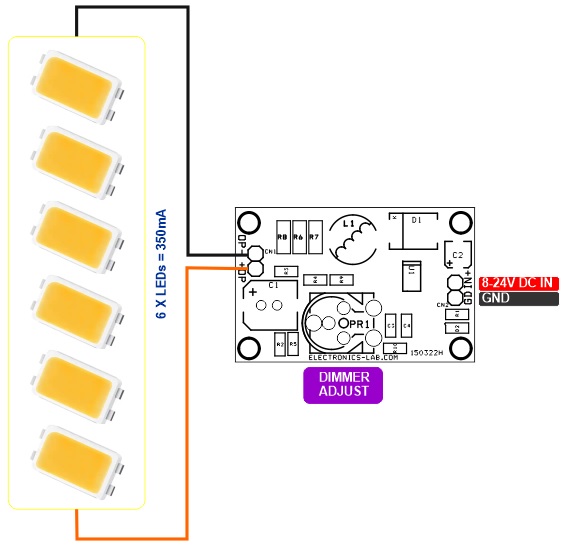

- Load 6 x LEDs in Series (High Brightness LEDs)
- Output Current Adjustable 0 to 350mA
- Short Circuit or Over Current Protection
- Switching Frequency DC-DC Converter 250Khz
- 4 x 2.5MM Mounting Holes -PCB
- PCB Dimensions 40.64 x 26.04 mm

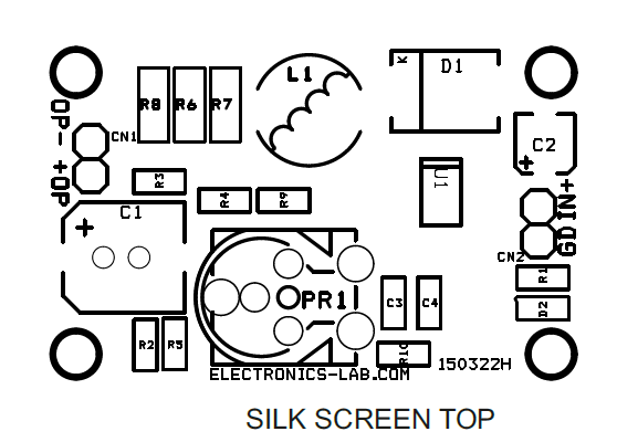

Schematic
Parts List
| NO. | QNTY. | REF. | DESC. | MANUFACTURER | SUPPLIER | PART NO |
| 1 | 1 | CN1 | 2 PIN MALE HEADER PITCH 2.54MM | WURTH | DIGIKEY | 732-5315-ND |
| 2 | 1 | CN2 | 2 PIN MALE HEADER PITCH 2.54MM | WURTH | DIGIKEY | 732-5315-ND |
| 3 | 1 | C1 | 22uF/50V | PANASONIC | DIGIKEY | PCE4797CT-ND |
| 4 | 1 | C2 | 10uF/35V | YAGEO/MURATA | DIGIKEY | |
| 5 | 1 | C3 | 22KPF/50V SMD SIZE 0805 | YAGEO/MURATA | DIGIKEY | |
| 6 | 1 | C4 | 220PF/50V SMD SIZE 0805 | YAGEO/MURATA | DIGIKEY | |
| 7 | 1 | D1 | MBRS360 | ONSEMI | DIGIKEY | MBRS360T3GOSCT-ND |
| 8 | 1 | L1 | 100uH/1AMP | TDK | DIGIKEY | 445-180842-1-ND |
| 9 | 1 | PR1 | 5K TRIMMER POTENTIOMETER | AMPHENOL PHIER | DIGIKEY | 1993-1136-ND |
| 10 | 1 | R1 | 2.2K 5% SMD SIZE 0805 | YAGEO/MURATA | DIGIKEY | |
| 11 | 1 | R2 | 8.2K 1% SMD SIZE 0805 | YAGEO/MURATA | DIGIKEY | |
| 12 | 1 | R3 | 1K 1% SMD SIZE 0805 | YAGEO/MURATA | DIGIKEY | |
| 13 | 1 | R4 | 9.1K 1% SMD SIZE 0805 | YAGEO/MURATA | DIGIKEY | |
| 14 | 1 | R5 | 27K 1% SMD SIZE 0805 | YAGEO/MURATA | DIGIKEY | |
| 15 | 3 | R6,R7,R8 | 1E 1% SMD SIZE 1206 | YAGEO/MURATA | DIGIKEY | |
| 16 | 1 | R9 | 510E 1% SMD SIZE 0805 | YAGEO/MURATA | DIGIKEY | |
| 17 | 1 | R10 | 5.1K 1% SMD SIZE 0805 | YAGEO/MURATA | DIGIKEY | |
| 18 | 1 | U1 | L6902 SOIC8 | ST | DIGIKEY | 497-5330-1-ND |
| 19 | 1 | D2 | LED RED SMD SIZE 0805 | LITE ON INC | DIGIKEY | 160-1427-1-ND |
Connections
