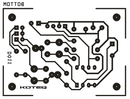

Specifications
- Supply 9 VDC PP3 Battery @ 20 mA
- Onboard Photo Diode
- Onboard preset for calibration
- Range selection via jumper 10mV/LUX, 1mV/LUX, 0.1mV/LUX
- Interfacing is via berg connector
- Power-On LED indicator
- Four mounting holes of 3.2 mm each
- PCB dimensions 53 mm x 38 mm

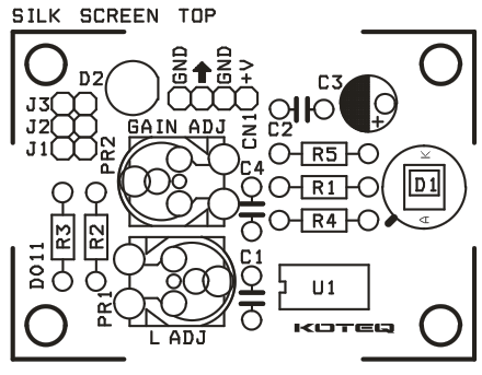

Calibration
- J1 Jumper : 10mV/Lux
- J2 Jumper : 1mV/Lux
- J3 Jumper : 0.1mV/LUX
- PR2 Preset : To Calibrate the meter
- PR1 Preset : Fine Gain adjustment for 10mV/Lux
- CN1 Connector : Supply 9 VDC (PP3 9V DC Battery Ideal) and Output Voltage
- D2 LED : Power Indicator
- D1 LED : Photo Diode (Sensor)
Standard incandescent 100W lamp should be used for approximation calibration. To make Calibration select the 1mV/Lux J2 Jumper, move the preset full in CCW. Connect the accurate voltmeter having range of 5V. Adjust the distance between the photo diode and Lamp so that voltmeter reads 0.38V0. At this point, illumination on photodiode surface is about 100 Lux (aprox). And then adjust the PR2 so that voltmeter reads 1V. Calibration has now been complete. This project is based on Hamamatsu Photo Diode Application
