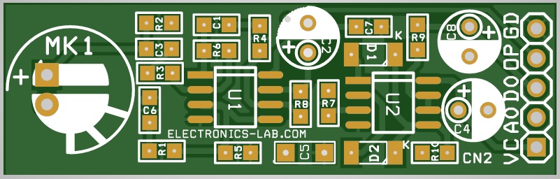

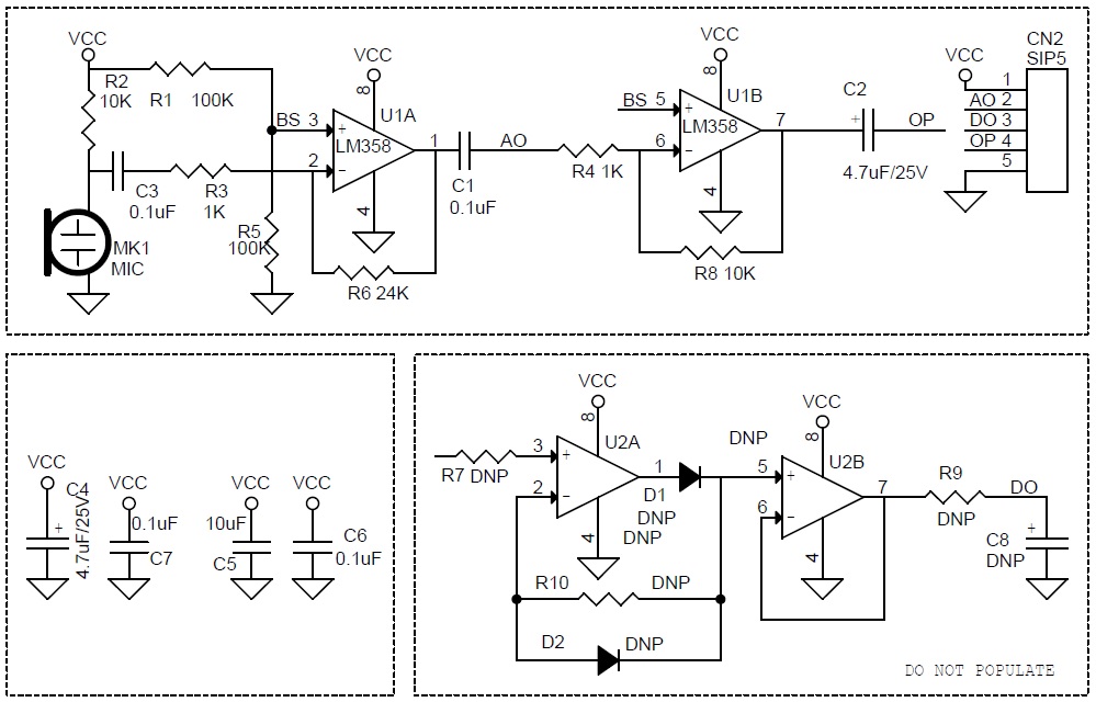

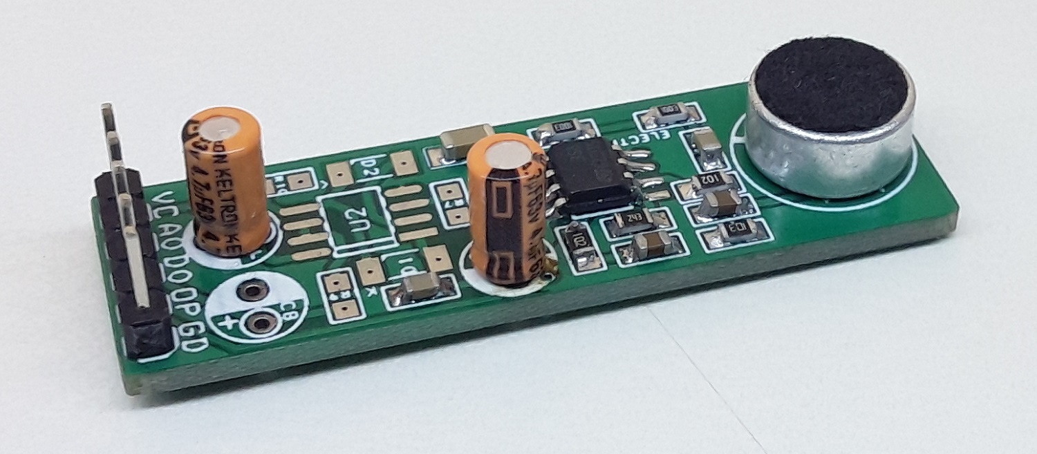

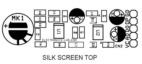

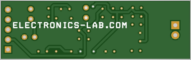

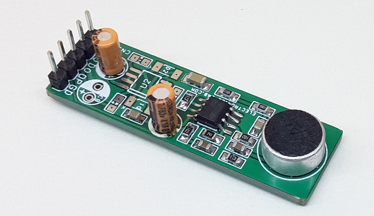

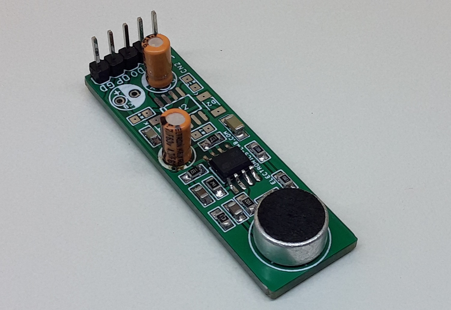

This is an easy to construct dual-stage microphone pre-amplifier. The project can be used as a sound sensor or microphone pre-amplifier.
This is an easy to construct dual-stage microphone pre-amplifier. The project can be used as a sound sensor or microphone pre-amplifier. The 1st op-amp pre-amplify the very low-level signal coming from the condenser microphone and 2nd op-amp provides more boost to the audio signal. The pre-amplifier is an important building block for many audio communication systems and sound sensors. The circuit has been built around OPAMP LM358. The output signal level is dependent on the input sound level. The maximum peak to peak output is 2Vpp.
Connections: CN1 Pin1 = VCC, Pin 2 = Low level audio signal, Pin 3 = NC, Pin 4= High level Audio Signal (it can be used for microcontroller interface)
- Power supply: 5V DC @ 10 mA
- On-Board electret condenser microphone
- Dual Stage Amplification using OPAMP LM358
- PCB dimensions: 47.31 x 14.76 mm
Schematic

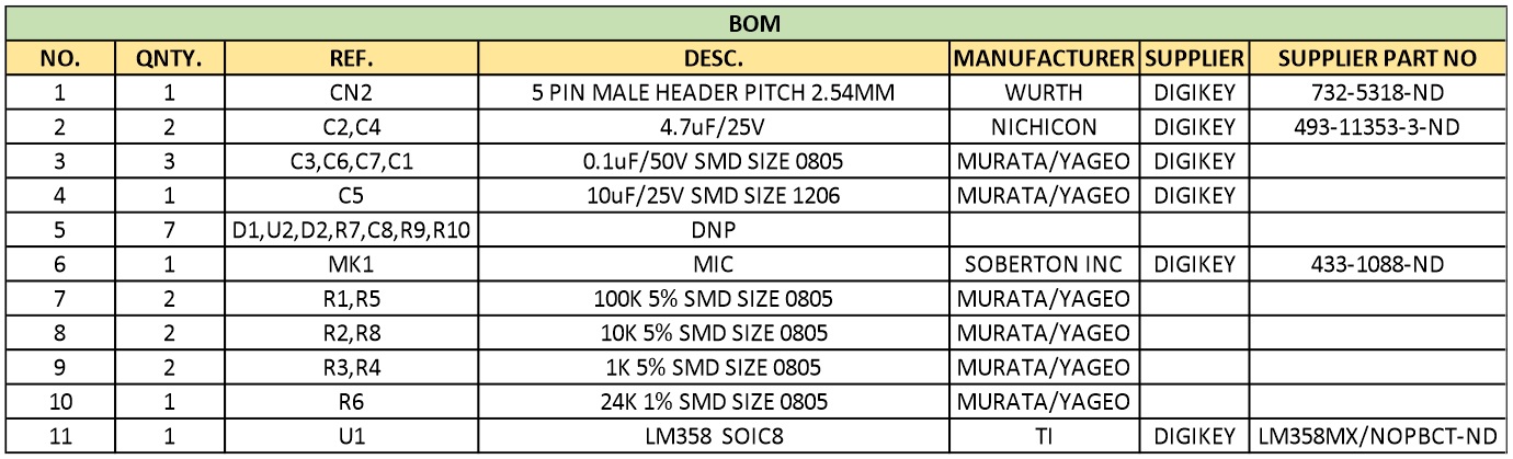

Parts List
| NO. | QNTY. | REF. | DESC. | MANUFACTURER | SUPPLIER | SUPPLIER PART NO |
| 1 | 1 | CN2 | 5 PIN MALE HEADER PITCH 2.54MM | WURTH | DIGIKEY | 732-5318-ND |
| 2 | 2 | C2,C4 | 4.7uF/25V | NICHICON | DIGIKEY | 493-11353-3-ND |
| 3 | 3 | C3,C6,C7,C1 | 0.1uF/50V SMD SIZE 0805 | MURATA/YAGEO | DIGIKEY | |
| 4 | 1 | C5 | 10uF/25V SMD SIZE 1206 | MURATA/YAGEO | DIGIKEY | |
| 5 | 7 | D1,U2,D2,R7,C8,R9,R10 | DNP | |||
| 6 | 1 | MK1 | MIC | SOBERTON INC | DIGIKEY | 433-1088-ND |
| 7 | 2 | R1,R5 | 100K 5% SMD SIZE 0805 | MURATA/YAGEO | ||
| 8 | 2 | R2,R8 | 10K 5% SMD SIZE 0805 | MURATA/YAGEO | ||
| 9 | 2 | R3,R4 | 1K 5% SMD SIZE 0805 | MURATA/YAGEO | ||
| 10 | 1 | R6 | 24K 1% SMD SIZE 0805 | MURATA/YAGEO | ||
| 11 | 1 | U1 | LM358 SOIC8 | TI | DIGIKEY | LM358MX/NOPBCT-ND |
