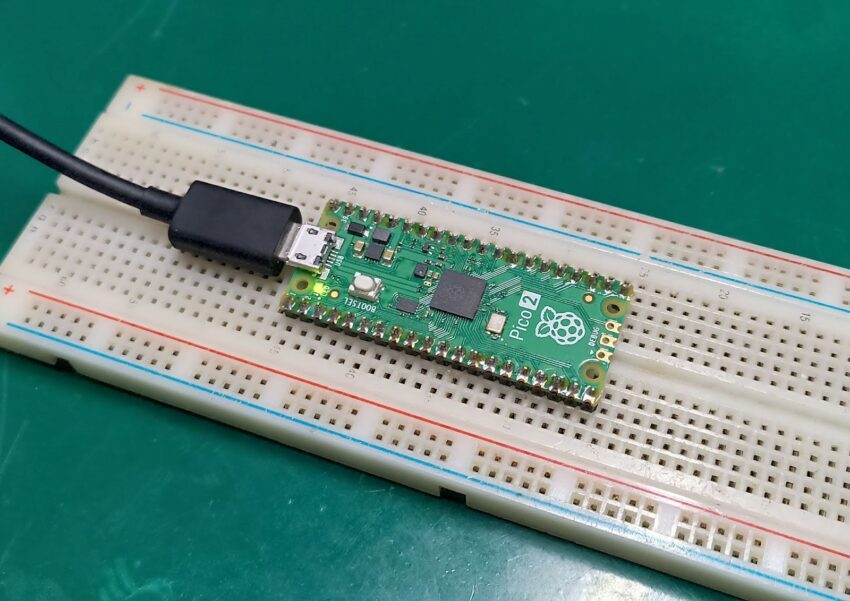

For this tutorial, I am using a Raspberry Pi Pico 2, which is based on the RP2350 chip. You could use any other microcontroller capable of running microPython, like the ESP32 for example.
Raspberry Pi Pico 2 on a breadboard
You don’t need anything else material-wise, since all we need is an LED which is already present in the Pi Pico 2. It is wired to pin 25 and is lit when the logic level written is HIGH (1). Just in case, connect your Pi Pico 2 to a breadboard (not necessary but cool), as seen in the picture above.
