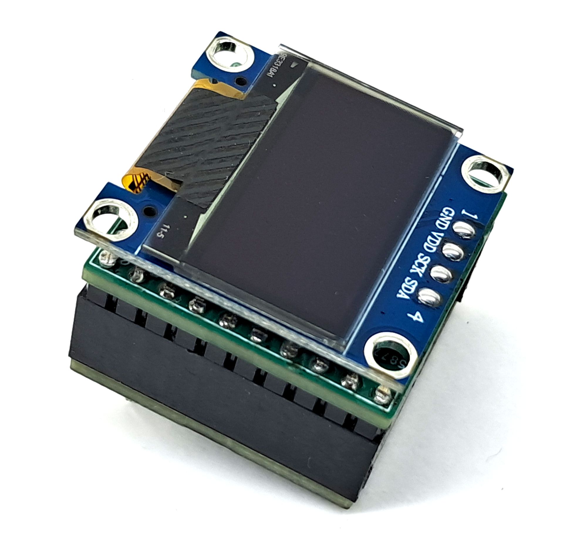

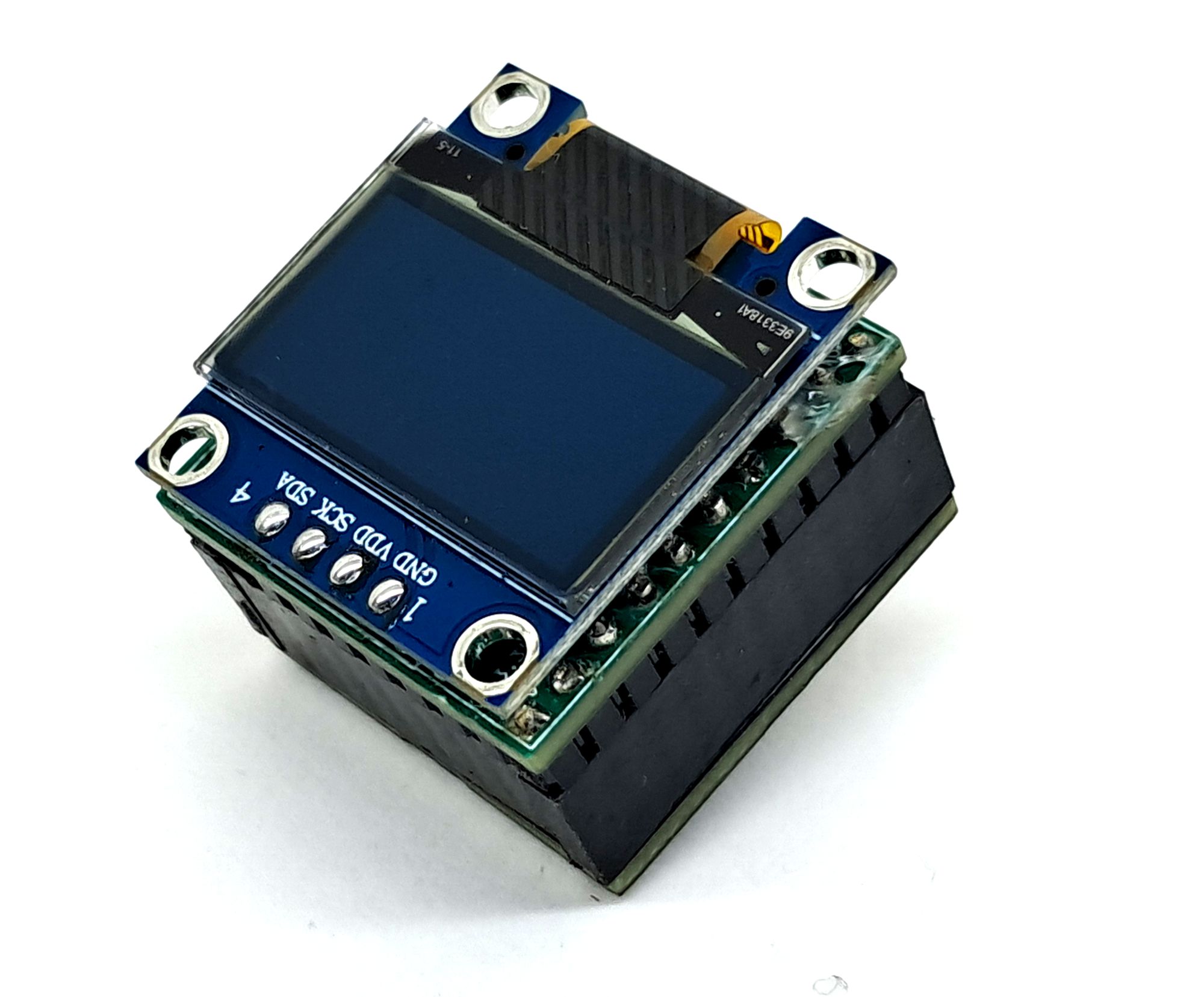

This multi-purpose motor driver shield is built around the BD60210FV motor driver IC. It is designed specifically for the OLEDUINO-V2 board, which features an onboard OLED display. This compact shield can be used to drive small bipolar stepper motors, two bidirectional brushed DC motors, and 4 solenoids.
The shield is capable of driving two brushed DC motors up to 1A continuous current with a supply voltage range of 8 V to 12 V. A key advantage of this shield is its seamless integration with the OLEDUINO-V2, allowing real-time display of speed, direction, and other operational information.

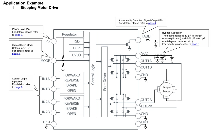

Stepper Motor Driver
The shield can drive a small bipolar stepper motor using its dual H-bridge configuration, supporting both full-step and half-step operation.

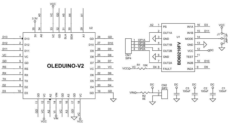

PS/Power Save Pin (Arduino A2)
The PS pin can make circuits in standby state and make motor output OPEN.
When PS = L to H, be careful because there is a delay of 40 μs (Max) before it is returned from standby state to normal state and the motor output become ACTIVE.
  • PS Pin Low = Standby
  • PS Pin High = Active

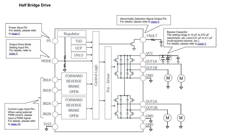

MODE/Drive Mode Setting pin (Solder Jumper J1)
This is a 3-value input pin that sets the output drive mode. Four drive modes can be set by combining the MODE and IN2A pins.
  • Mode Low + IN2A X = 4 Pins Interface Mode
  • Mode High + IN2A Low = 2 Pins Interface Mode

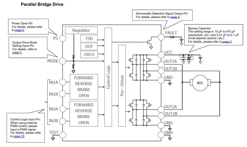

  • Mode High + IN2A High = Parallel Bridge Interface Mode
  • M(Open) + IN2A X = Half Bridge Interface Mode
FAULT/Abnormal State Detection Output Pin (Arduino D4)
If overcurrent protection (OCP) or thermal shutdown circuit (TSD) is activated, an abnormality detection signal will be output. This signal is connected to a D4 of OLEDUINO-V2 to shut down the system. The output format of this pin is open drain which is pulled up using R1 (10K Ohm) resistor and connected toD4 of OLEDUINO-V2. Protect Function (OCP or TSD), Normally this pin is high, goes low at event of OCP or TSD.

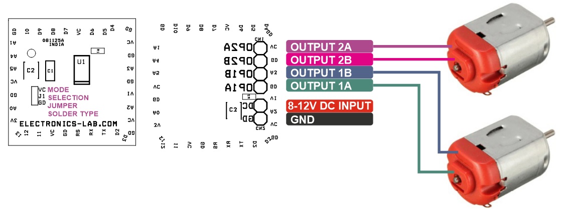

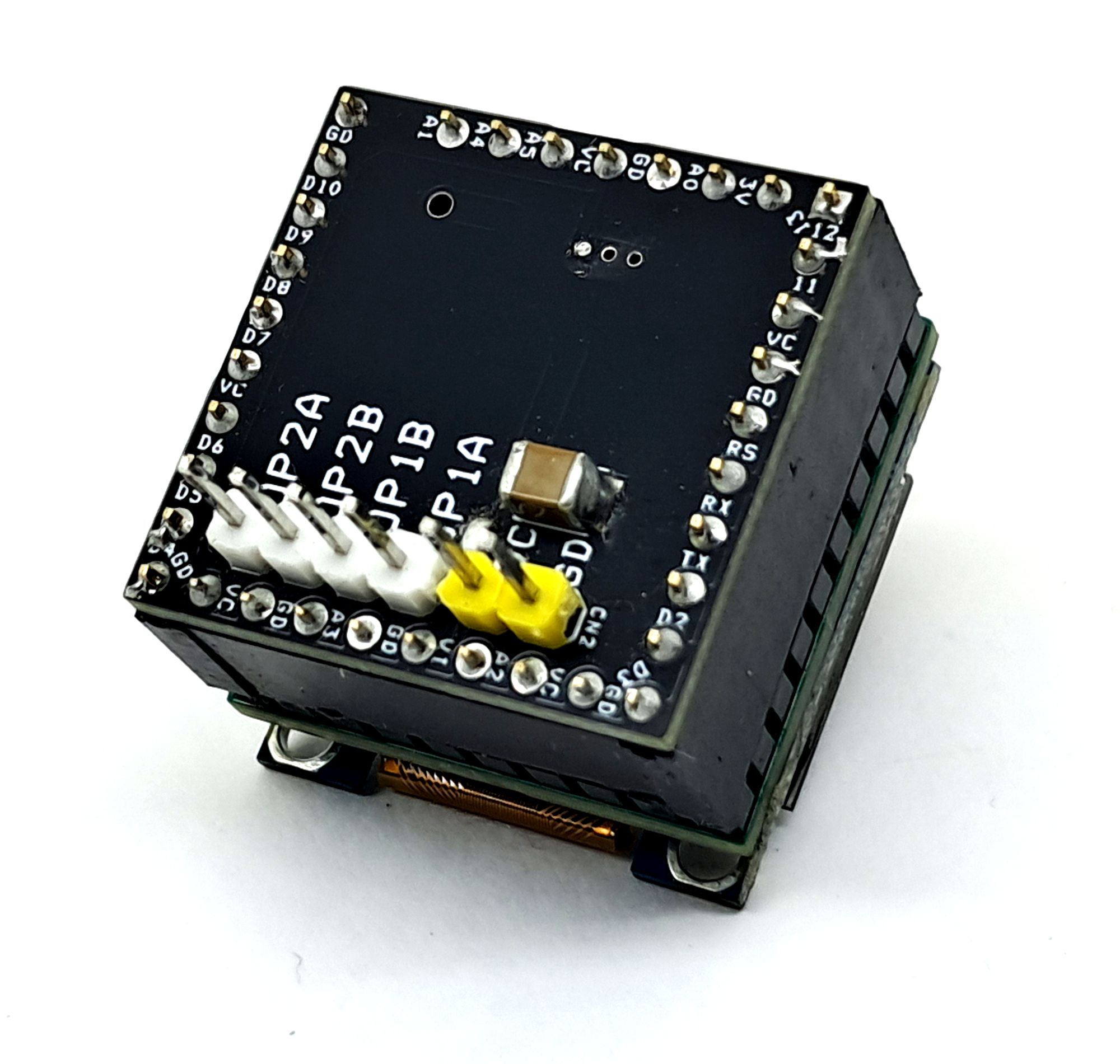

Connections
  • CN1: Pin 1 = Output 1A, Pin 2 = Output 1B, Pin 3 = Output 2B, Pin 4 = Output 2A
  • CN2: Pin 1 = 8V to 12V DC Power, Pin 2 = GND
  • J1: Solder Type Jumper for Mode Selection
Schematic

Connections

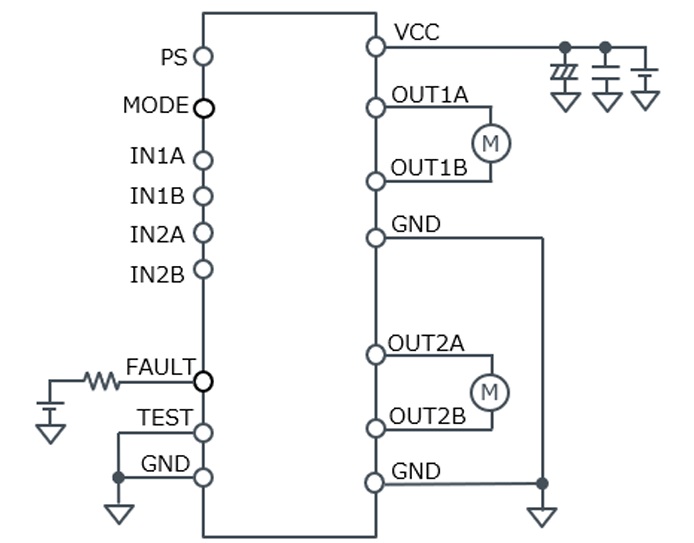

Application Diagram

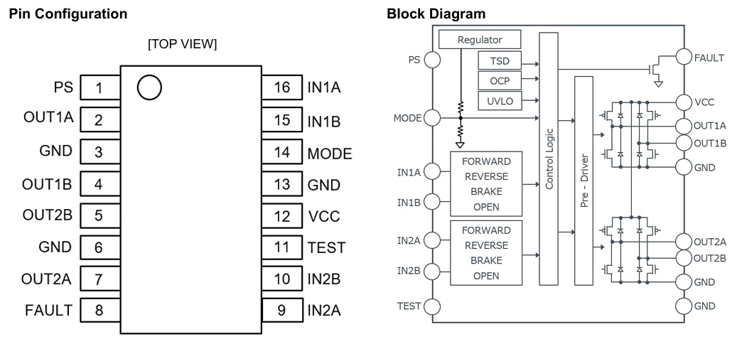

BD60210FV Block Diagram & Pin Configuration
Half Bridge Diagram
Parallel Bridge Diagram

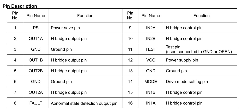

Pinout Description
Stepper Motor Drive Example Diagram

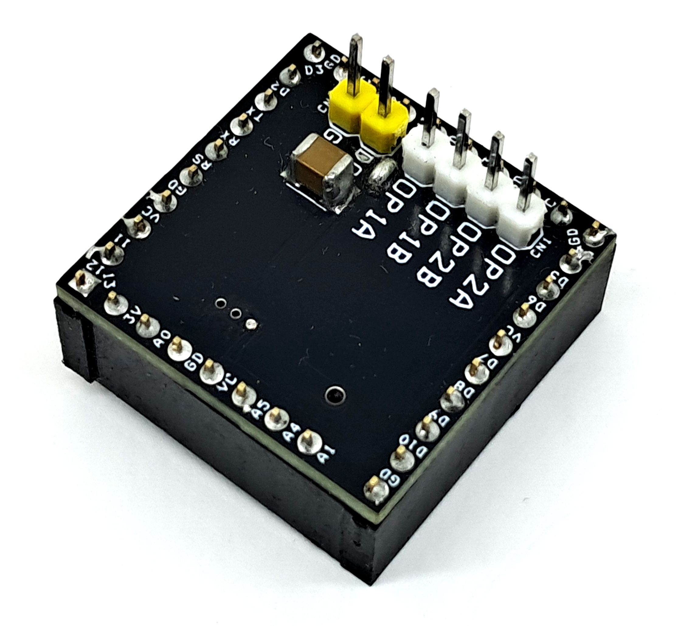

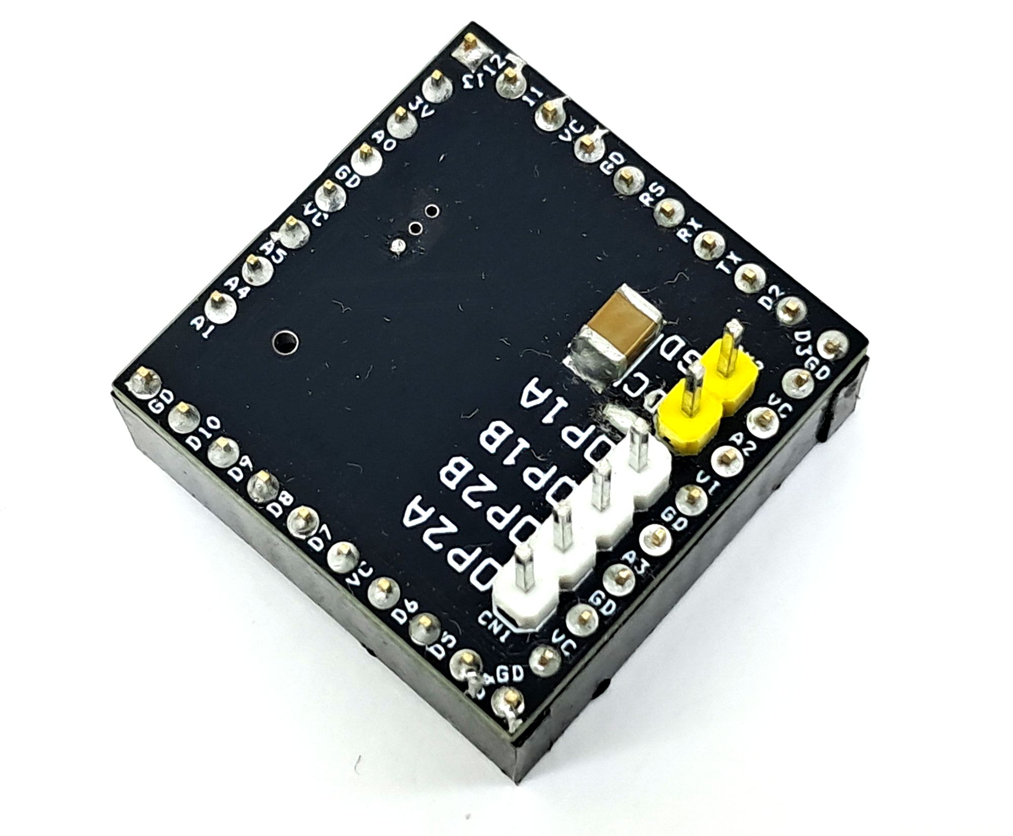

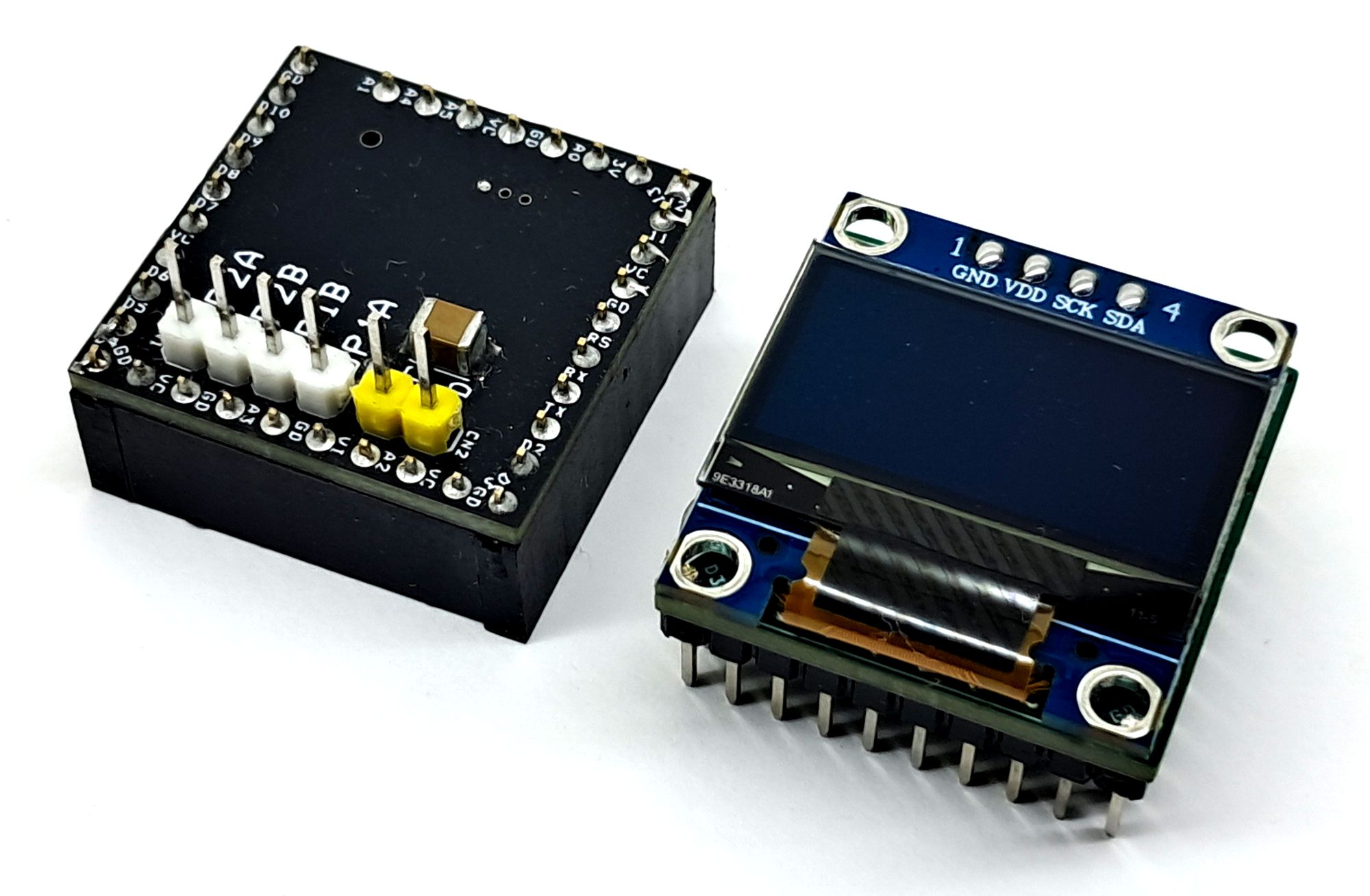

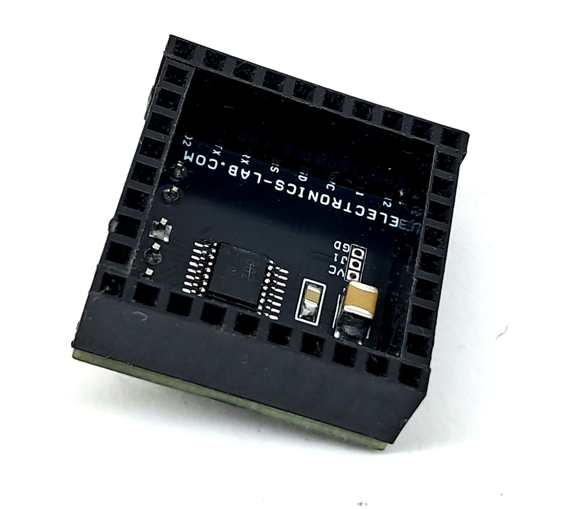

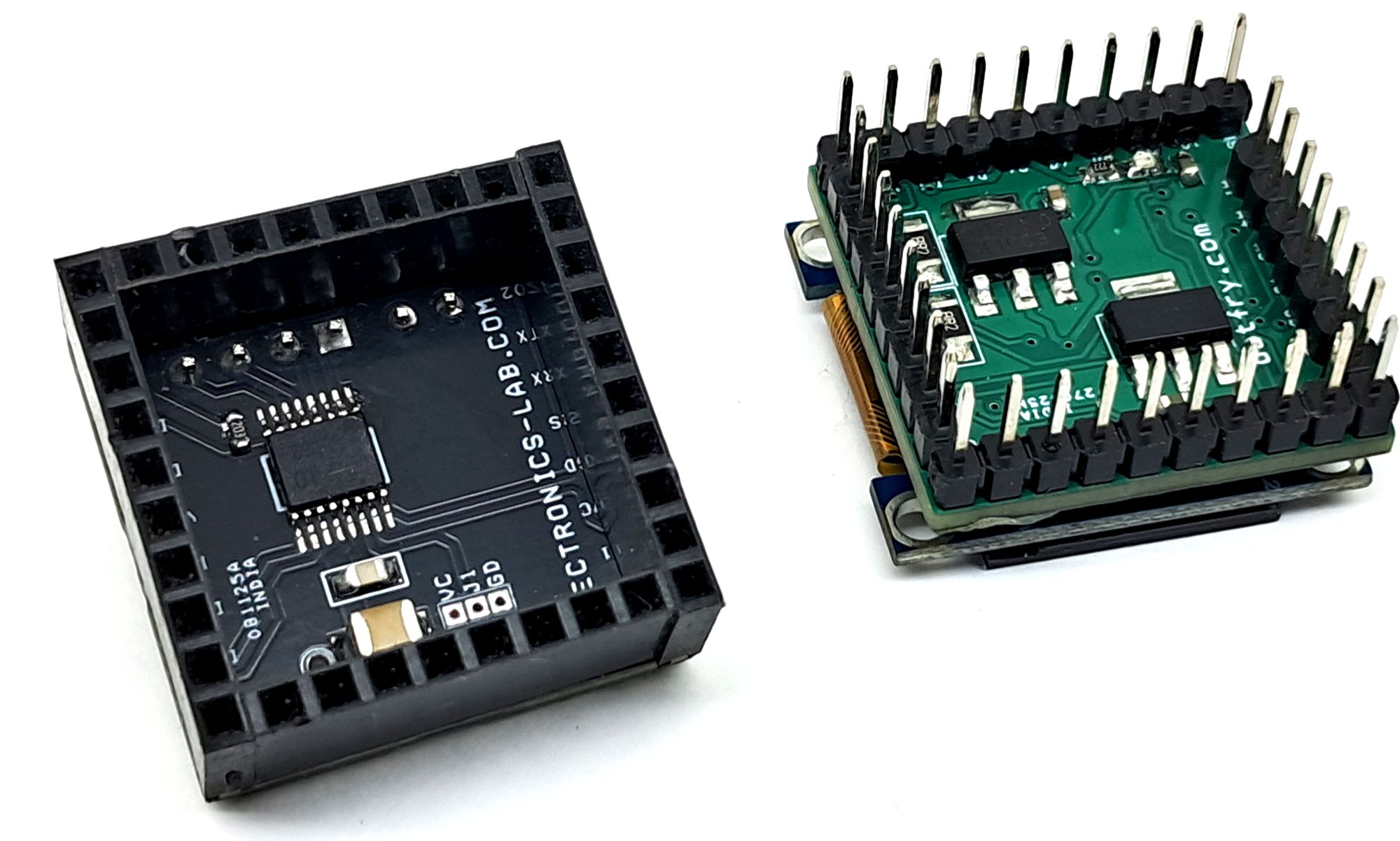

Photos
