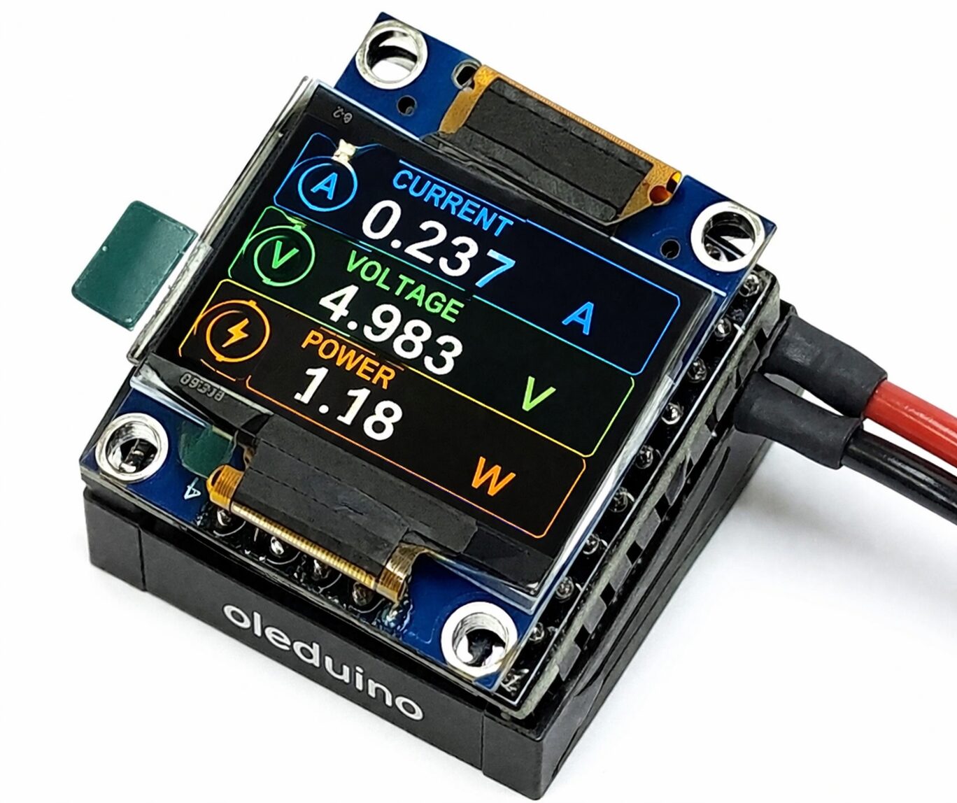

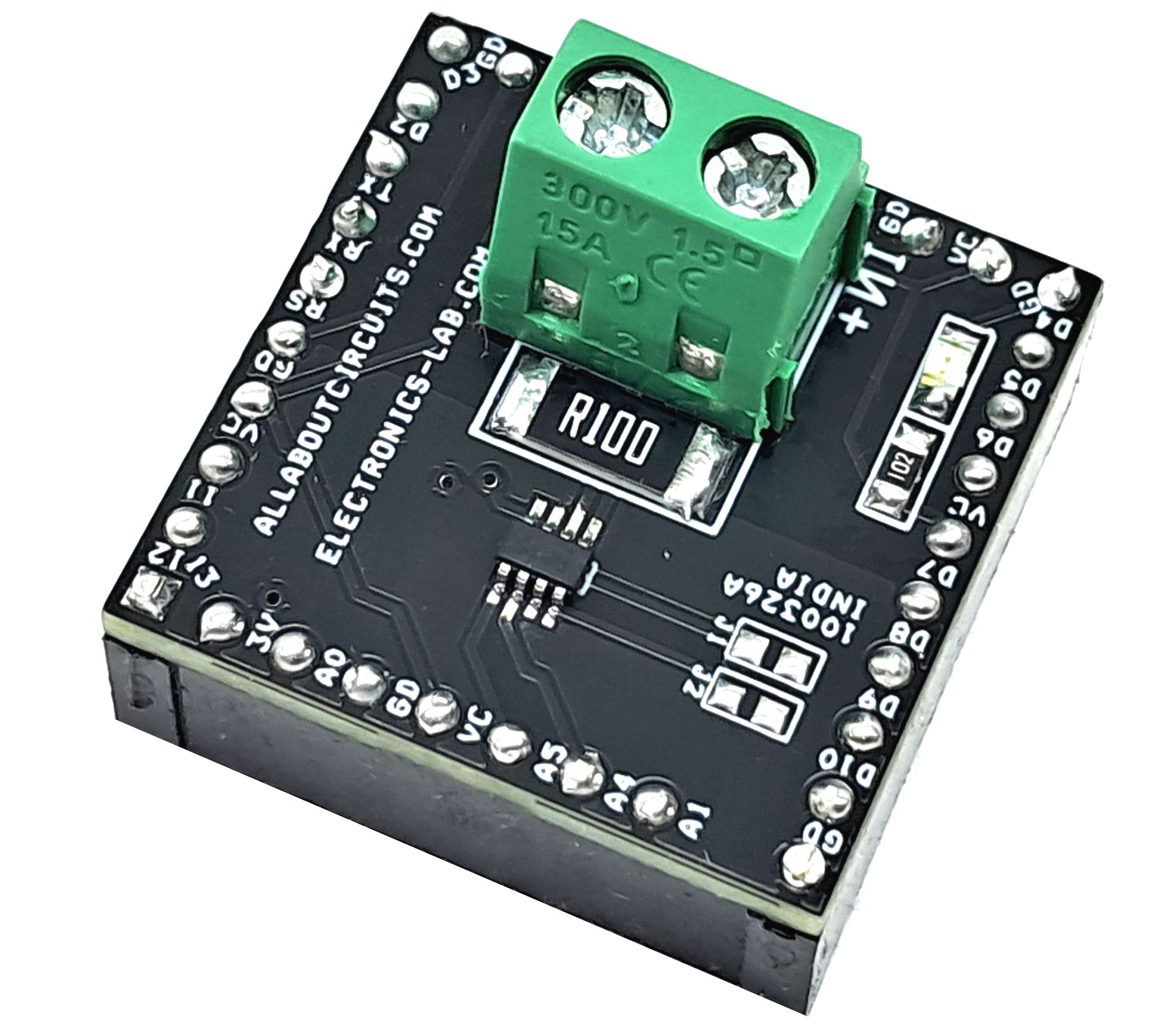

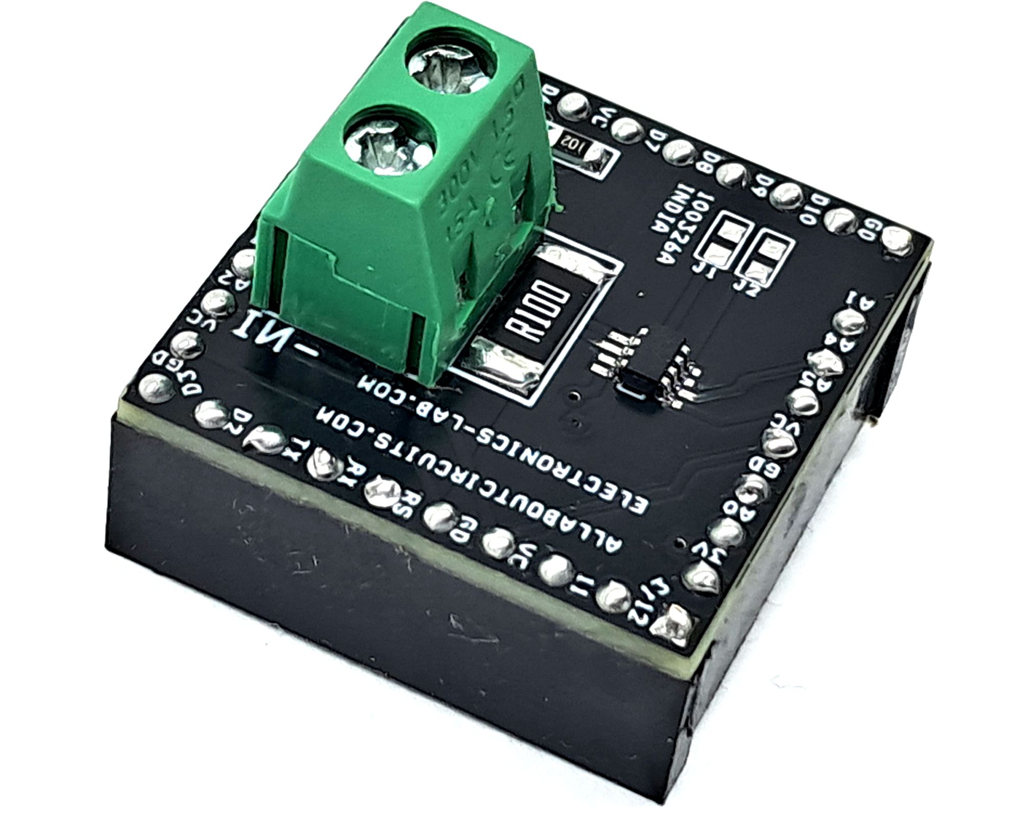

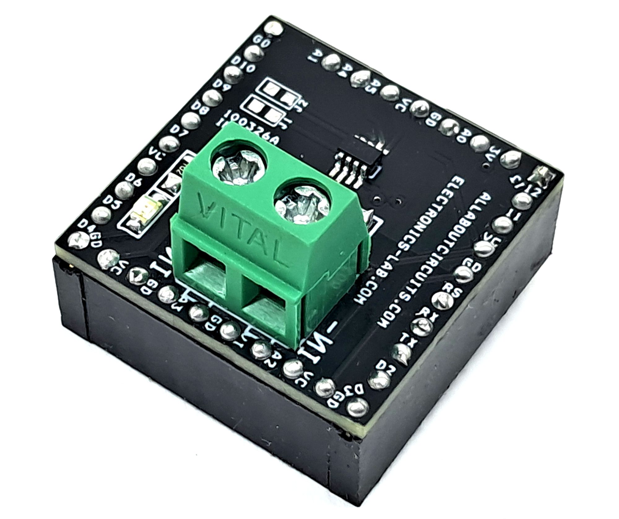

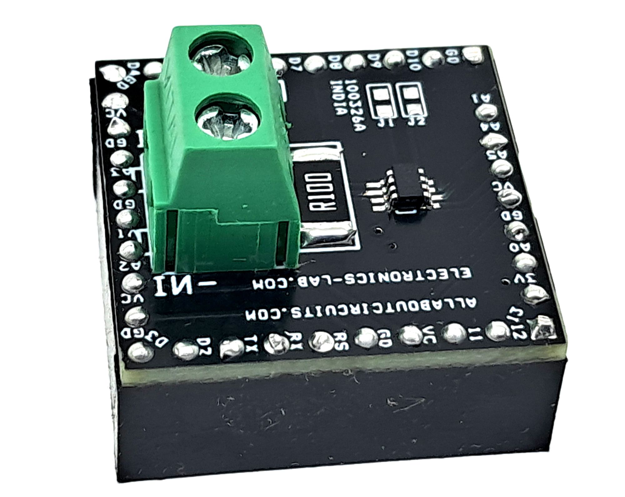

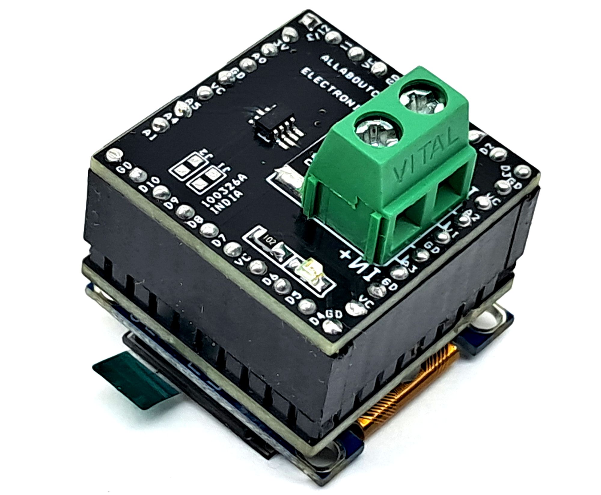

Mini Power Monitor Shield for OLEDUINO v2 using INA219
INA219 Monitor Shield: Compact OLEDUINO-v2 add-on. Measures load current, bus voltage, and power via screw terminals.

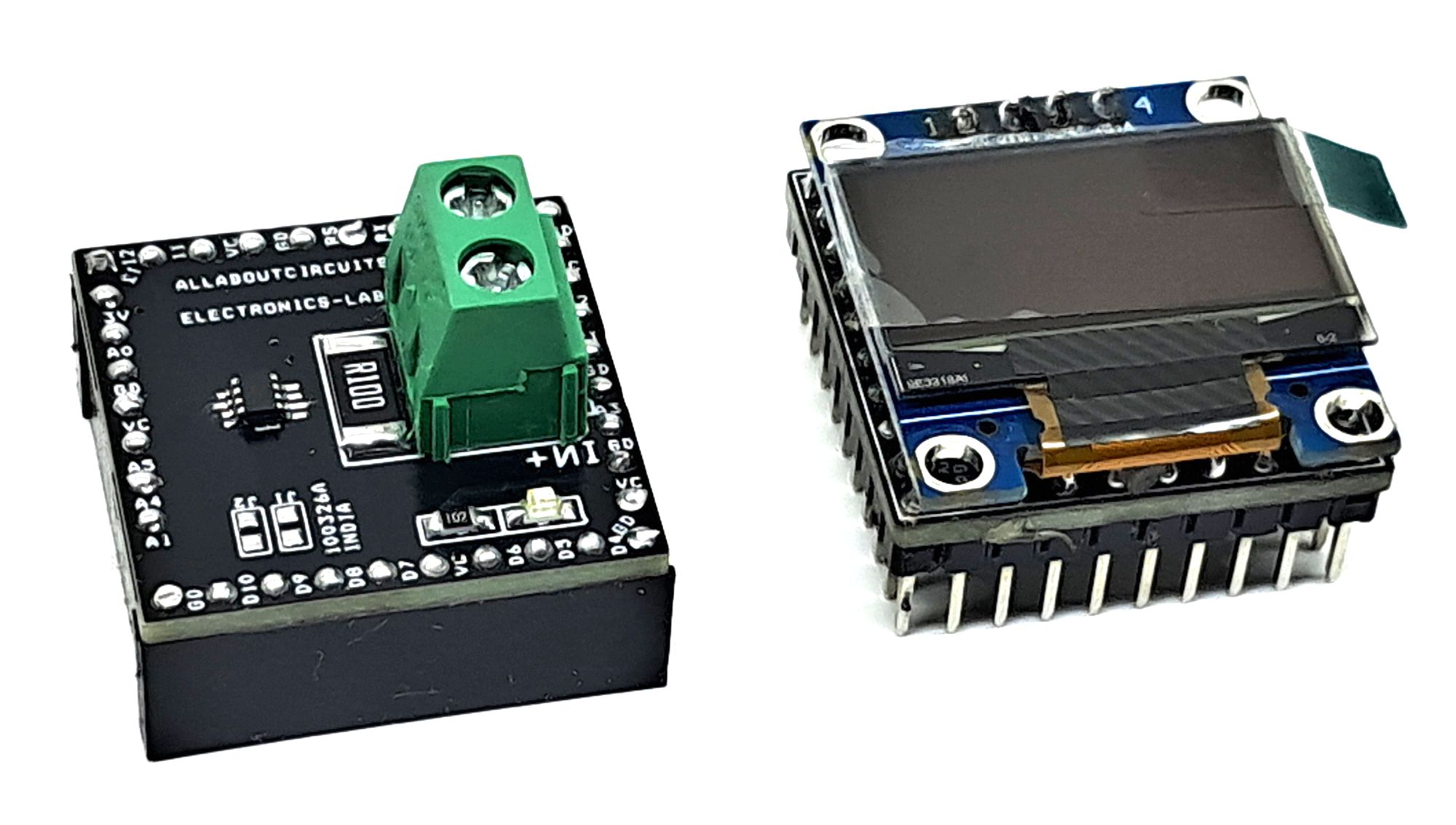

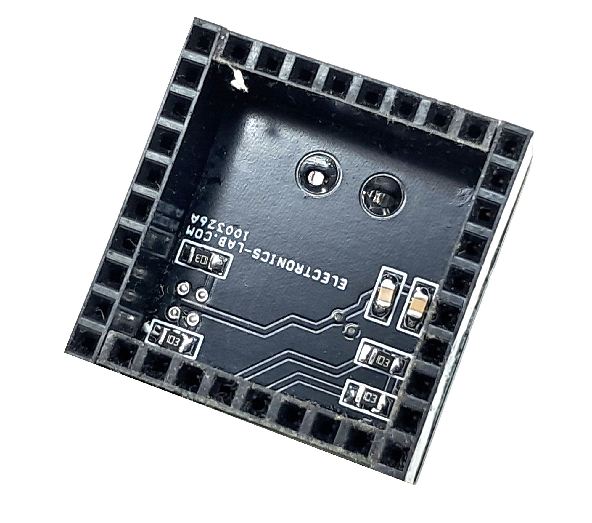

This is a compact bidirectional current and power monitor shield designed for the OLEDUINO-v2. The shield is built around the INA219 chip and includes screw terminals for easy connection of the load, allowing accurate measurement of current, bus voltage, and power.

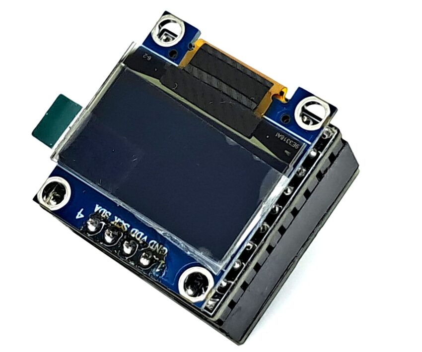

The shield can be mounted on the back side of the OLEDUINO-V2, creating a very compact current and power monitoring solution. The INA219 communicates using the I²C protocol, making integration simple and efficient.

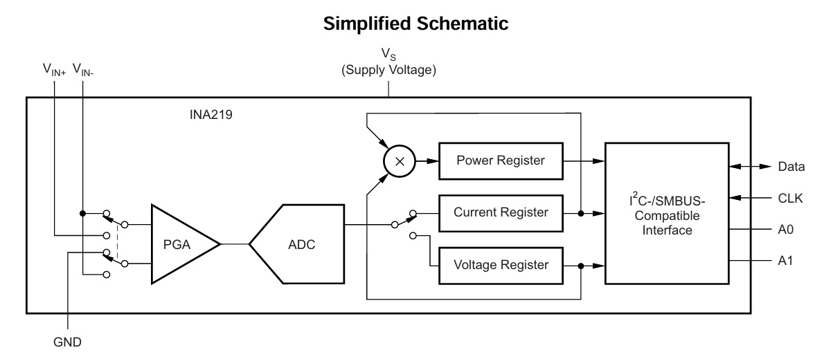

The INA219 is a current shunt and power monitor with an I²C- or SMBus-compatible interface. It measures both the voltage drop across the shunt resistor and the bus supply voltage. The device features programmable conversion times and filtering options for improved measurement accuracy.
A programmable calibration register, combined with an internal multiplier, enables direct current readings in amperes. Additionally, an internal power calculation register provides power readings in watts. The interface supports up to 16 programmable addresses, allowing multiple devices on the same bus.

Key Features
- Shield Power 5V DC
- Measures bus voltages from 0 to 26 V
- Measures Current +/- 3.2A (0.8mA Resolution)
- Reports current, voltage, and power
- 16 programmable I²C addresses
- High accuracy: up to 0.5% (maximum) over temperature (INA219B)
- Configurable filtering options
- Programmable calibration registers
- On Board Power LED
- PCB Dimensions 25.4 x 25.4 mm

PGA Function
If larger full-scale shunt voltages are desired, the INA219 provides a PGA function that increases the full-scale range up to 2, 4, or 8 times (320 mV). Additionally, the bus voltage measurement has two full-scale ranges: 16 or 32 V.
Programming
An important aspect of the INA219 device is that it measures current or power if it is programmed based on the system. The device measures both the differential voltage applied between the IN+ and IN- input pins and the voltage at IN- pin. In order for the device to report both current and power values, the user must program the resolution of the Current Register (04h) and the value of the shunt resistor (RSHUNT) present in the application to develop the differential voltage applied between the input pins. Both the Currents and shunt resistor value are used in the calculation of the Calibration Register value that the device uses to calculate the corresponding current and power values based on the measured shunt and bus voltages. After programming the Calibration Register, the Current Register (04h) and Power Register (03h) update accordingly based on the corresponding shunt voltage and bus voltage measurements. Until the Calibration Register is programmed, the Current Register (04h) and Power Register (03h) remain at zero.

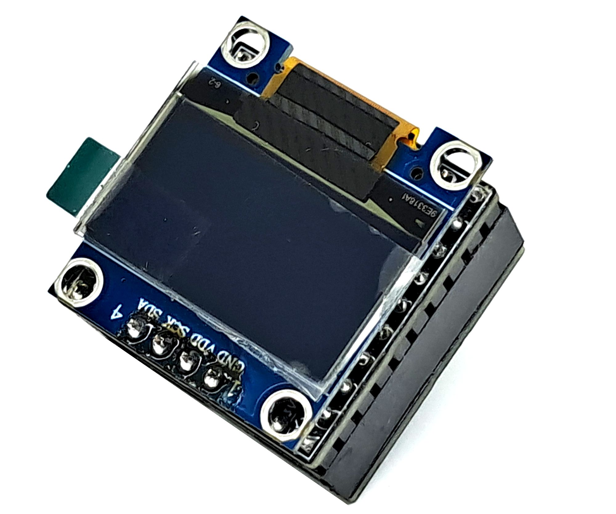

INA219/OLED Display Pins VS Arduino (OLEDUINO-V2) Pins
- INA219 SDA = Arduino (OLEDUINO-V2) A4
- INA219 SCL = Arduino (OLEDUINO-V2) A5
- OLEDUINO-V2 SDA = Arduino (OLEDUINO-V2) A4
- OLEDUINO-V2 SCL = Arduino (OLEDUINO-V2) A5

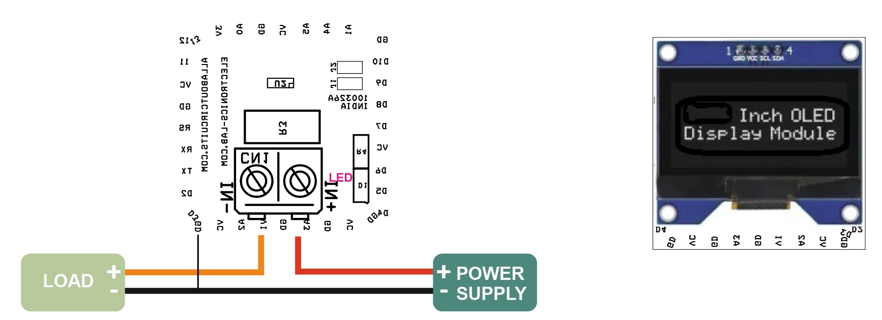

Connections
- CN1: Pin 1 = Load IN+, Pin 2 = Load IN-
- Jumper J1: I2C Address
- Jumper J2: I2C Address
- D1: Power LED

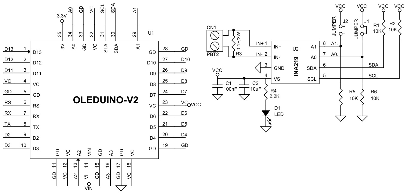

Schematic
Parts List
| NO. | QNTY. | REF. | DESC | MANUFACTURER | SUPPLIER | SUPPLIER PART NO |
| 1 | 1 | CN1 | 2 PIN SCREW TERMINAL PITCH 5.08MM | PHOENIX | DIGIKEY | 277-1247-ND |
| 2 | 1 | C1 | 100nF/50V CERAMIC SMD SIZE 0805 | YAGEO/MURATA | DIGIKEY | |
| 3 | 1 | C2 | 10uF/25V CERAMIC SMD SIZE 0805 | YAGEO/MURATA | DIGIKEY | |
| 4 | 1 | D1 | LED RED SMD SIZE 0805 | OSRAM | DIGIKEY | 475-1278-1-ND |
| 5 | 2 | J1,J2 | JUMPER PCB SOLDER | |||
| 6 | 4 | R1,R2,R5,R6 | 10K 5% SMD SIZE 0805 | YAGEO/MURATA | DIGIKEY | |
| 7 | 1 | R3 | 0.1E/3W 1% SMD SIZE 2512 | BOURNS | DIGIKEY | CRA2512-FZ-R100ELFCT-ND |
| 8 | 1 | R4 | 2.2K 5% SMD SIZE 0805 | YAGEO/MURATA | DIGIKEY | |
| 9 | 1 | U1 | OLEDUINO-V2 | EL | DIGIKEY | |
| 10 | 1 | U2 | INA219 | TI | DIGIKEY | 296-46420-1-ND |
| 11 | 2 | CN2 | 8 PIN MALE HEADER PITCH 2.54MM | WURTH | DIGIKEY | 732-5321-ND |
| 12 | 2 | CN3 | 10 PIN MALE HEADER PITCH 2.54MM | WURTH | DIGIKEY | 732-2670-ND |

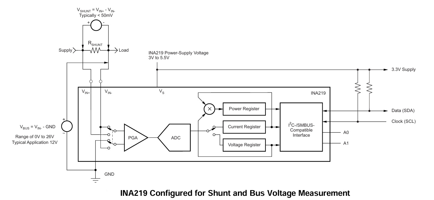

Application Diagram
INA219 Block Diagram
