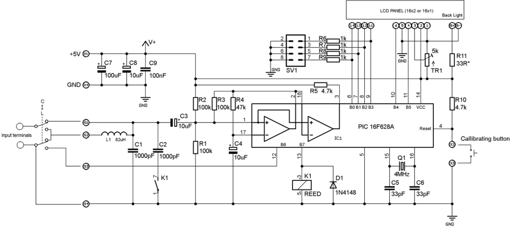

Here is my adaptation of the schematic:
I removed the 7805 regulator, because I decided to use a 5V adapter from Sony mobile phone.

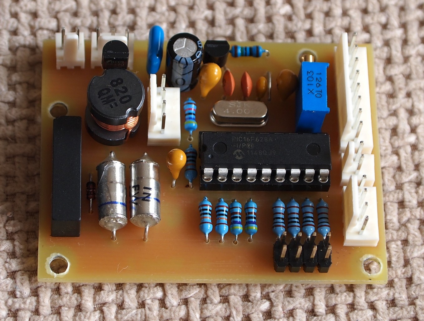

In the schematic, trimmer-potentiometer is 5k, but actually I put 10k, after consulting with the datasheet of the LCD module I bought. All three 10uF capacitors are tantalum and C7 – 100uF actually is 1000uF. Two 1000pF capacitors are styroflex 1% and inductor is 82uH. Total consumption (with back light) of the device is 30mA.
R11 limits the back light current and must be calculated according to the actual LCD module used.

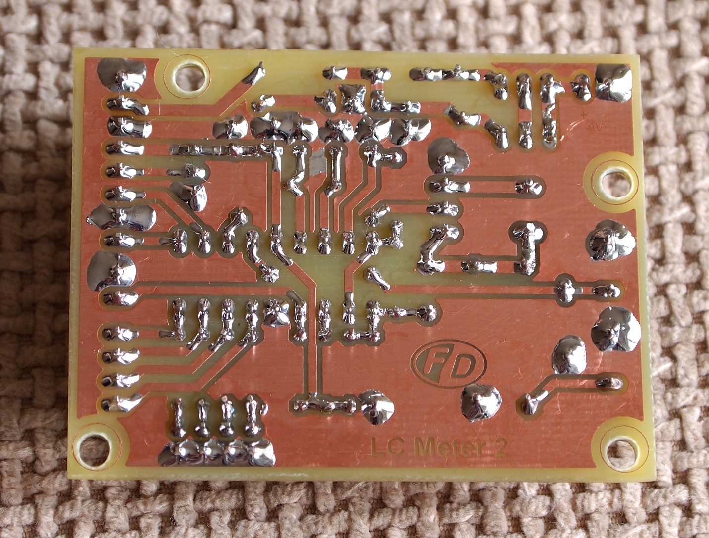

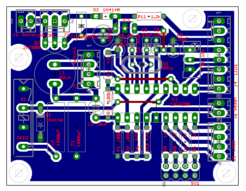

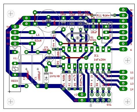

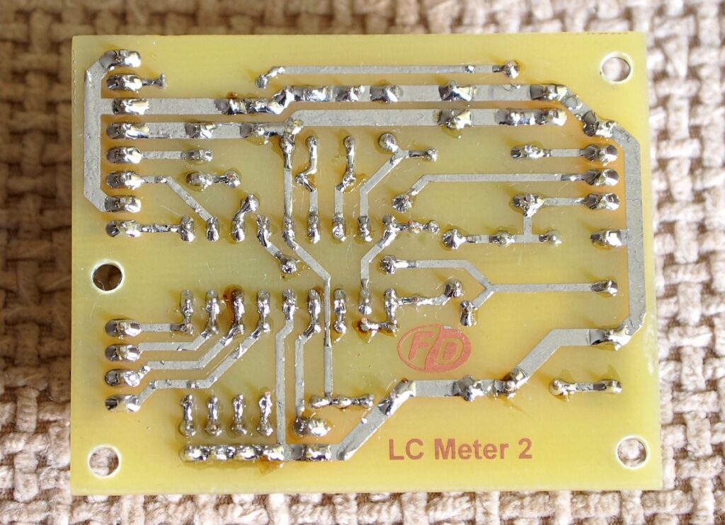

I used the original PCB as a starting point and modified it to suit better to my components.

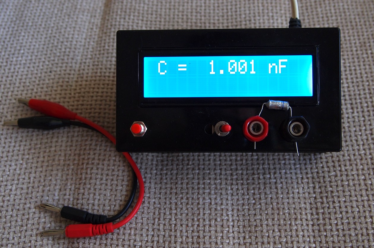

Here is the result:

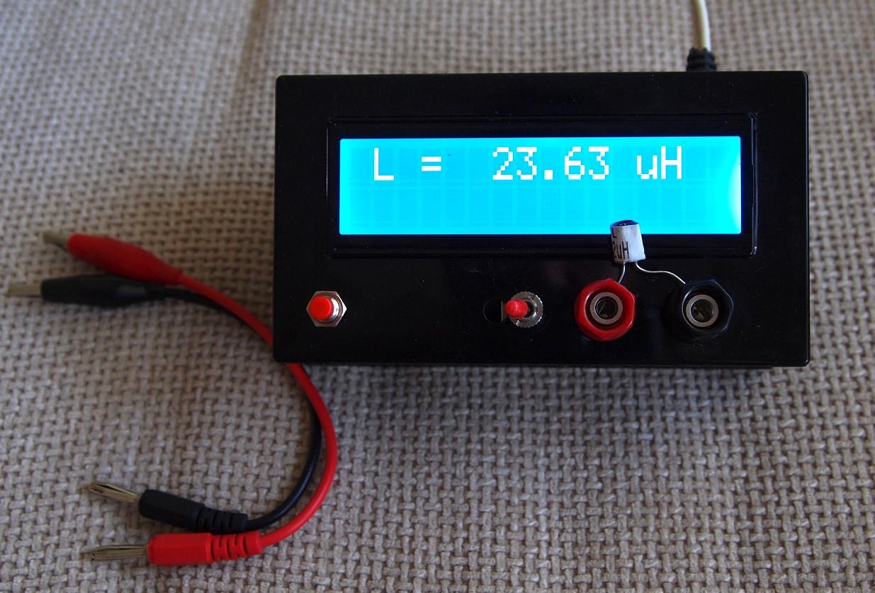

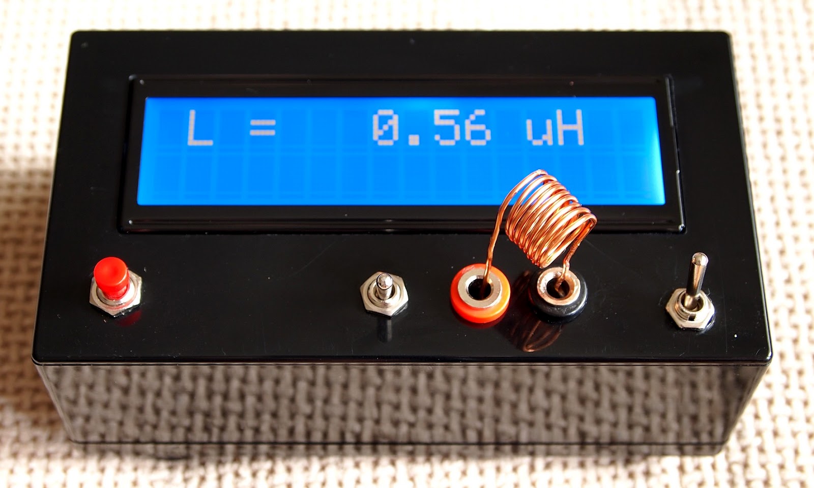

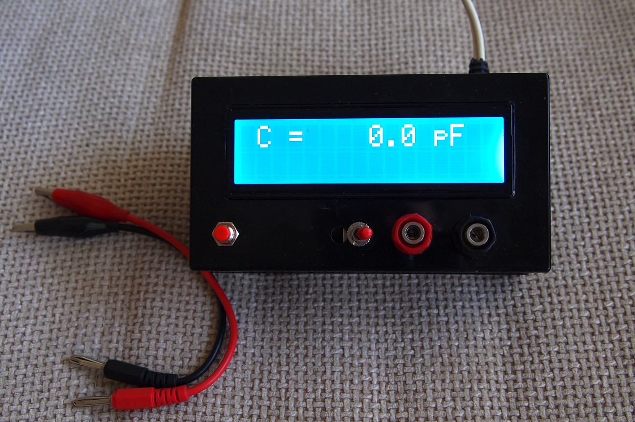

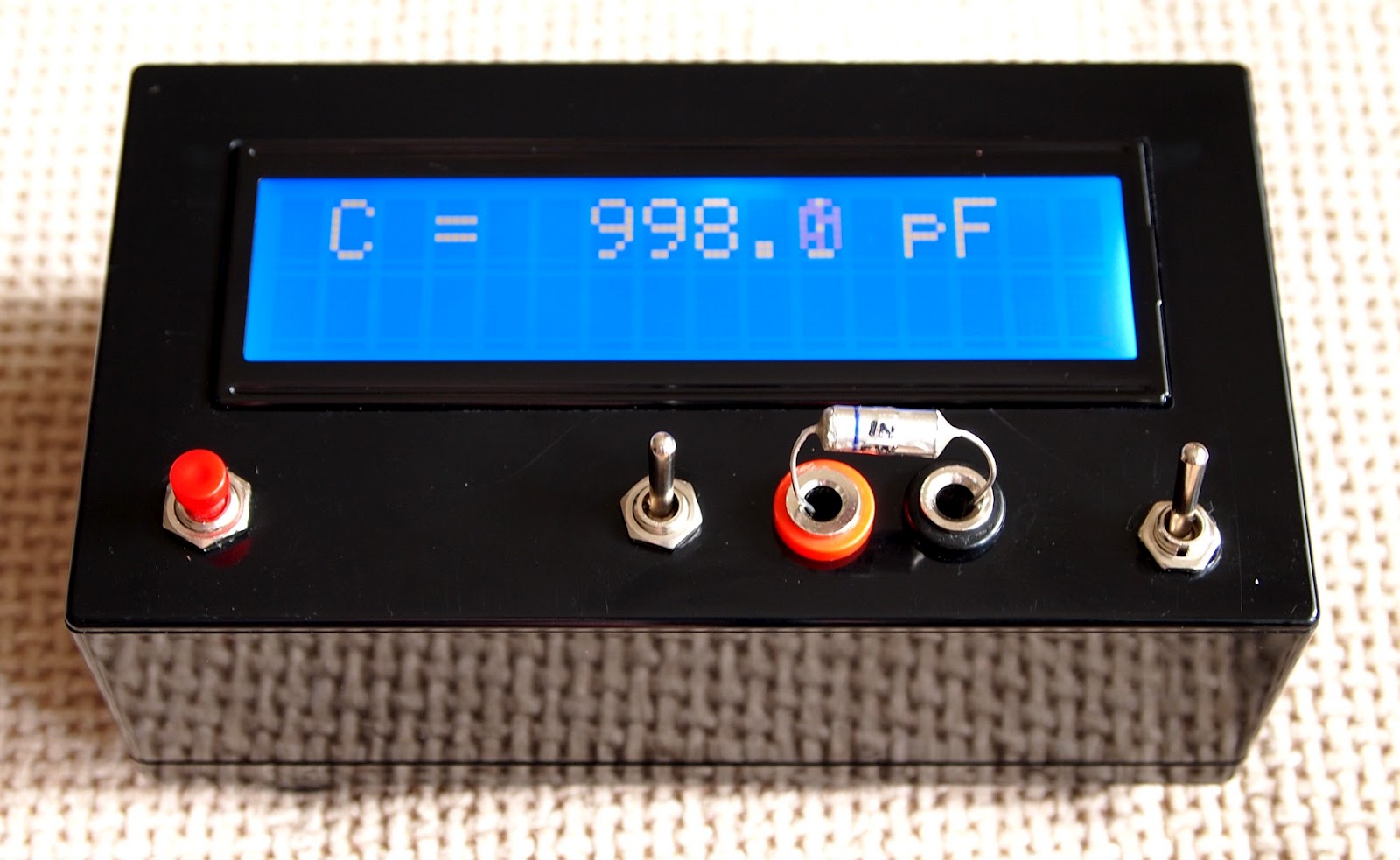

The last two pictures shows LC meter in action. In the first of them, there is 1nF/1% capacitor and in the second – 22uH/10% inductor. The device is very sensitive – when I put the test leads there is 3-5 pF reading on display, but it is eliminated with the calibrating button.

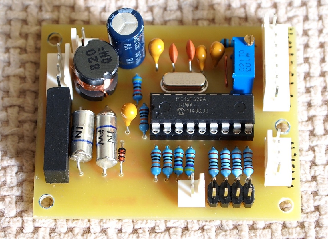

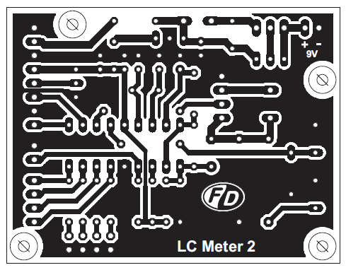

One of my colleagues in a Bulgarian audio forum ask me to build him a copy of the LC meter, but this time with 9V battery power supply. I made a new PCB with little rearrangement of the old one and adding a 78L05 voltage regulator.
I also added an automatic sleep mode, schematic of which I found here:http://www.marc.org.au/marc_proj_switch.html
The goal here was to make power consumption as low as possible. With increasing the value of R11 to 1.2kOhm which control the back light current, total current of the device was decreased to 11-12mA. Without back light at all the power consumption will be decreased even further, but the visibility suffers greatly.
After some tests, the value of the C10, which defines the ON time, was chosen to be 680nF. The ON time in this case is 10-11 min. The MOSFET Q2 may be replaced with BS170, but bear in mind that the leads are in reverse order.
ON-OFF switch is momentary non lock type.

The reed you use is replay? How many pin does it have? In Schematic I see It has 2 pins. But, anyway I has 4 pins in PCB, what’s wrong?
The reed relay K1 controls switch K1, so actually it has 4 pins.

Sir is reed relay a solid state relay
No, reed relay is a relay that uses magnetic field to control it’s state.
I had success using a reed relay 5V, SIP 1A05 (Pan-Chang) from eBay.
what did you do with two other relay legs
You just have to connect the coil contacts and the Normal Open contacts. No other connections are needed.

can we use 82uh resistor like inductor ?
no you can’t use a resistor in place of an inductor. You can use an inductor of 82uH that may look like a resistor from the outside.
sorry for my English. i tried to say can we use 82uh inductor looks like a resistor.
as i understand from your reply i can use it right?
thank you very much
Yes, an inductor can look like a resistor.
