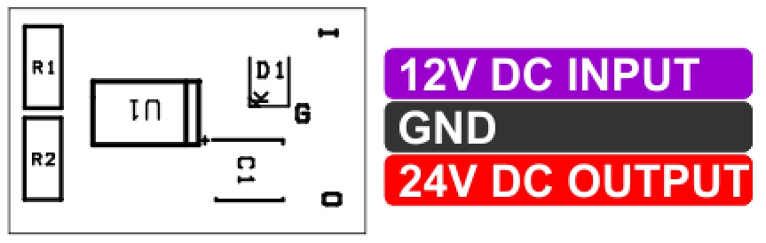

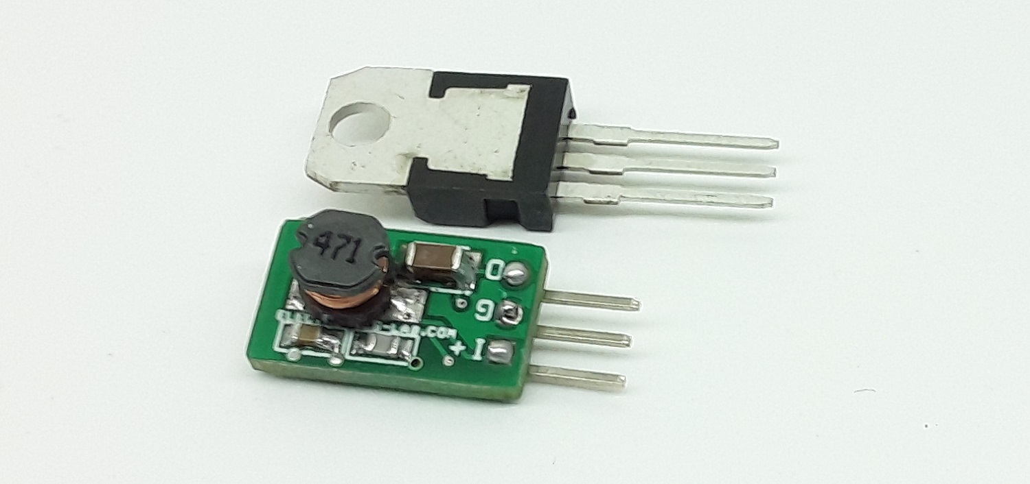

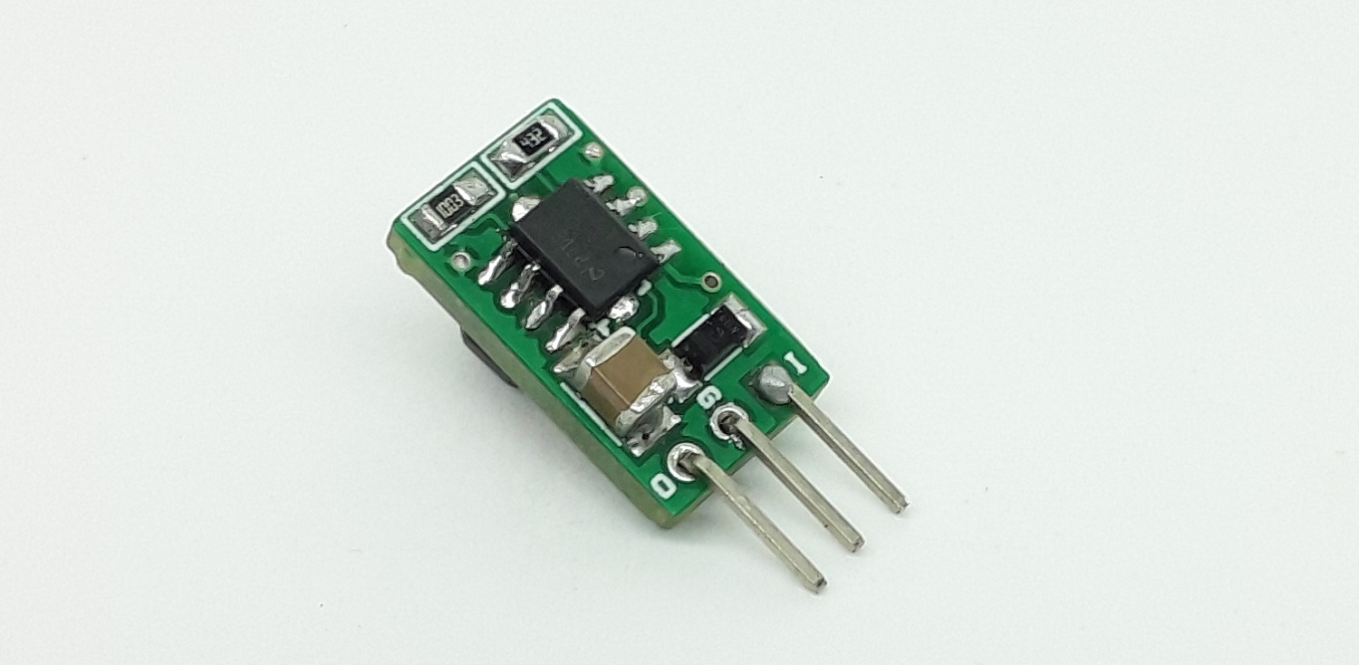

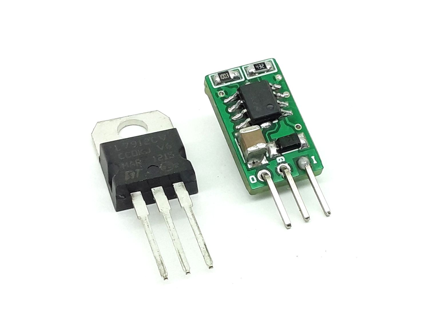

The project demonstrated here is a small-size solution, high-efficiency, low-cost, and low-EMI step-up DC/DC module for LDO regulator replacement. This small size module helps save on solution size and cost while also eliminating the need for a heatsink.

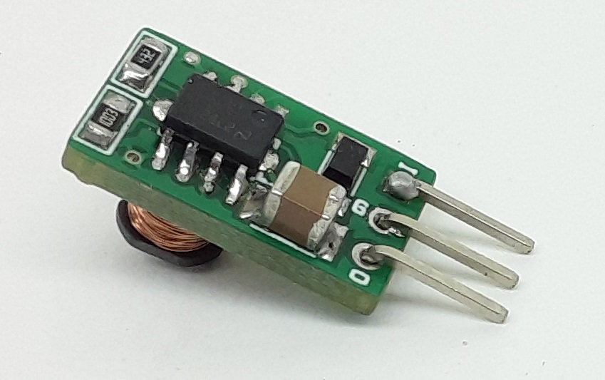

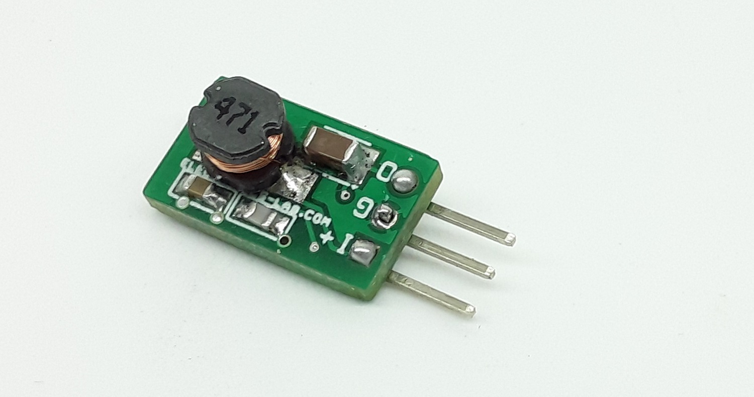

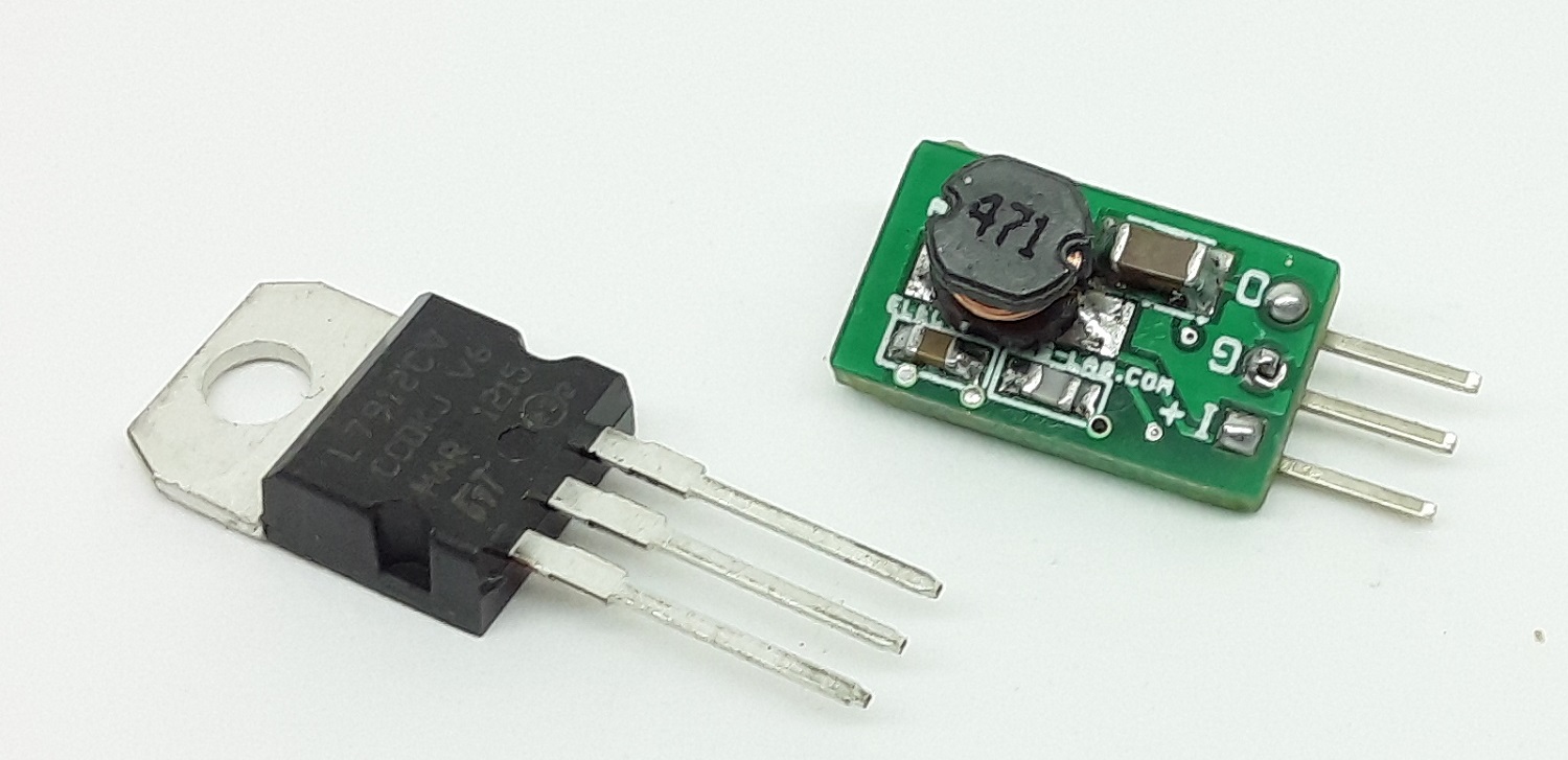

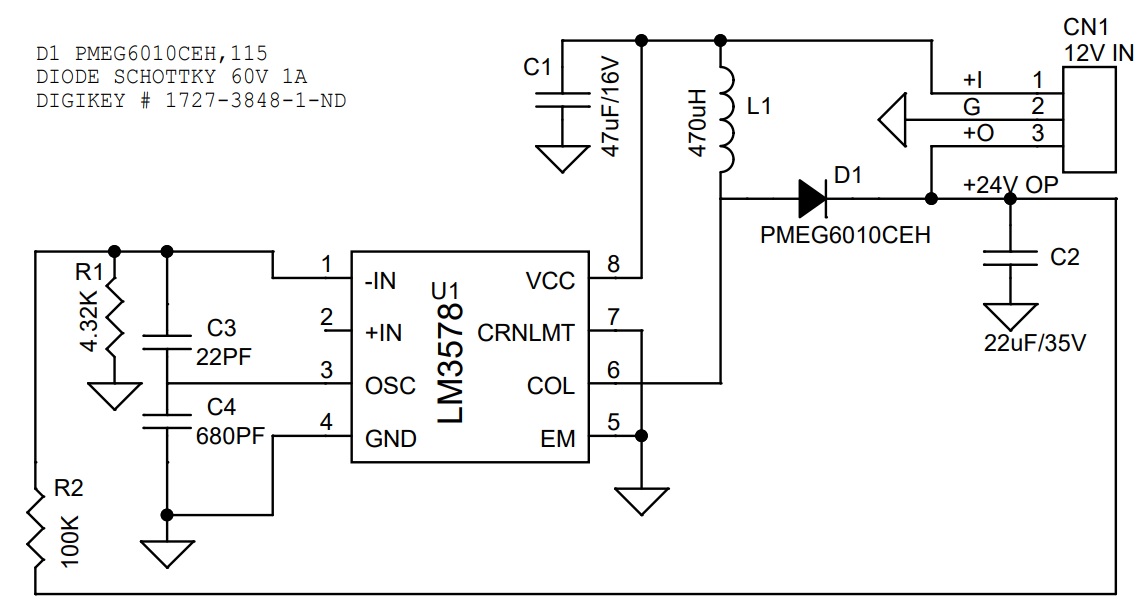

The project demonstrated here is a small-size solution, high-efficiency, low-cost, and low-EMI step-up DC/DC module for LDO regulator replacement. This small size module helps save on solution size and cost while also eliminating the need for a heatsink. The module takes up the same amount of space as a TO-220 package and is pin-to-pin compatible with TO-220 regulators, such as LM7805. The project is based on LM3578, which is a switching regulator that can easily be set up for such DC-to-DC voltage conversion circuits as the buck, boost, and inverting configurations. In this board, the chip is configured as a boost converter. Switching frequency sets at 100Khz. The project provides 24V output from 12V input. The project can output up to 20mA of current but it is safe to draw continuous 10mA.
- Input Voltage VIN = 12V DC
- Output Voltage VOUT = 24V DC
- Load Current 10mA
- Switching Frequency 100Khz
- 3 Pin Header Connector for Input and Output
- Pin to Pin Compatible as LM7805
- Output Ripple 60mV

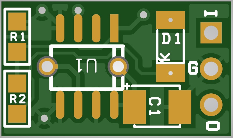

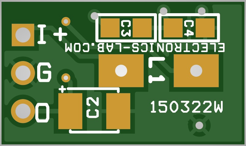

- PCB Dimensions 16.19 x 9.53 mm
Schematic

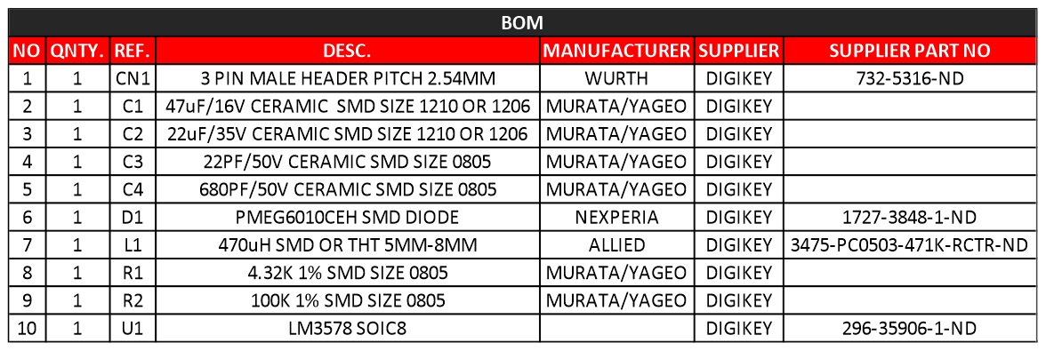

Parts List
| NO | QNTY. | REF. | DESC. | MANUFACTURER | SUPPLIER | PART NO |
| 1 | 1 | CN1 | 3 PIN MALE HEADER PITCH 2.54MM | WURTH | DIGIKEY | 732-5316-ND |
| 2 | 1 | C1 | 47uF/16V CERAMIC SMD SIZE 1210 OR 1206 | MURATA/YAGEO | DIGIKEY | |
| 3 | 1 | C2 | 22uF/35V CERAMIC SMD SIZE 1210 OR 1206 | MURATA/YAGEO | DIGIKEY | |
| 4 | 1 | C3 | 22PF/50V CERAMIC SMD SIZE 0805 | MURATA/YAGEO | DIGIKEY | |
| 5 | 1 | C4 | 680PF/50V CERAMIC SMD SIZE 0805 | MURATA/YAGEO | DIGIKEY | |
| 6 | 1 | D1 | PMEG6010CEH SMD DIODE | NEXPERIA | DIGIKEY | 1727-3848-1-ND |
| 7 | 1 | L1 | 470uH SMD OR THT 5MM-8MM | ALLIED | DIGIKEY | 3475-PC0503-471K-RCTR-ND |
| 8 | 1 | R1 | 4.32K 1% SMD SIZE 0805 | MURATA/YAGEO | DIGIKEY | |
| 9 | 1 | R2 | 100K 1% SMD SIZE 0805 | MURATA/YAGEO | DIGIKEY | |
| 10 | 1 | U1 | LM3578 SOIC8 | DIGIKEY | 296-35906-1-ND |
