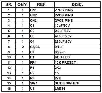

Parts
parts

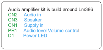

Inputs – Outputs configuration
IO
