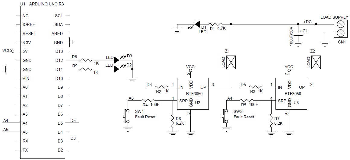

- Arduino Digital pin D3 drives Load-1, and D5 drives Load-2
- BTF3050TE Input PWM < 20Khz or TTL Input (Arduino D3 and D5)
- SW1 and SW2 Resets switch when a Fault condition occurs
- Over-temperature shutdown with auto-restart
- Active clamp over voltage protection of the output
- Enhanced short circuit protection
- 2 additional LEDs On Arduino D11 and D12 provided for operation indication.

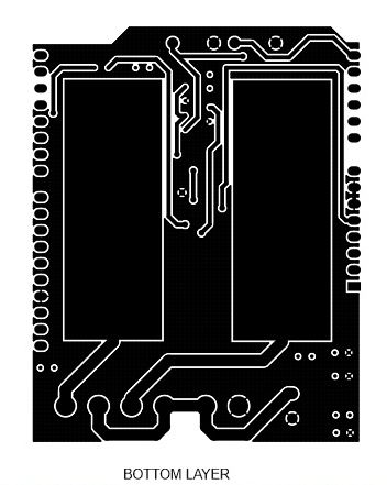

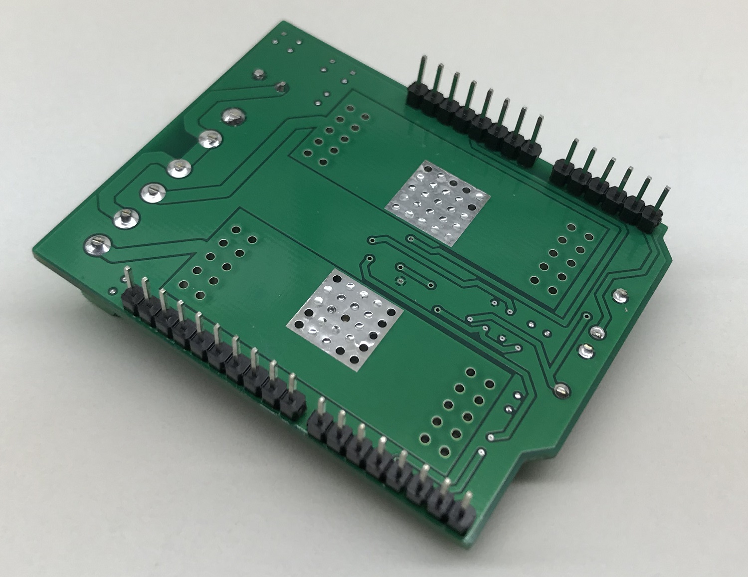

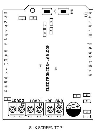

- PCB dimensions: 61.91 x 50.64 mm
Testing the board
Arduino Example Code Provided to test the board at the end of the article.

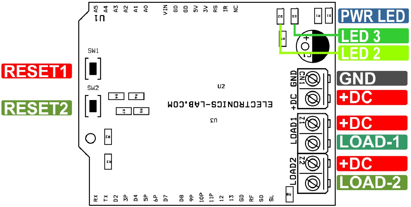

Connect the load at Z1 (Load1) and Z2 connector, Connect the load power supply at CN1, Upload the Arduino code to Arduino UNO, mount the shield on Arduino Uno. Each load will be ON for 1 Second sequentially, at the same time LED D2 and D3 will indicate the operation ON/OFF. Code is determined with ON/OFF operation of loads. Users can write their own code to use PWM and Fault functions.

Schematic

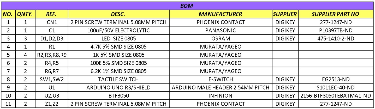

Parts List
| NO. | QNTY. | REF. | DESC. | MANUFACTURER | SUPPLIER | SUPPLIER PART NO |
| 1 | 1 | CN1 | 2 PIN SCREW TERMINAL 5.08MM PITCH | PHOENIX CONTACT | DIGIKEY | 277-1247-ND |
| 2 | 1 | C1 | 100uF/50V ELECTROLYTIC | PANASONIC | DIGIKEY | P10397TB-ND |
| 3 | 3 | D1,D2,D3 | LED SIZE 0805 | OSRAM | DIGIKEY | 475-1410-2-ND |
| 4 | 1 | R1 | 4.7K 5% SMD SIZE 0805 | MURATA/YAGEO | ||
| 5 | 4 | R2,R3,R8,R9 | 1K 5% SMD SIZE 0805 | MURATA/YAGEO | ||
| 6 | 2 | R4,R5 | 100E 5% SMD SIZE 0805 | MURATA/YAGEO | ||
| 7 | 2 | R6,R7 | 6.2K 1% SMD SIZE 0805 | MURATA/YAGEO | ||
| 8 | 2 | SW1,SW2 | TACTILE SWITCH | E-SWITCH | DIGIKEY | EG2513-ND |
| 9 | 2 | U1 | ARDUINO UNO R3/SHIELD | ARDUINO MALE HEADER 2.54MM PITCH | DIGIKEY | S1011EC-40-ND |
| 10 | 2 | U2,U3 | BTF3050 | INFINION | DIGIKEY | 2156-BTF3050TEBATMA1-ND |
| 11 | 2 | Z1,Z2 | 2 PIN SCREW TERMINAL 5.08MM PITCH | PHOENIX CONTACT | DIGIKEY | 277-1247-ND |
Connections
