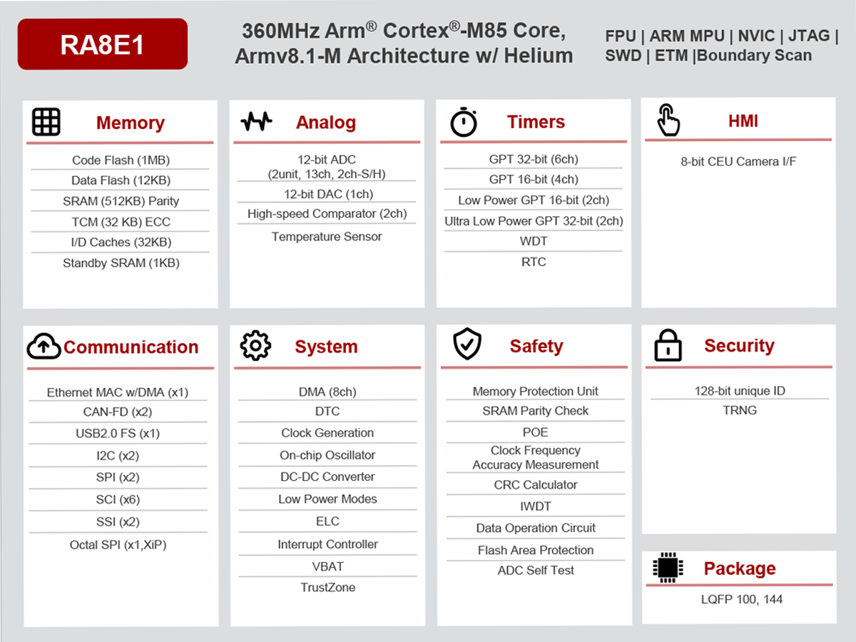

RA8E1 Block Diagram

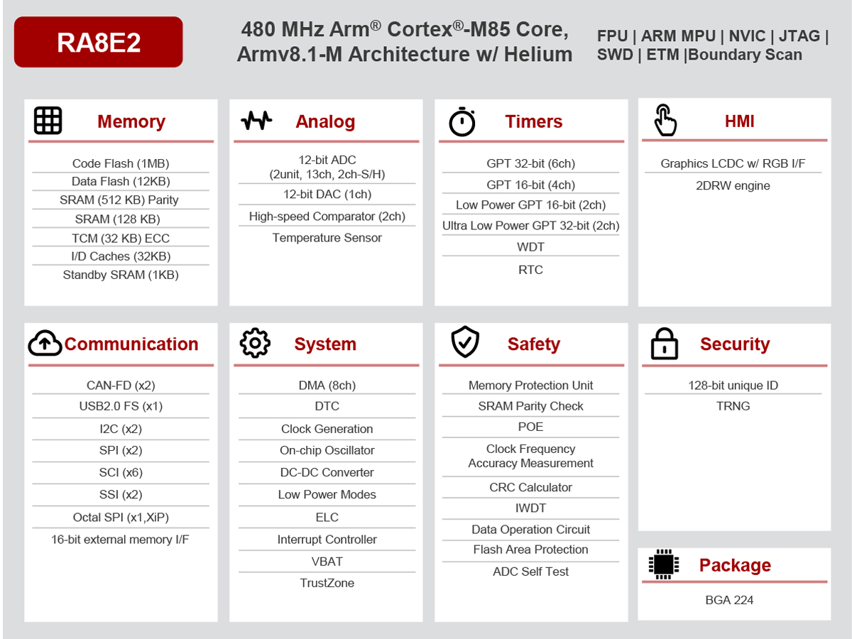

To be Accurate, the RA8E1 runs at 360 MHz, while the RA8E2 runs at 480 MHz Arm Cortex-M85 microcontrollers differ in clock speed, memory options, communication features, and package sizes. The RA8E1 includes an Ethernet MAC and a camera interface, which the RA8E2 lacks. However, the RA8E2 is better suited for HMI applications, offering an RGB LED interface, a 2D drawing engine, and external memory support. Both MCUs provide high performance, advanced memory, and flexible peripherals.

  • MCU Core:
    • ARM Cortex-M85, clocked at 360 MHz for RA8E1 and 480MHz for RA8E2
    • Helium MVE (M-Profile Vector Extension)
    • ARM TrustZone
    • 12KB data flash
  • Memory & Storage:
    • 544KB SRAM (32KB TCM with ECC, 512KB user SRAM with parity protection) for RA8E1
    • 672KB SRAM (including 32KB TCM) for RA8E2
    • 1KB standby SRAM
    • 32KB instruction/data caches
    • 1MB code flash
  • Camera:
    • 8-bit Capture Engine Unit (CEU) interface for RA8E1 only
  • Display interfaces with features for RA8E2:
    • Graphics LCD Controller (GLCDC) supporting up to WXGA resolution (1280×800)
    • 2D Drawing Engine (DRW)

  • Packages:
    • LQFP100 and LQFP144 for RA8E1
    • 224-pin BGA for RA8E2
RA8E1 and RA8E2 Microcontrollers
RA8E2 Block Diagram

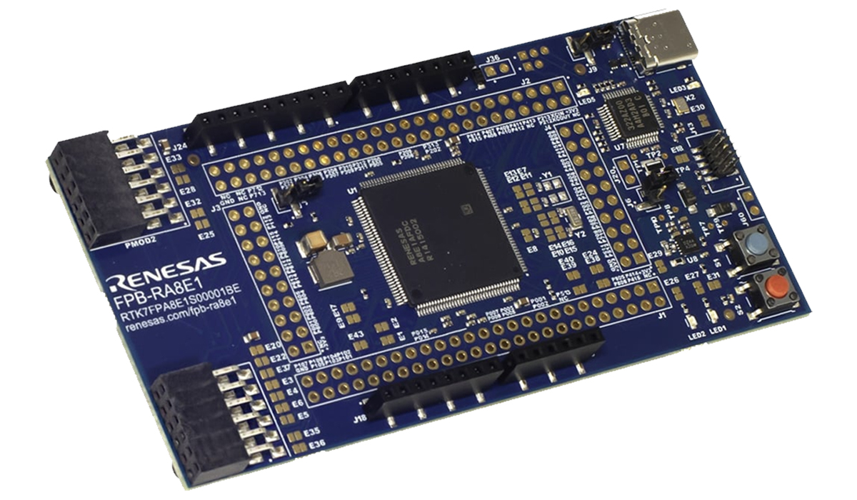

Fast Prototyping Board for Renesas RA8E1
The RA8E1 and RA8E2 Group MCUs are now available, priced at approximately $7.57 and $9.28 per 1000 units, respectively, including the FSP software. Renesas is also offering a Fast Prototyping Board for the RA8E1 at £24.82 i.e. $26.09 (excluding TAX), and plans to release an RA8E2 Evaluation Kit with a TFT Display in early Q1 2025. For more information, visit renesas.com/RA8E1 and renesas.com/RA8E2. Samples and kits can be ordered directly from the Renesas website or through authorized distributors. You can find more details on the product pages and in the press release.
